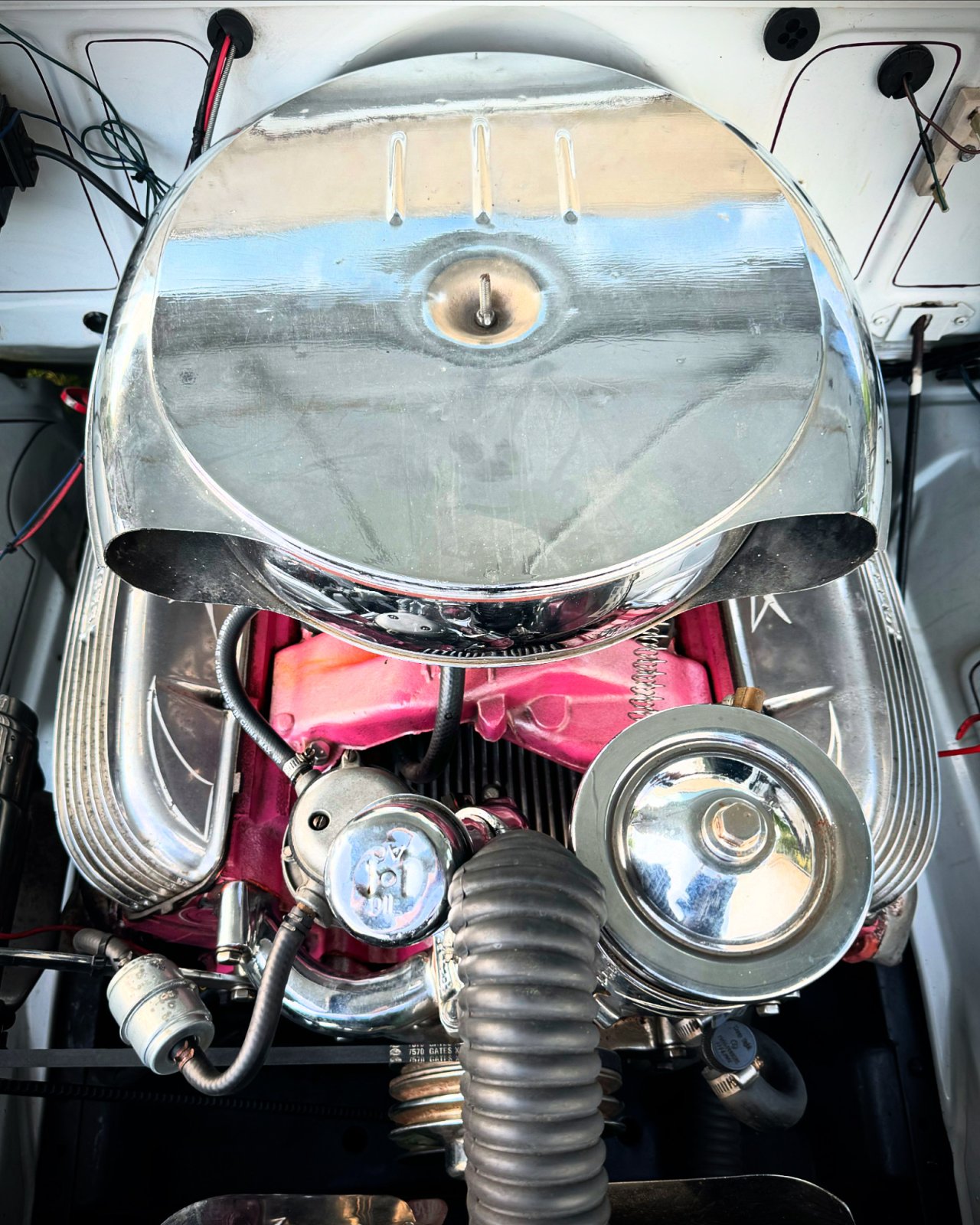

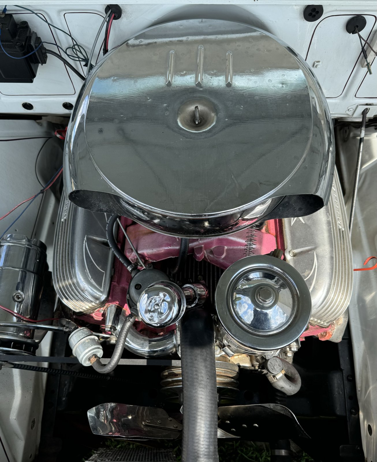

    I’m still running the 1959 Cadillac 390 with the Cadillac trans. Just recently got an old chrome from the 60s batwing air cleaner for it. I was using a louvered gto air cleaner. I got a good quadrajet on there from a pro in place of the carter I ran forever. I will probably end up switching this out for a 4gc from the same pro, just because.

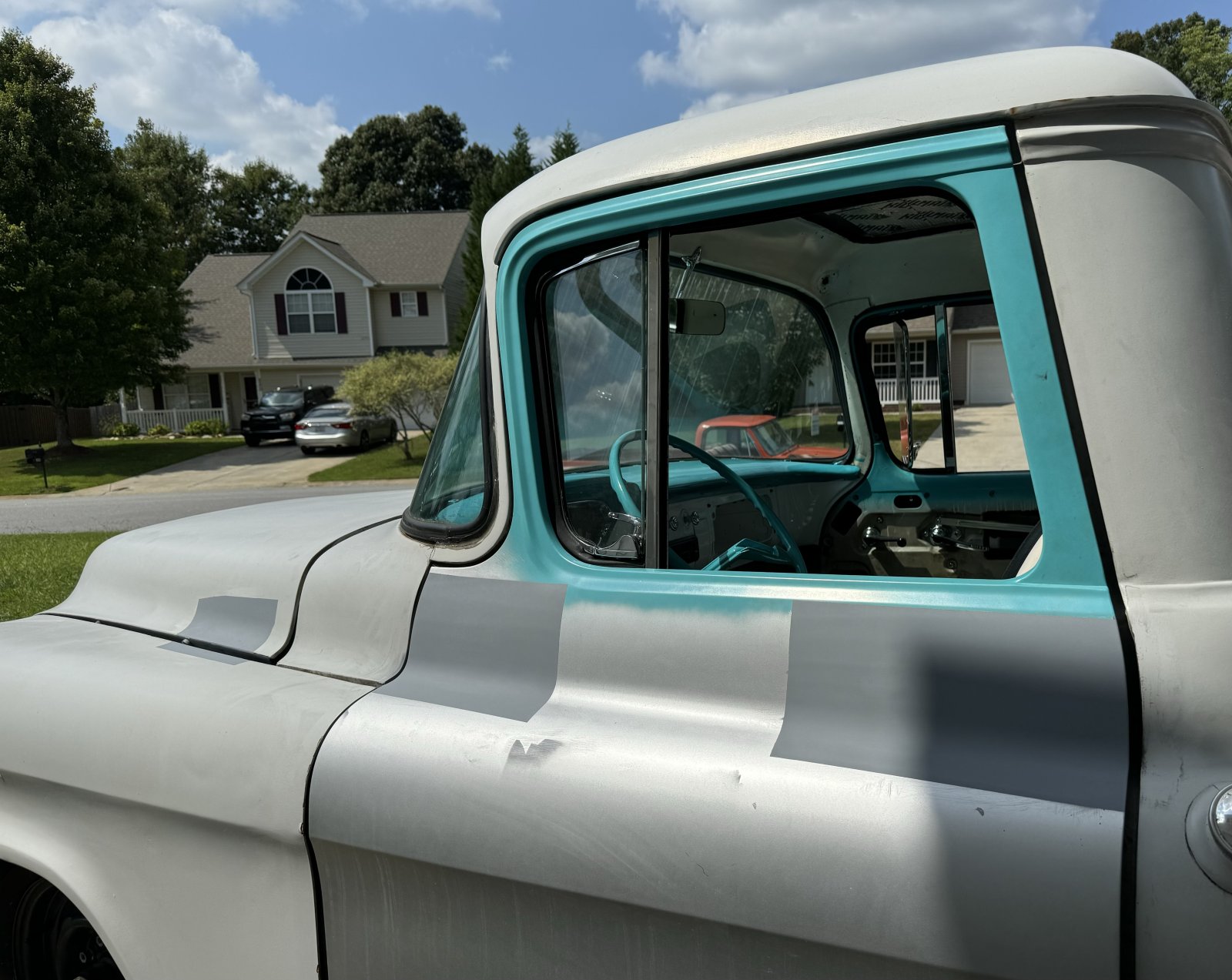

    I had previously (years ago) fixed both doors that had rust in the inner and outer bottoms. But the drivers door had some other issues. The inside panel had been cut up way back when and some tabs were missing that attach the inner upper door trim. I could have spent a long time making a patch panel, but honestly the door was kind of extra beat. So I got a new driver door and then shaved the door handle and mirror mount holes to match the other side.
    I gutted both doors and put all new gl***, vent window ***emblies, window regulators, latches, handles, rollers, hardware, and window felts. Chrome frames around all the gl***. Gl*** run felt was NOS GM.

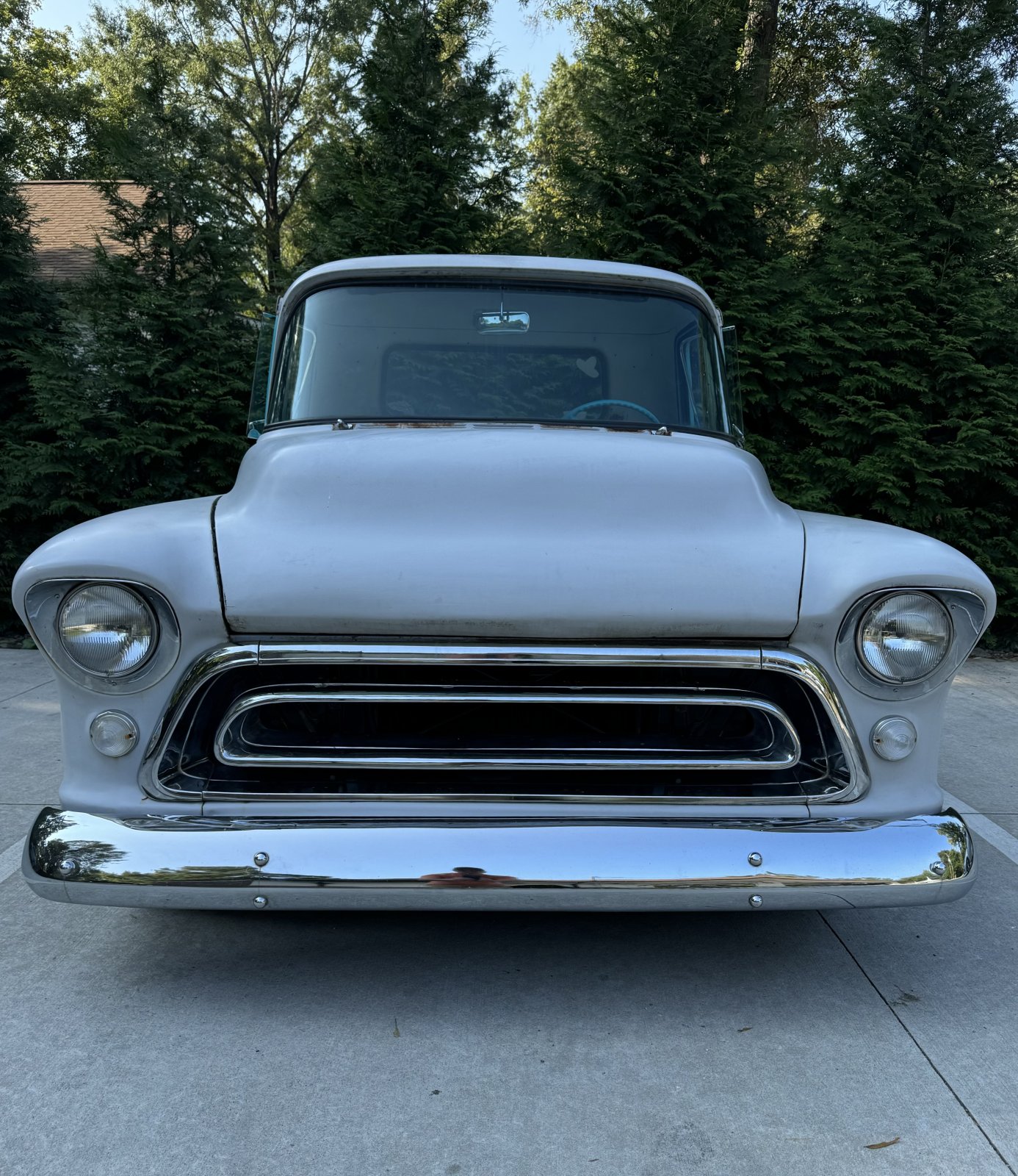

    1108152C-2455-41F8-B869-D37D9D595565.jpeg The truck hasn’t had a tailgate for years. It’s hard to find a decent original so I got a new one with some new chrome chains. This is pretty much the extent of what has gone on on the outside.

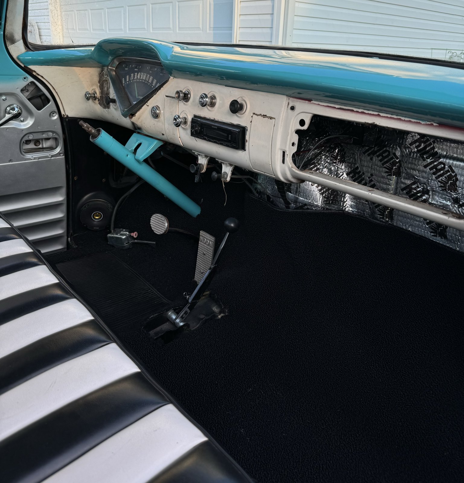

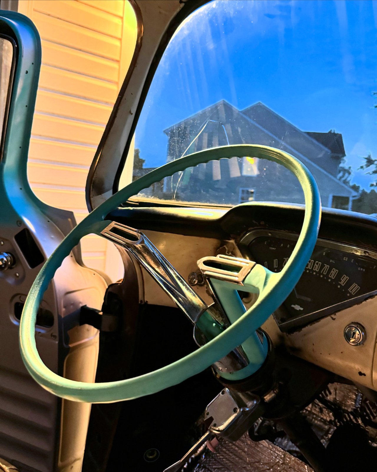

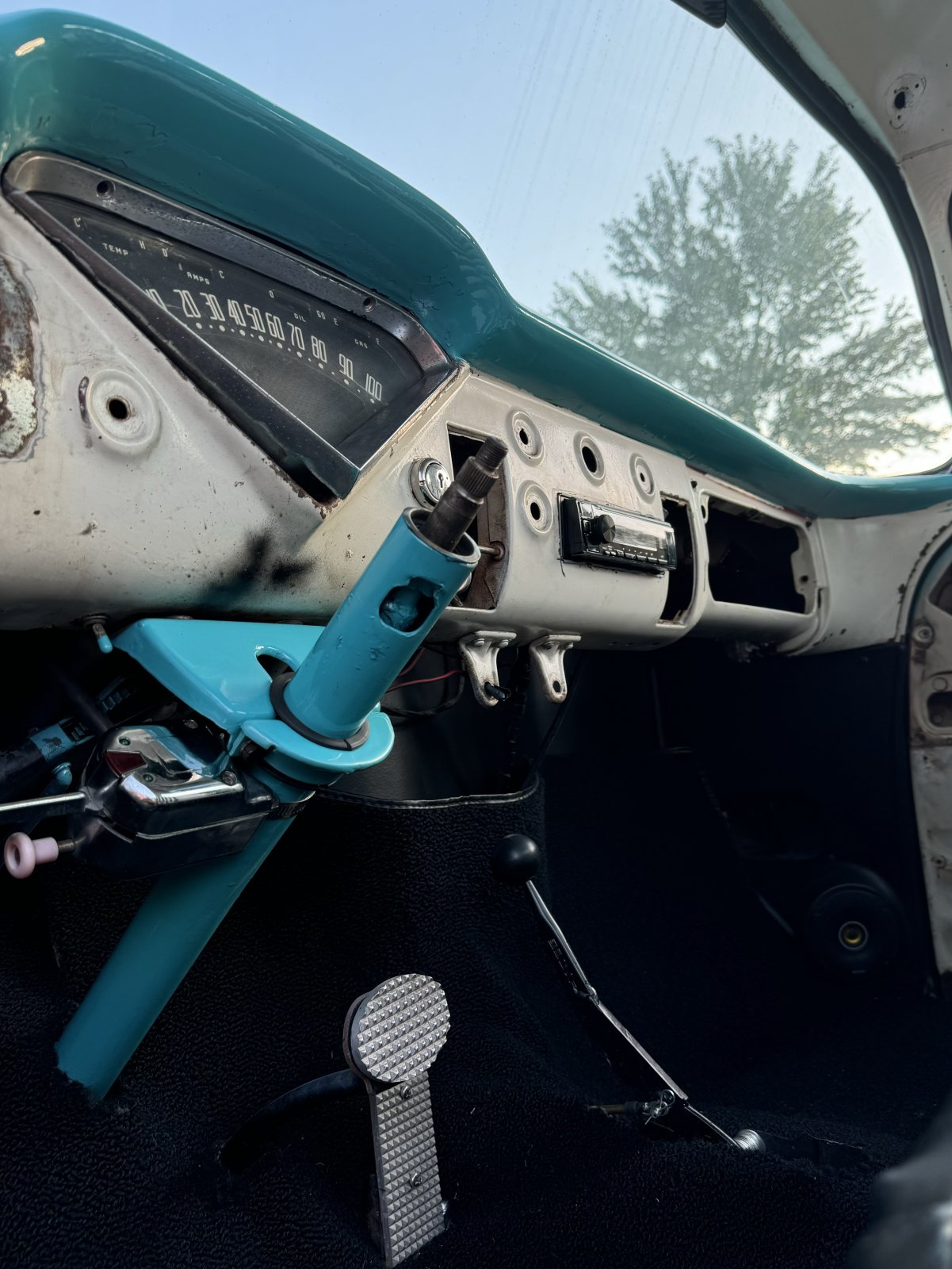

    Biggest changes are in the interior. I added some fresh black carpet (although this will likely change later). New firewall pad for under the dash.
    I sectioned the stock steering column 12” so I could add the 1961 oldsmobile steering wheel.
    I sanded and painted the steering wheel, steering column, and dash top tropical turquoise in single stage. That’s a factory Chevy color from 56-57 bel air.
    Still waiting on the paint to get hard to put the steering wheel back on. And dropping the horn center parts off today for new chrome. 0609FDAC-DEA6-42DE-8C8C-1AF2E5CF5AC7.jpeg IMG_2289.jpeg IMG_2295.jpeg IMG_2303.jpeg IMG_2292.jpeg

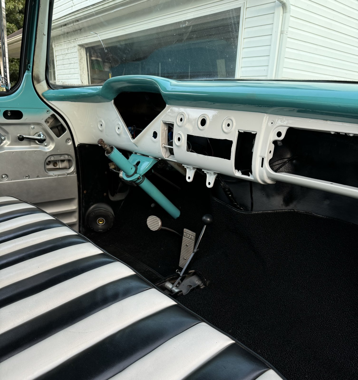

    Dash is empty. Ready to sand and paint. Forgot how much of a pain it is to get these gauge clusters out.
  15. terd ferguson
    Joined: Jun 13, 2008
    Posts: 3,734
    terd ferguson
    Well that was a lot of work. Gotta get some stuff to put the dash back together- new gauge bezel, new floor vent cables, and some new knobs.

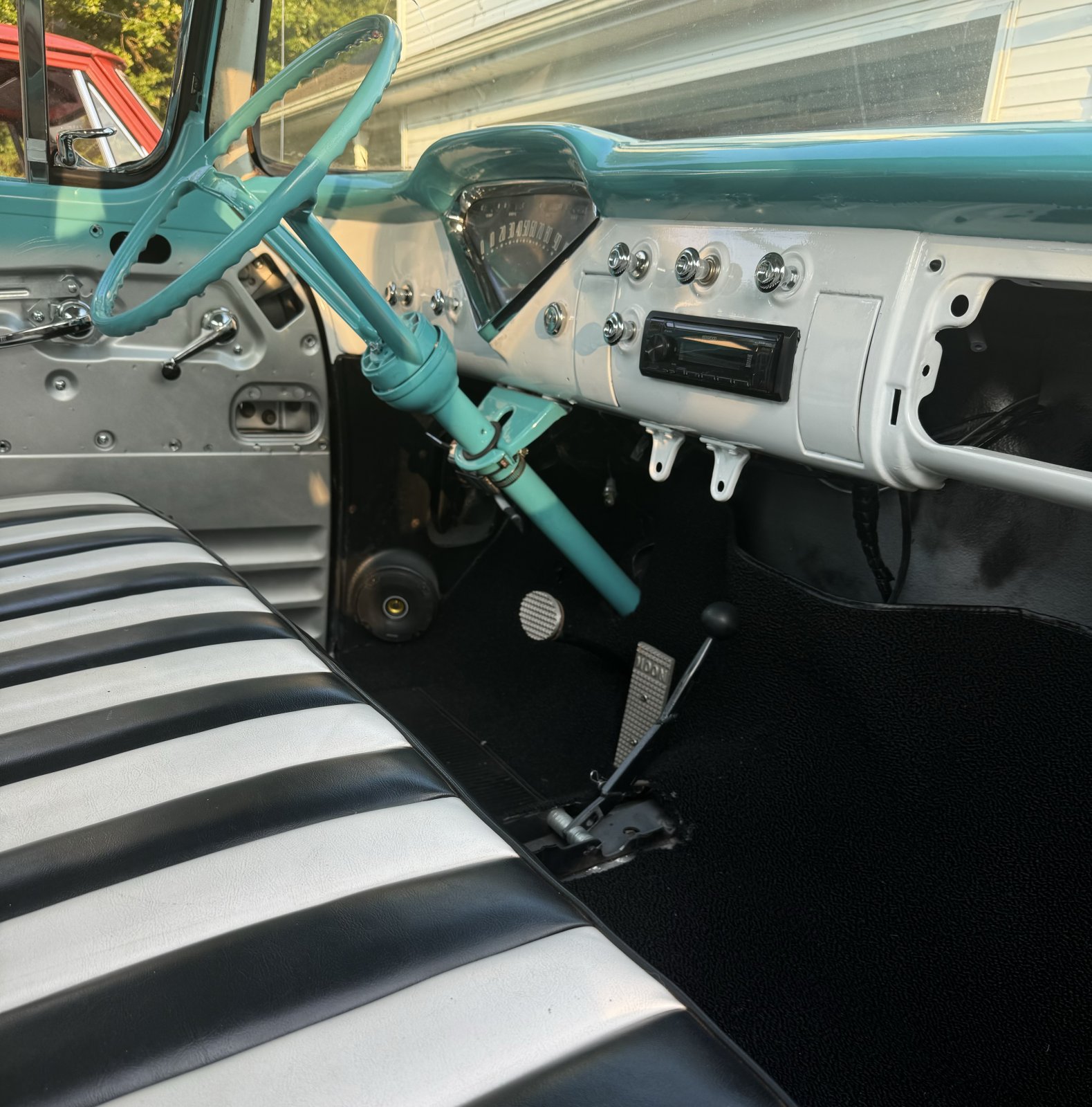

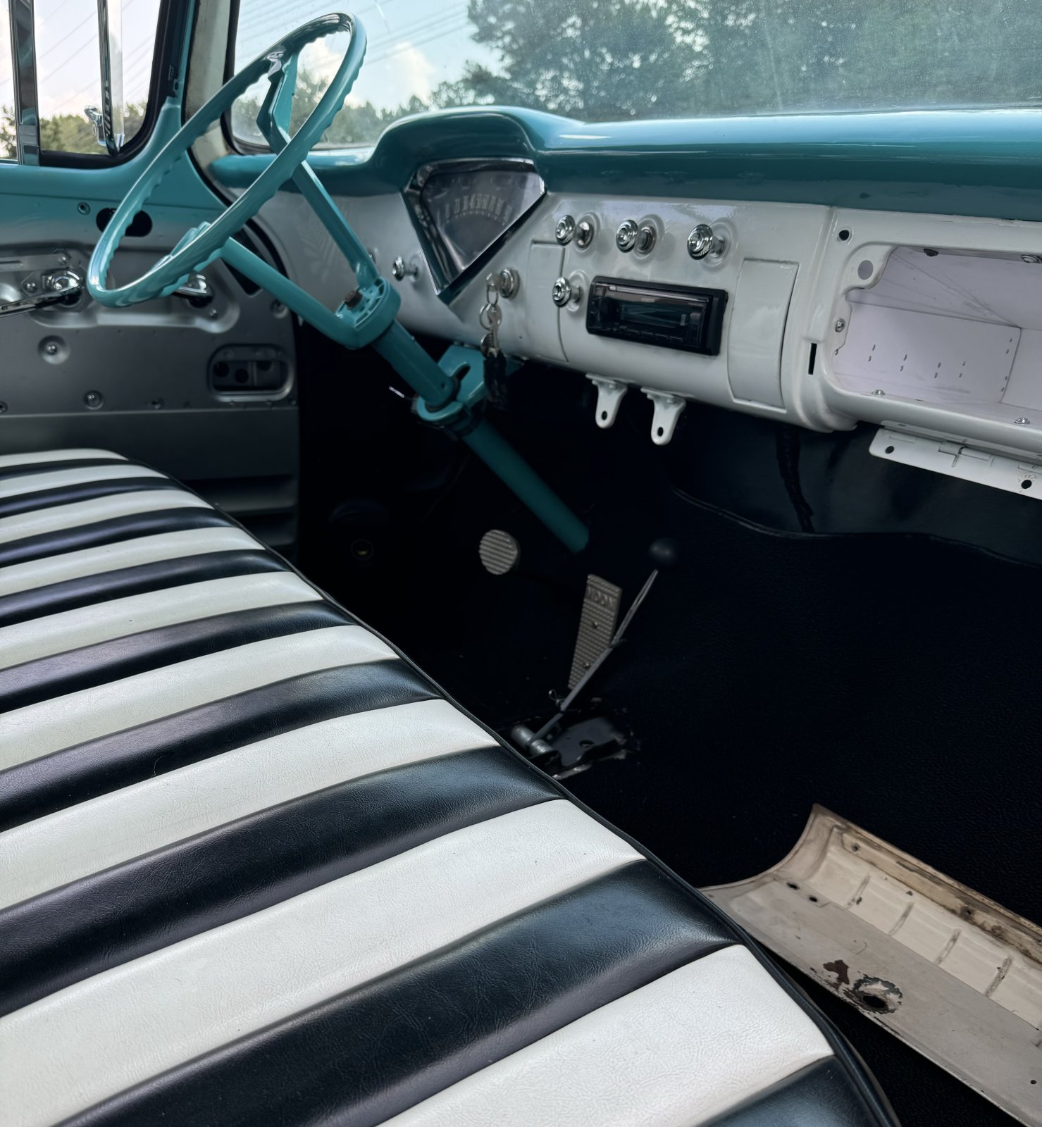

    Got the dash all back together except the speedometer cable. While I had it all apart, I took apart the gauge cluster and cleaned out the speedometer mechanism. You wouldn’t believe the amount of gunk that came out. It had never worked since I got the truck. Spins freely now.
    I am going to have to sand and respray the steering wheel. I did activated single stage in a spray can for the turquoise and the can I used on the steering wheel must not have had the ****on pushed enough to fully release the activator. It’s still sticky a week later. Live and learn. I’ll get that fixed tomorrow.
    Steering wheel chrome parts should be back Friday. I’m going to hand over the glove box door to the chromer when I pick up those steering wheel parts.

    I got the speedometer cable hooked up and the glove box in.
    I also sanded and repainted the steering wheel. So next up is to get the rest of the inside of the cab and doors ready to paint. At some point during that operation, the windshield and rear window are coming out. The windshield is cracked and the rear window rubber needs replaced. And there’s a few small things to do maintenance wise.

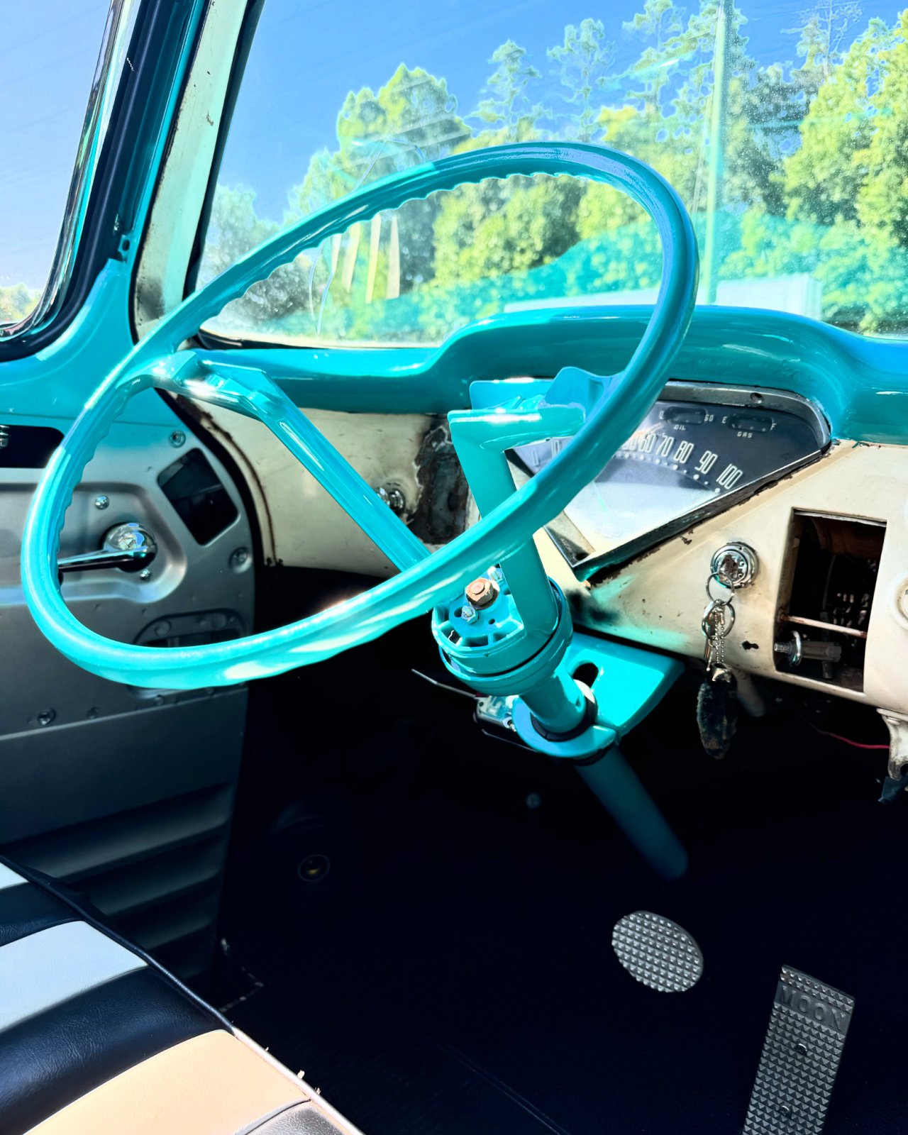

    Two small issues with the dash redo to work out. The speedometer isn’t working. I unhooked the cable and it spins as the truck is moving. The speedometer spins by hand freely and works the needle. I hope the square hole where the cable goes in isn’t wallowed out from the speedometer being stuck for so long. But maybe the cable wasn’t seated properly, I’ll hook it back up and find out. But I’m not eager to take the cluster back out to replace the speedometer. Also, the turn signal indicators aren’t flashing, they light up constant when the headlights are on. So maybe I got the sockets in the wrong holes.
