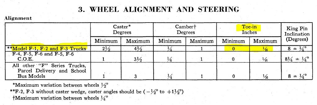

  2. greybeard360
    Joined: Feb 28, 2008
    Posts: 2,098
    greybeard360
  3. winr
    Joined: Jan 10, 2008
    Posts: 296
    winr
    from Texas
    Thanks gr360 !
    I have an F1 axle, looks like it has an 8 degree inclination with a smaller king pin
    Ricky.

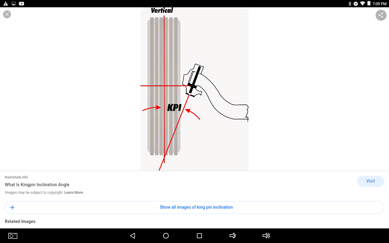

    F23CBD1F-7AB9-4FA4-B8CF-71559BCFFE8C.jpeg The OP’s question is related to camber, not caster.

    Here ya go

  11. X38
    Joined: Feb 27, 2005
    Posts: 17,498
    X38
    Sorry man, but no. Caster is how much the king pin/axle leans back or forward.
    KPI is related to camber, it is the king pin inclination as viewed from the front. @2OLD2FAST provided a diagram. It was IFS, but the principal is the same.

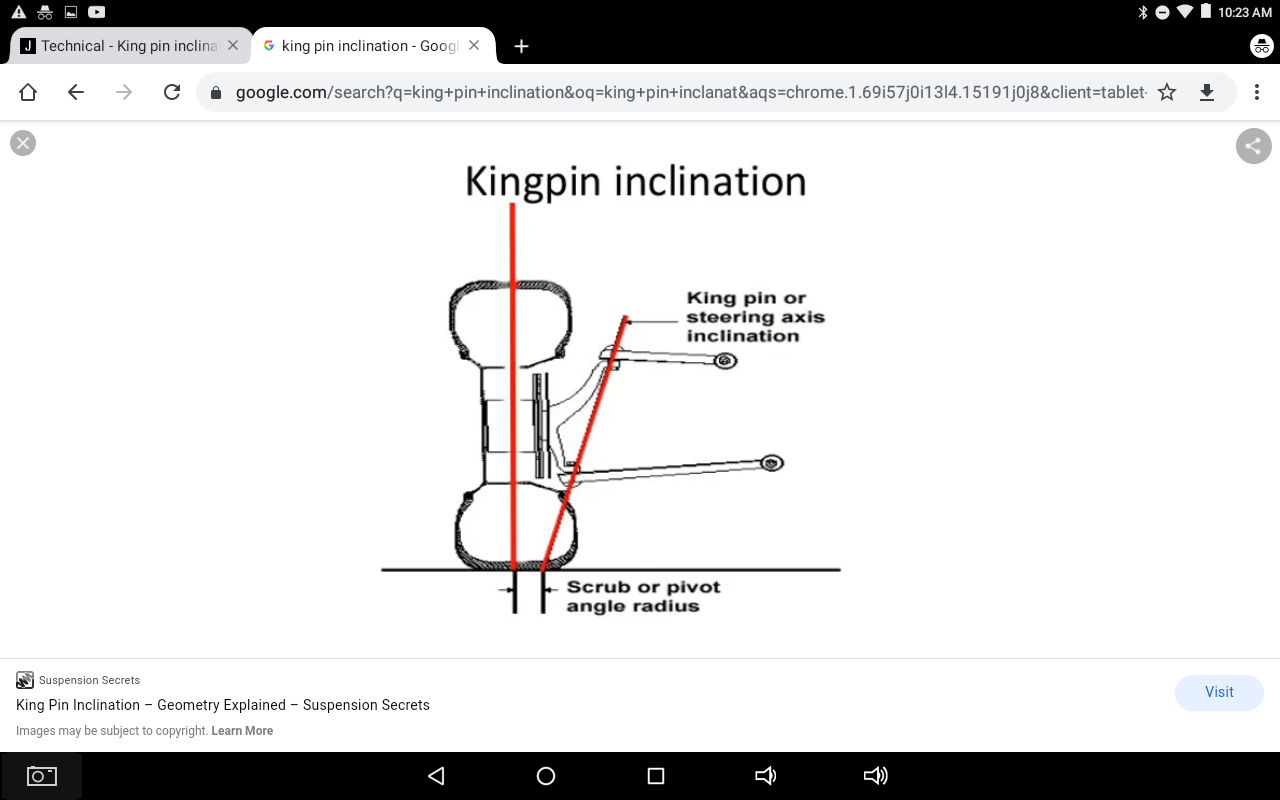

  12. 2OLD2FAST
    Joined: Feb 3, 2010
    Posts: 6,062
    2OLD2FAST
    from illinois
    Is this a bit easier to understand ?

    The info I put up there was from another forum for these trucks. Looks like I found bad info!! I looked in one of my old shop manuals but that info wasn't there.
