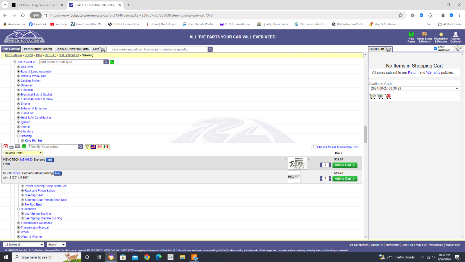

  8. Mr48chev
    Joined: Dec 28, 2007
    Posts: 35,841
    Mr48chev
    Rare parts is a brand that is sold through the likes of O'Reilly's I've seen the name pop up in listings from parts houses where the part is about 300% higher priced than it should be.
    I'd check Rock Auto if you haven't already done so.
    It helps if if you tell folks exactly what king pin you are looking for though.
    If it is your 46 Rock Auto shows t. They put king pins in steering rather than suspension though. Moog 8350B king pin set .
    Amazon shows them for 52.58 if you have prime https://www.amazon.com/Moog-8350B-King-Pin-Set/dp/B000HQ0Q4C Screenshot (862).png
