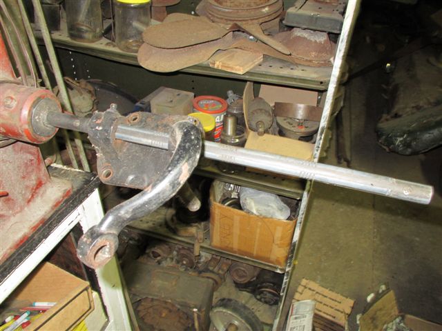

    One of the techs at the local Caterpillar dealer told me a trick, I was having a problem with a slight misalignment of one of the two bushings (very tight in both holes but nice in either side individually) yes I know that sounds dirty. Basically put the pin in the spindle and take your hammer and wack the pin in the center section (the area that would normally be in the axle) on each side did that a few times straighten that right out . That is all the guy does at his job is front end repair. Well I was working on a big yello school bus but the same principal applies,
    Andy
