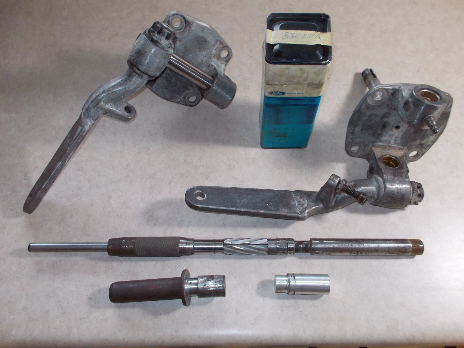

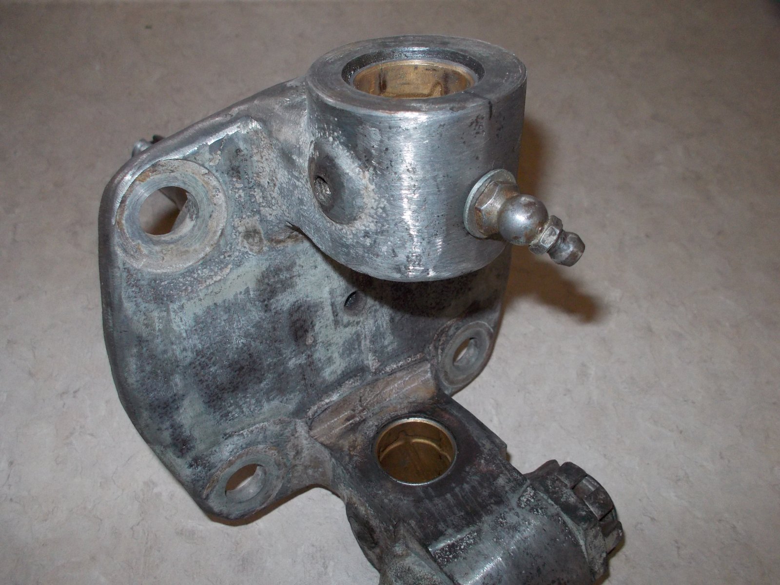

    I haven't used needle bearings, but if you decide to rebuild with standard bushings I may have the tools you need, if you don't already have them. Needless to say, I'm local.
