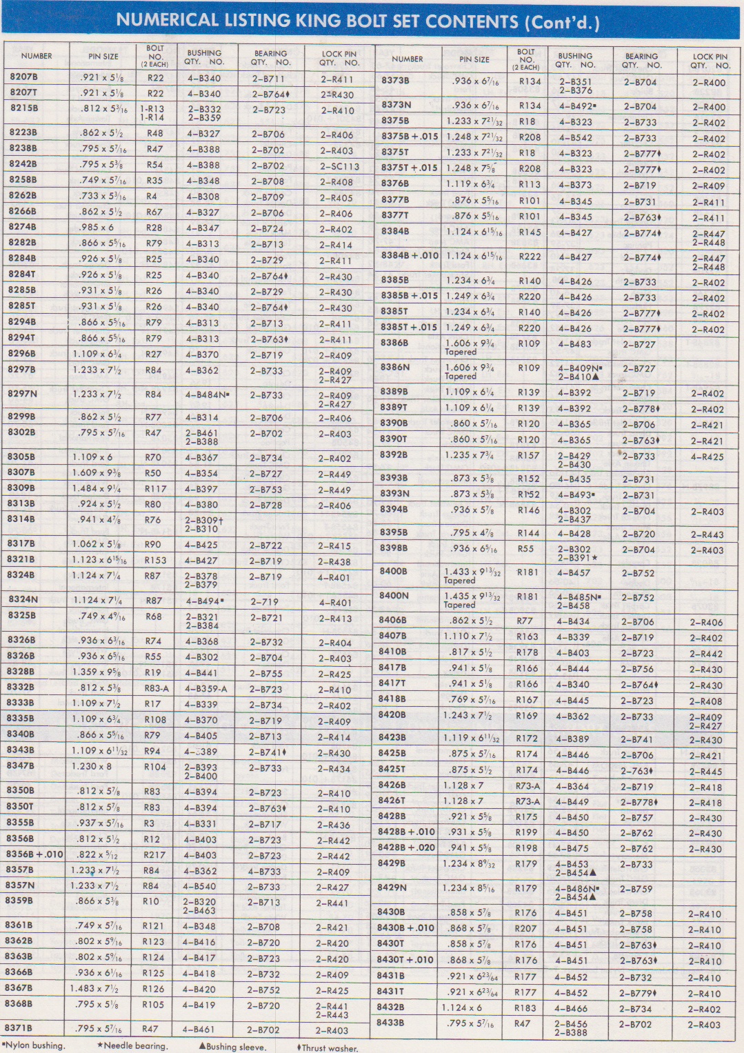

  1. Does anybody know of a listing of kingpins by diameter? I am looking for a set for a 30 Plymouth- they're .750 x 6.25 - and I can't find a listing by make, but I'll bet something else uses that same diameter.

    Get your hands on an old Moog suspension catalog, has just what you need in the back pages.
  3. that list does not included `49-54 chevy car , but Speedway says they are .867
    if i was was you i'd be tempted to make some new kingpins out of 3/4" tool steel drill rod , and then find some oilite bushings that would work.
  4. .....x2 ^,,,,,only make the bushings out of bearing bronze, and groove for grease.

  7. Thanks all, I've considered using some 3/4" precision shafting from Linear Industries, then finding some usable bushings, but then I still need the thrust bearings and the lock pins that I had to drill out - looks like on Squirrel's list that Moog 8470 +010 might work with a little mod. On these early Plymouths, the pin locks into the spindle and the whole pin rotates in the (2) bushings in the axle.
  8. squirrel
    Joined: Sep 23, 2004
    Posts: 58,667
    squirrel
    The 8470 is for an Econoline. The standard size kit is being produced and is readily available, but the oversize seems to be pretty darn scarce.

    I checked my Moog catalog and agree, the 8470B is the only option out of the Moog line. It is a little small on the OD though. It also has funny ends that might be included bin the overall length, which would be a problem for you. Here's a link to a picture of the set . http://www.oreillyauto.com/site/c/d...ck=Search_02856_1335899_-1&pt=02856&ppt=C0106
    If you used the 3/4 ground shaft, it will probably be a few thousandths larger than your stock king pin. This might work to your advantage if the bushing material is thick enough, you can just ream the old bushings to fit the new pin that you make. 20150526_090825.jpg

    OK, Rare Parts can make you a set for $203.06. They only list a 31 Plymouth but the dimensions look right 6.255 length by .746 OD. Here's their picture. Their phone number is 1-800-621-2005. Their part number is 30106. Here's a link to Rare Parts photo of their set. http://shop.rareparts.com/smtp/shopdisplayproducts.asp?tksearch=Yes

    It might be more productive to think about fitting the spindles and axle to a large diameter but far more common king pin set.
    If you had the spindles bored to fit lets say the later Dodge 1/2 ton king pin set and the axle bored to fit the bushings you should be good to go and the next time around who ever redid the king pins would only have to grind the notches in the pins for the bolts and fit the bushings. No hunting around or having to have special pieces made at another added cost.
