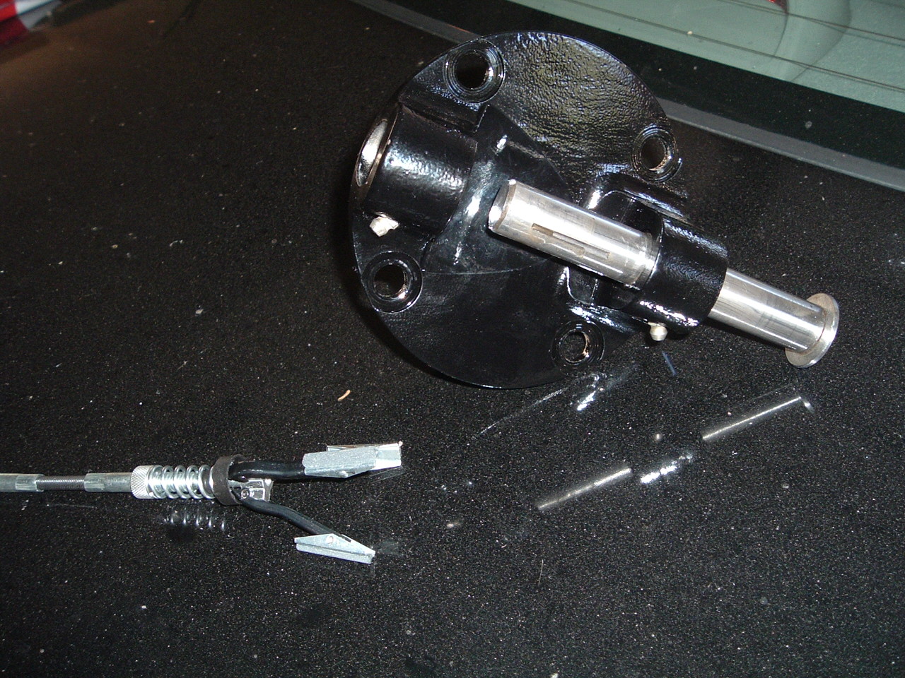

    I use these to tune up holes (3/4 for king holes)
    When you knock the pin in and out of the hole you can see were its tight (makes a shiny spot) grind accordingly there only …. keep a big brass punch to hit it with.

  14. See pic below- Freezer might get them in.but when K-pin warms up and expands,then what? Just get a hone-Ball type or stones,some lubricant,and hone to fit. Go Slow! Hone to fit. Not everything is a slip to fit,your gonna have to fit each side yourself.Ask any machinist. Good luck.
