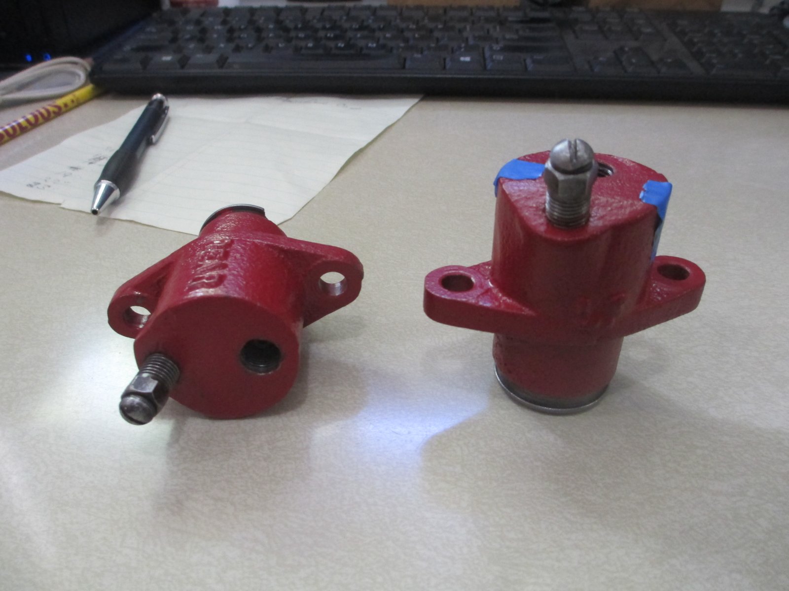

    Looking for a source for wheel cylinders for Kinmonts. IMG_0394.JPG IMG_0395.JPG

    Pete Eastwood may have a recommendation.
  3. Those look like something that could be made unless authentic appearance is real issue.

    Can be made....a machinist in Modesto, CA. made these several years back but sold his shop and retired.

    Look in Hemmings for places that can bore and bush in br*** or SS. Had some done by Apple Hydraulics years ago.

    Well, my friend Tom bought some from Dan Price, I believe, and they wouldn't fit in the Kinmont backing plates without modification to the plates. The reason being the bore sizes were increased, making them physically larger than the originals. So, he is having some cast in December, and will have them machined for a proper fit. I will post the progress here, and there could be some replacements on the market. Meanwhile he is still interested if any are for sale.

    If going the sleeve route, use stainless steel and not br***, if the vehicle will be driven a lot. The br*** wears quickly.

    I had my wheel cylinders stainless steel lined by White Post back east, I believe they are still a monthly advertiser in Hemmings Motor News
