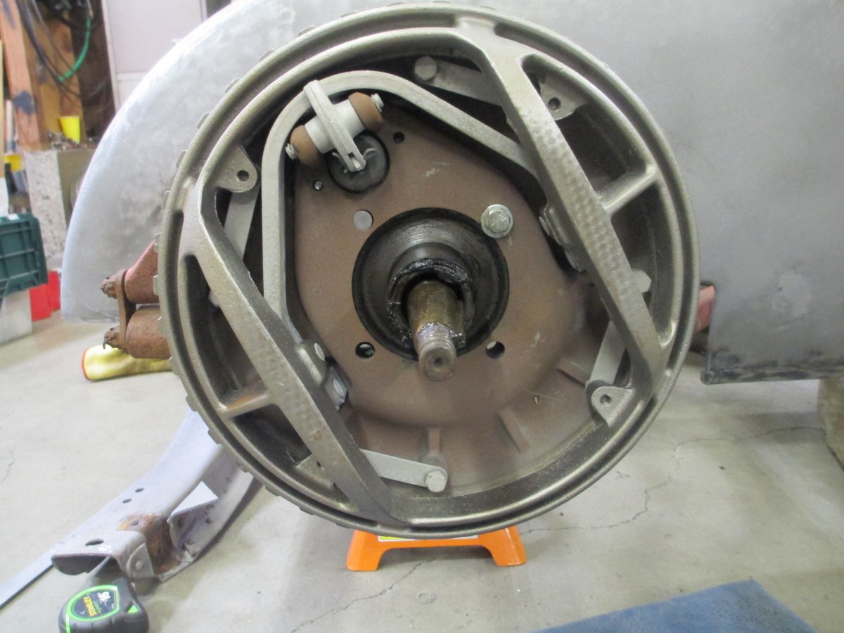

    Sorry, I wrote text but somehow erased it. I’m installing this set on a traditional highboy roadster with a blown flathead. I hd herd of but never seen kinmont a before this project. I’m very excited to be the installer. Not my car but very excited none the less.

    Where is the rotor and pads located?

    The finned backing plate acts as a fixed braking surface and the piece with all the brackets etc acts sort of like a pressure plate. Between them is a ring, about 13”, with friction material on both sides. When the brakes are applied the pressure plate squeezes the ring and it hopefully stops. Like marty said, it’s hard to explain but ingenious when you actually see them.

  14. my understanding is that they work like the clutch in your car. they have a pressure plate, flywheel and a clutch plate. Apply the brakes and the cylinder will compress everything together, akin to releasing the clutch in your car
