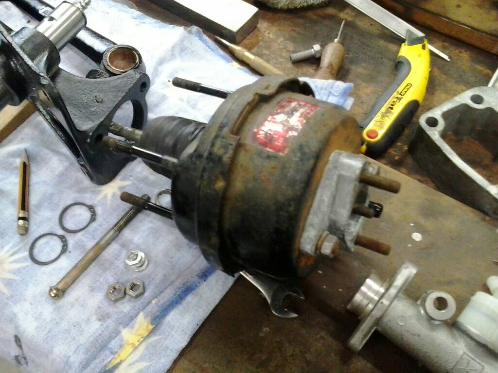

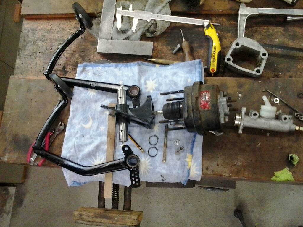

    The brake booster arrived today. I found it on an auction site. Nice small diameter 6" of a Datsun 1600 or US 510 model. It will be easy to mount the brake master onto it then both onto the original pedal and under floor mount.
    I also borrowed a reamer from a workmate to sort out the worn clutch pedal and fit some new bushes.

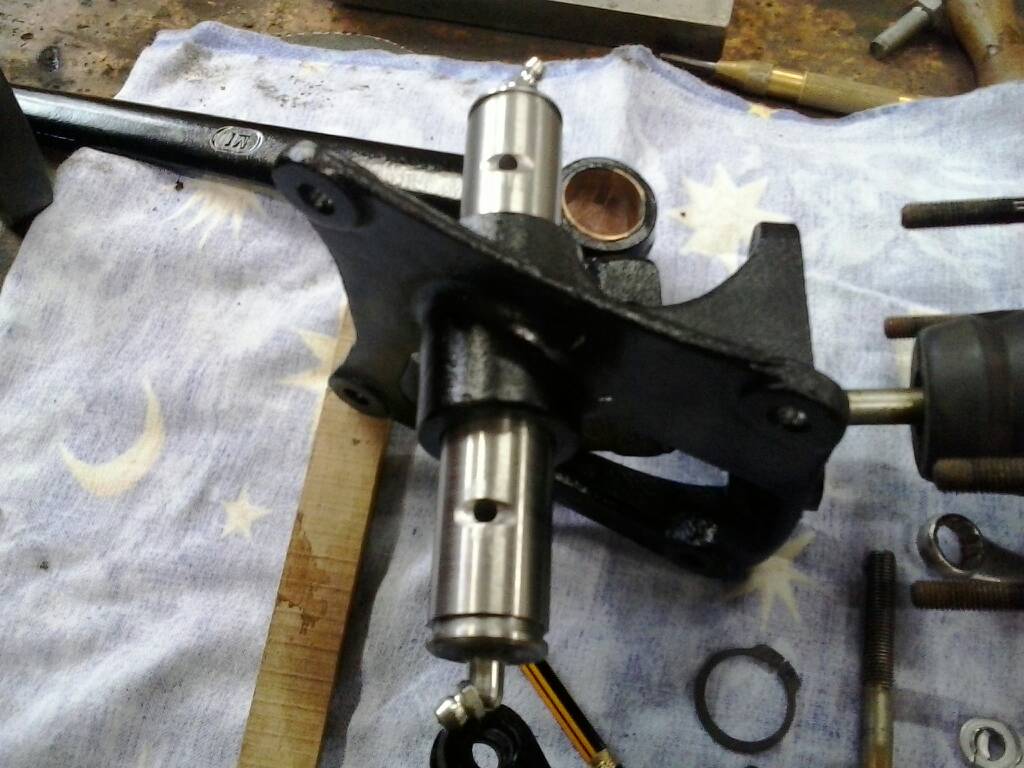

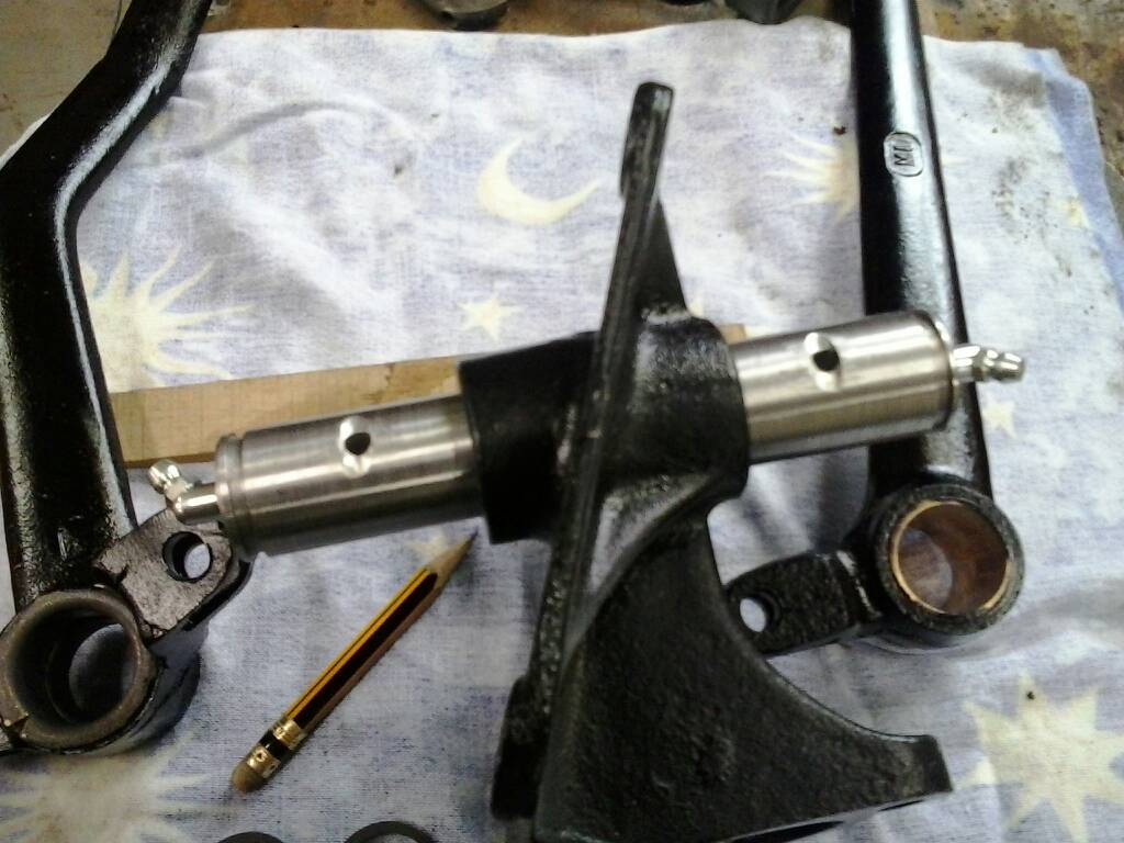

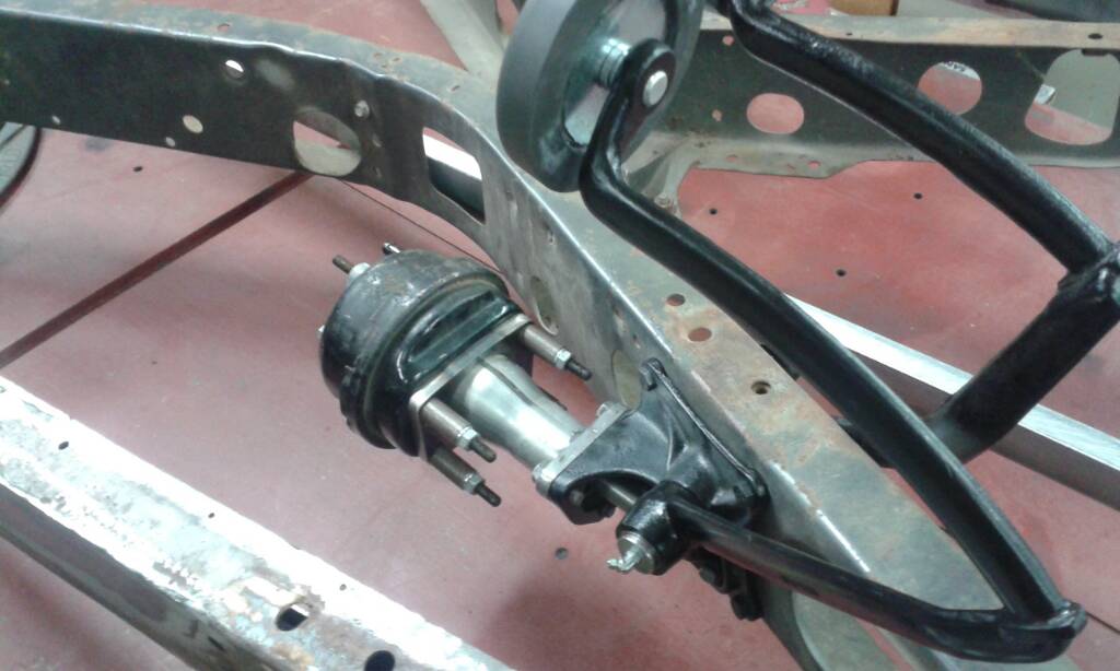

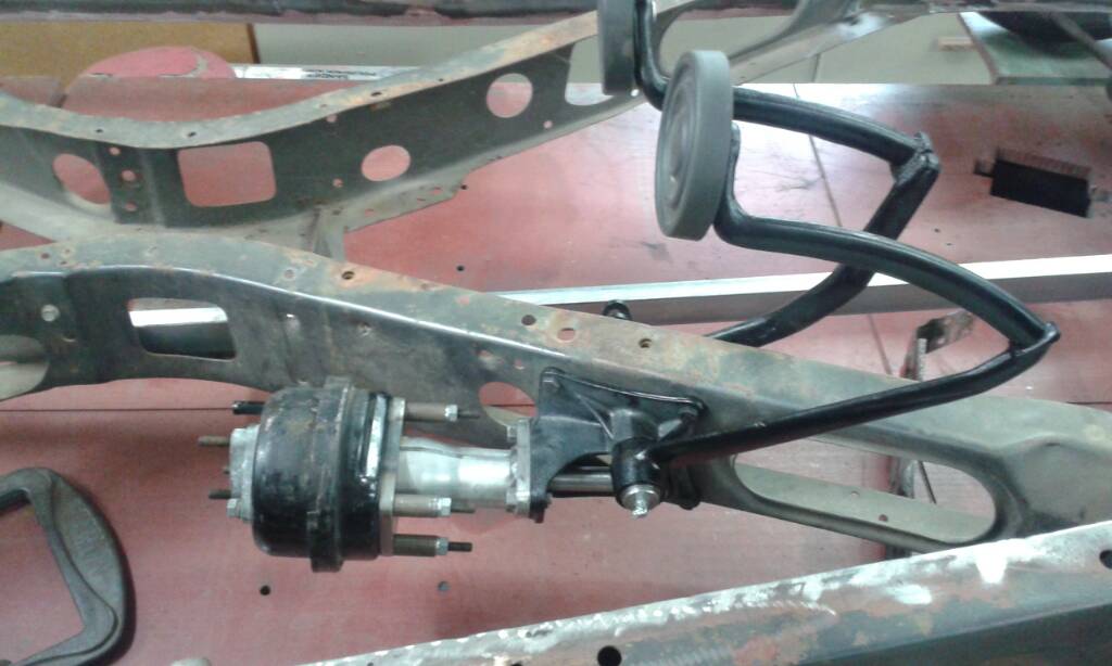

    1413171422697.jpg 1413171442631.jpg 1413171460772.jpg 1413171482257.jpg I spent some time with my boy last week and machined a new shaft for the brake and clutch pedals. I blasted and painted the mount and pedals. Some new pads turned up in the post too.
    I need to order a dual master cylinder for the brakes. I have a single left over from a bad decision on the last car for the clutch.

    I am rebuilding my clutch and brake peddle ***embly this week. I tried using my press to push the old shaft out with no luck. How did you get yours out? I noticed you machined your new shaft for grease zerks. Did your pedals not have grease fittings on them? Or did you just figure that it would be better gerase the bushings through the shaft?

    It can be nerve wracking putting parts like these in the press. I made sure to support the forging carefully and go for gold on the jack handle with safety gl***es on! There are no grease fittings on the pedals, so I drilled the ends of the shaft. Good luck on the press. I had the added difficulty of not having such a big pool of parts if I broke it....being right hand drive!

    Well... I think I will commit to replacing the shaft with the kit I bought; but maybe I will cut off most of the shaft first and drill most of the center out it before pressing. I had a spare pedal unit on my 39 ch***is but traded it for some repairable 39 rear fenders. The original left hand pedal units are rare or popular enough that they are being reproduced now.

    I failed to mention that the shaft I pressed out had one side already cut off (the clutch side), so I pressed into a socket the appropriate size to start off with. After I had established that the shaft was going to move, it was pain sailing and it didn't take too much pressure at all.
    I have since then cut some plates to mount the booster onto the factory mount. A little machining of components will happen this week (and updated pictures too.

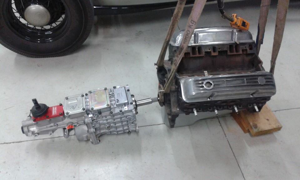

    I put up a call on FB today for an engine block to set up with. I have a 327 organised but getting to it in the guys shed will take a while......in the mean time a friend has loaned me a 400 long block to use for mount location etc.
    I am hoping to sort a bellhousing tomorrow to complete the ensemble. 1723477_821490811246880_5306211735029122477_n.jpg

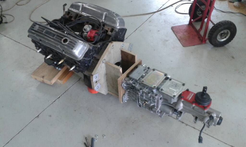

    1419399591543.jpg 1419399611932.jpg 1419399629831.jpg 1419399646951.jpg 1419399664792.jpg When you can't find the bell housing you needed to set up the engine and trans. ........make a stand in to do the job until it turns up.
    This means I can carry on with mounts etc.
