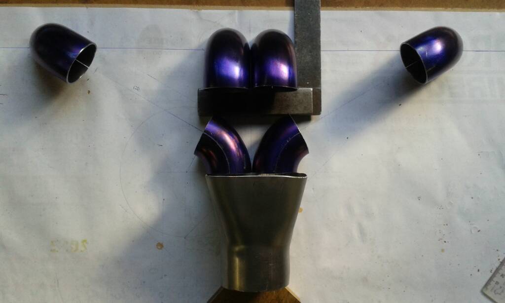

    Out with the marking blue and a hack saw, to make some dust. I drew things out full size using the measurements from the wooden template. carefully marked the donuts and started cutting.
    4 x 90 degree bends and 2 x 60 degree bends. Tomorrow I will cut the sections of pipe needed.

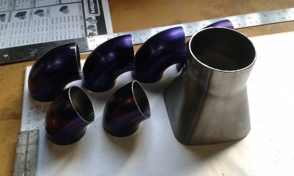

    I went into town and used a cut off saw at my mates shop this morning. It is one of those slow cutters with the HSS steel wheels that cut pretty square. I then went to Dads and faced them all off to the exact lengths required. Anal I know, but I can, so I do!

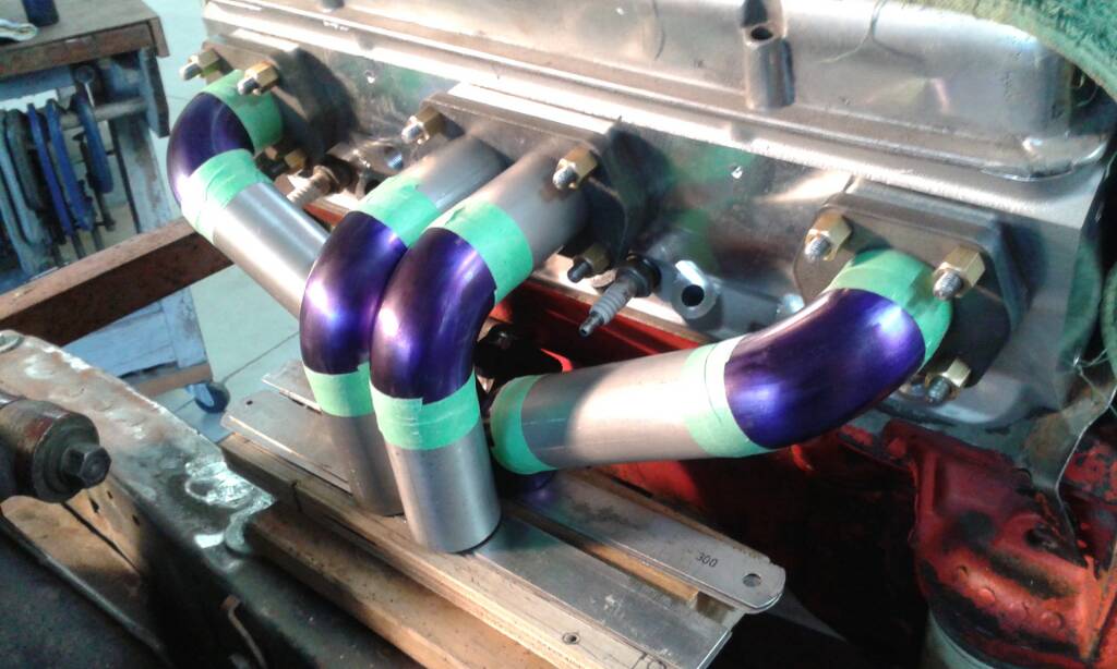

  30. 1430956576774.jpg 1430956591999.jpg 1430956605985.jpg As I mentioned in an earlier post, the exhaust tube I am using is Aluminium coated. I did not want to simply grind the area clean, as this would not remove all traces of aluminium from the weld area. I was scratching my head for a bit.......'What would remove aluminium? Hmmm.........Ahaa! Caustic eats aluminium! The bonus of using caustic (Naoh/ Sodium Hydroxide) is that it will remove the aluminium to a molecular level in the treated area, which means a much cleaner weld!

    These chemicals are available at most pool care places. Caustic is used to Ph balance the water levels.
    Aluminium oxide dissolves in sodium hydroxide solution because it is amphiprotic ( some use amphoteric). This means it can act as a base or an acid. In this case it is acting as an acid and forms sodium aluminate (and releases explosive levels of Hydrogen gas). Soduim hydroxide does not act on the steel under the aluminium oxide layer, but it does go black. I washed the sodium hydroxide residue from the parts with a carbonic acid solution to neutralize and protect the steel from oxidization which starts immediately the parts dry out.
    I put about 1/4" of caustic solution (50% strength) in the bottom of a plastic container. Into this I placed the parts to be treated standing on their ends. It only takes a couple of hours to take care of business and then I swapped the parts to the other ends. as you can see in the pictures all traces of the aluminium coating are gone from the treated areas.
