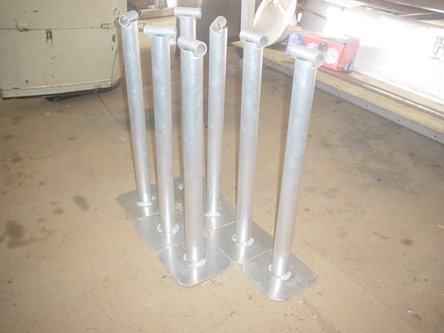

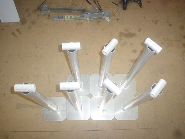

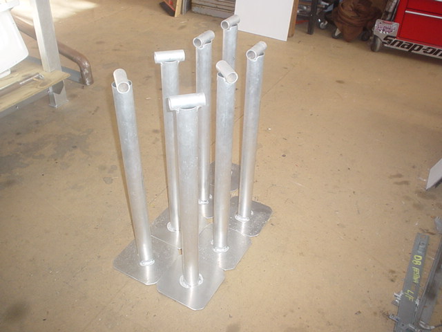

  25. Here's a couple of pics of those bollards Wade. There was 8 but can only find 7. They're 675 high , 180 square at the base , 50 diameter tube with the top tube 32 diamete by 80 long. 4 of them have the top tube set at 45 degrees to the base (for the corners when setting around the car) . They're pretty lite, so shouldn't be to pricey to courier up.
    If ya keen to have them I'll knock up another of the straight ones.
    They do need a bit of a clean up , but I would'nt put any polish near them unless you want to polish all of them , , , they're in a "Raw" state/finish if you know what I mean.
    Shrapnel :cool:
