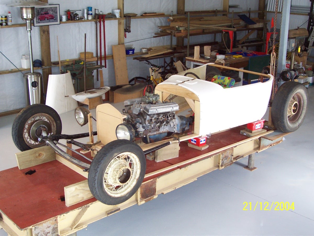

    I found some real early shots of the mock up, on my work computor. Note the wooden chassis and grill suround!
    I also found some pictures of the steering wheel I mentioned earlier. I couldn't up load the version of this from home, but it seems to have worked from here.....go figure!!
