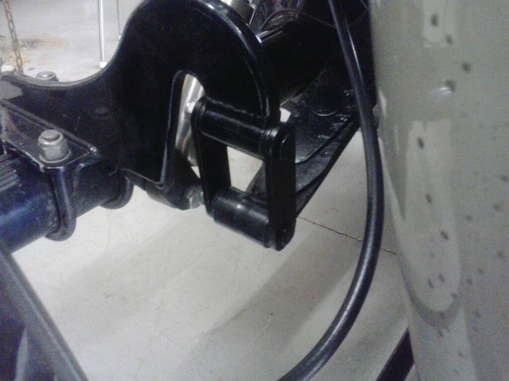

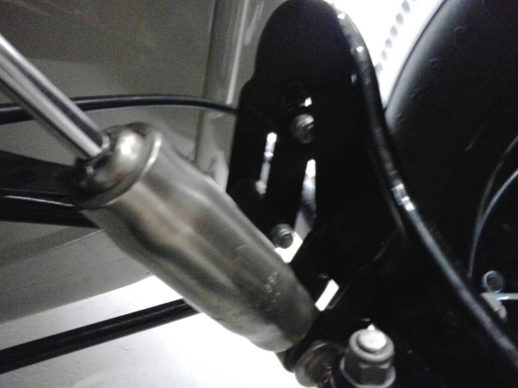

    I have still been having a few issues with the rear suspension bottoming out on bumps, especially with two on board. So tonight I shortened a set of shackles from 125mm to 75mm. These were the originals that I replaced with some others that I made at 90mm. A quick bead blast and some fresh paint, so they will be ready to put on the car by the morning.
    I hope this solves the problem. They only take about an hour to swap out once they are made.
  21. woodbox
    Joined: Jul 11, 2005
    Posts: 1,359
    woodbox
    Short shackles done and fitted. Hopefully this will sort the bottoming out issue!
