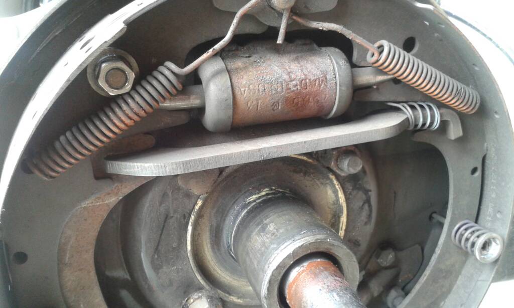

    I took the car for a run today. It was a beautiful day and I felt it would be rude not to! Before I left, whilst rolling it outside I noticed that it was hard to push, even in the shop. Turns out that the right rear brake was grabbing. So I backed off the adjustment a bit and all seemed fine with the world.
    After getting to my destination 1/2 an hour later I checked the drum and it was very hot......Hmmmm.....not good.
    I decided to stop in town on my way home to pick up an axle puller from a mate.......and have a beer.....to let things cool off.
    Once home I pulled the drum and found the source of the issue..........the pads had come off the shoes! It looks like I may have not adjusted the shoes enough and the top of the leading shoe had pushed out and caught on the doubler plate on the backing plate, this had caused the shoe to grab and stick.
    I pulled it all to bits and took the shoes to get some new pads fitted. This time I will get them glued and riveted.
    On the plus side of the ledger, I am happy with the way everything else looks inside, dusty (understandable) but dry, no sign of grease or brake fluid anywhere.
    Lessons learned from this exercise, adjust brakes regularly, especially after breaking in new shoes.
