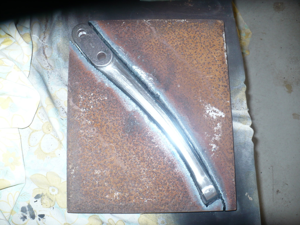

    Love the fabrimacation goin' on here. I've been slowly collecting parts over the last 10 plus years to build a lightweight torsion bar hot rod. Sooo this is very inspirational!
    This, however, may be the coolest pic you've put up.
    It's the perfect visual for the old "I just cut away everything that didn't look like a ______" line.

    Trevor discovered a pinhole in the intake manifold water jacket, so i had Glen weld this up, but in the process he had to weld on a machined surface too. This is no big deal as we have a jig made to hold the manifold in a mill for some previous machining. So that is away with Earl at the machine shop at the bottom of the hill. The manifold is just about the last piece of the engine puzzle too.
