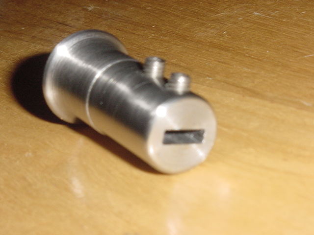

    So I am missing the knob (handle) for the cowl vent on my '47.
    I suppose I could go find the "right" one, but where's the FUN in that!
    Out comes the bar stock, a minute or two on the lathe, few minutes on the mill to add a "keyway", weld in a "key" and I got a pretty good start:

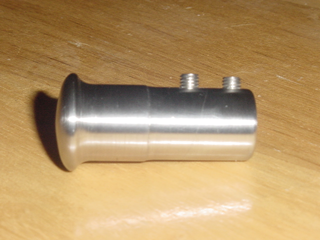

    What you can't see are the two set screws I used to keep the key UP away from the bottom of my slot. Next back to the lathe and it's nearly done:
    Should hold better than the (I ***ume plastic stocker).

    Nice and clean, simple yet subtle. I had the one in my 46 Olds re-popped when he did the window regulators and ashtray ****ons
  3. Nice 'trick' with the keyway!!

    OK so I definitely still need to find the right color - this was as close as I had laying around - not so good - I'll do better. In the meantime it feels pretty good! DSC00069.JPG
