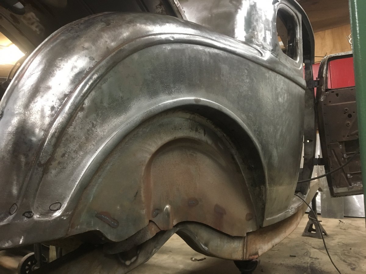

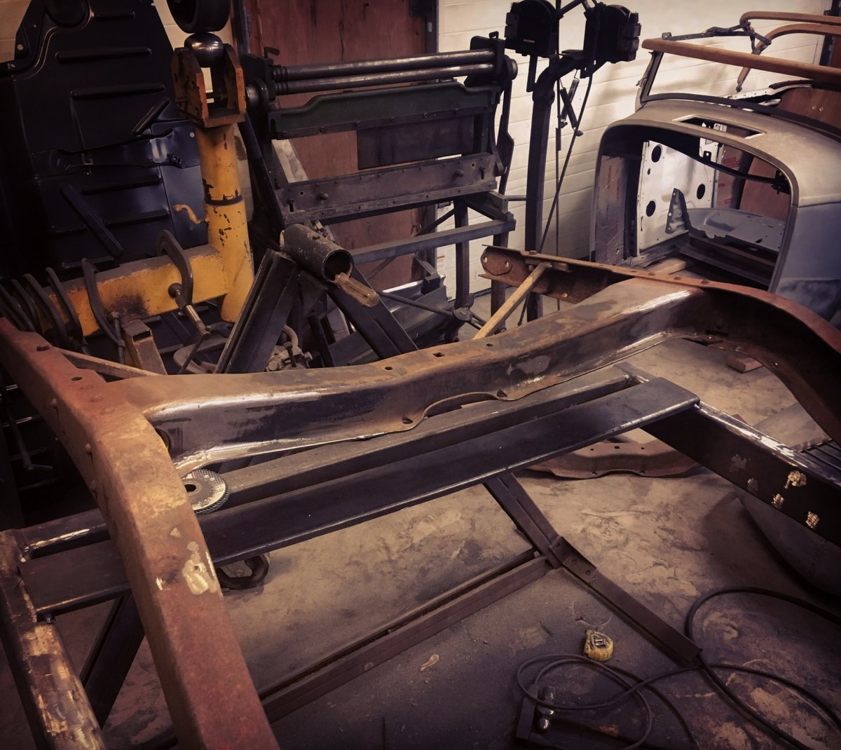

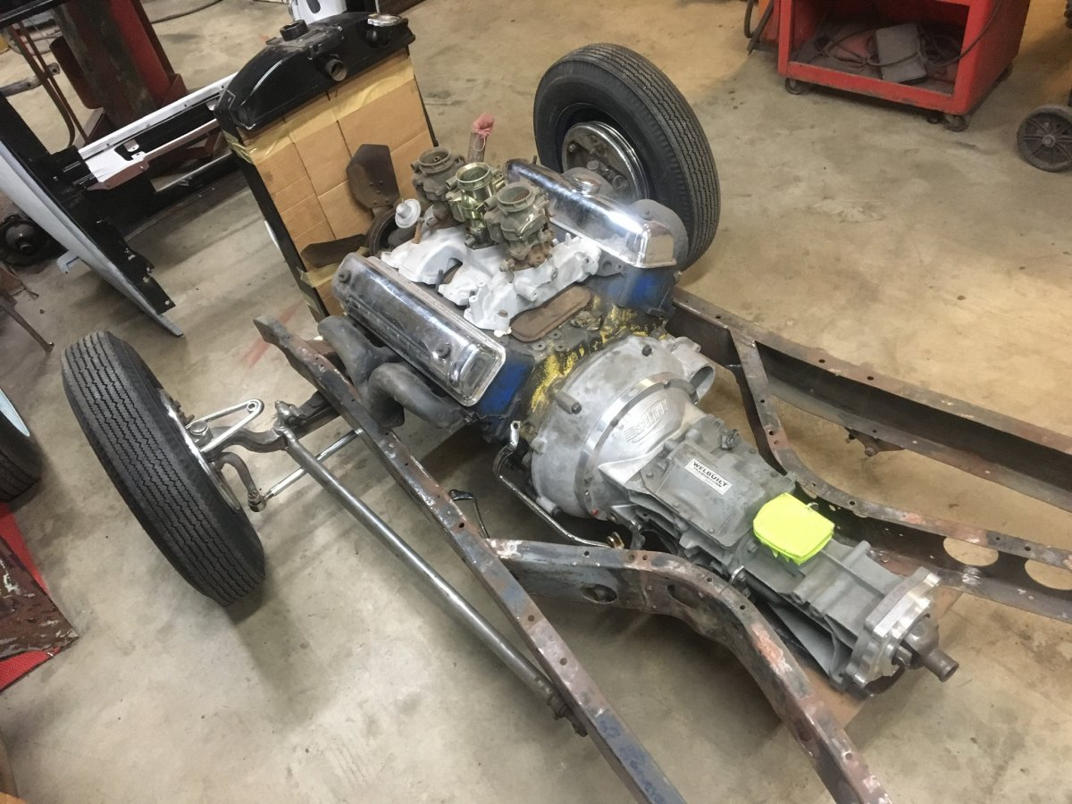

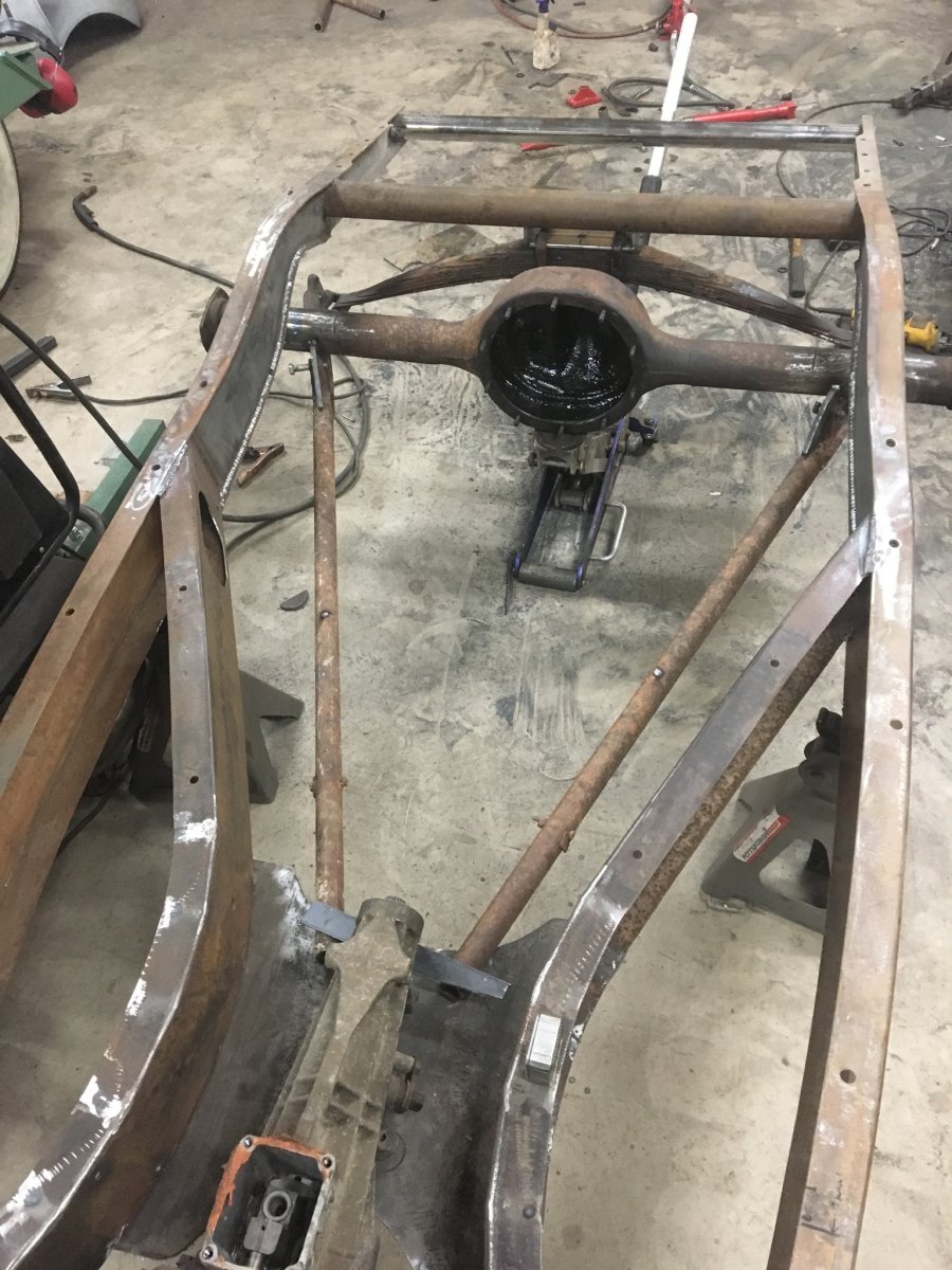

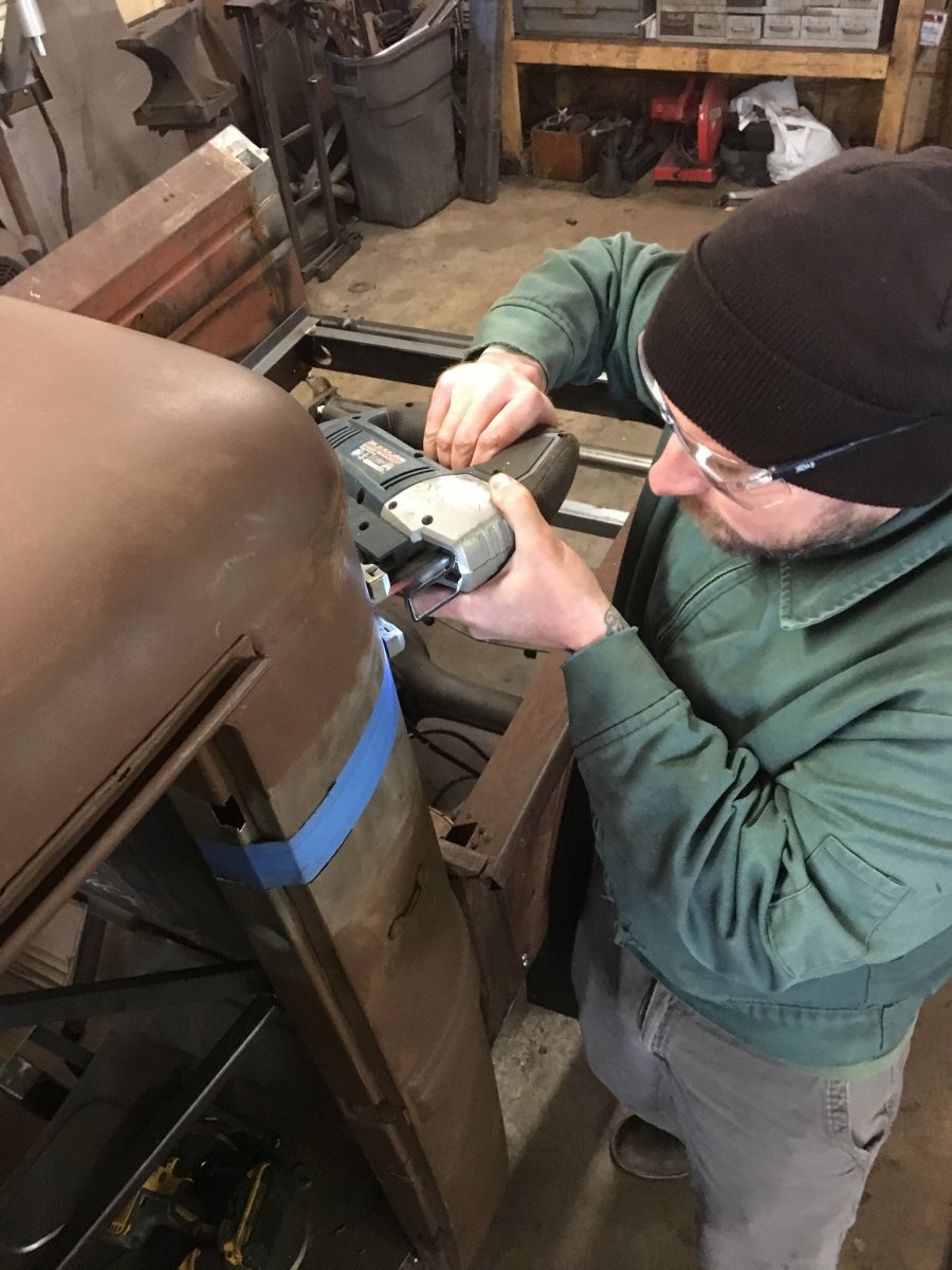

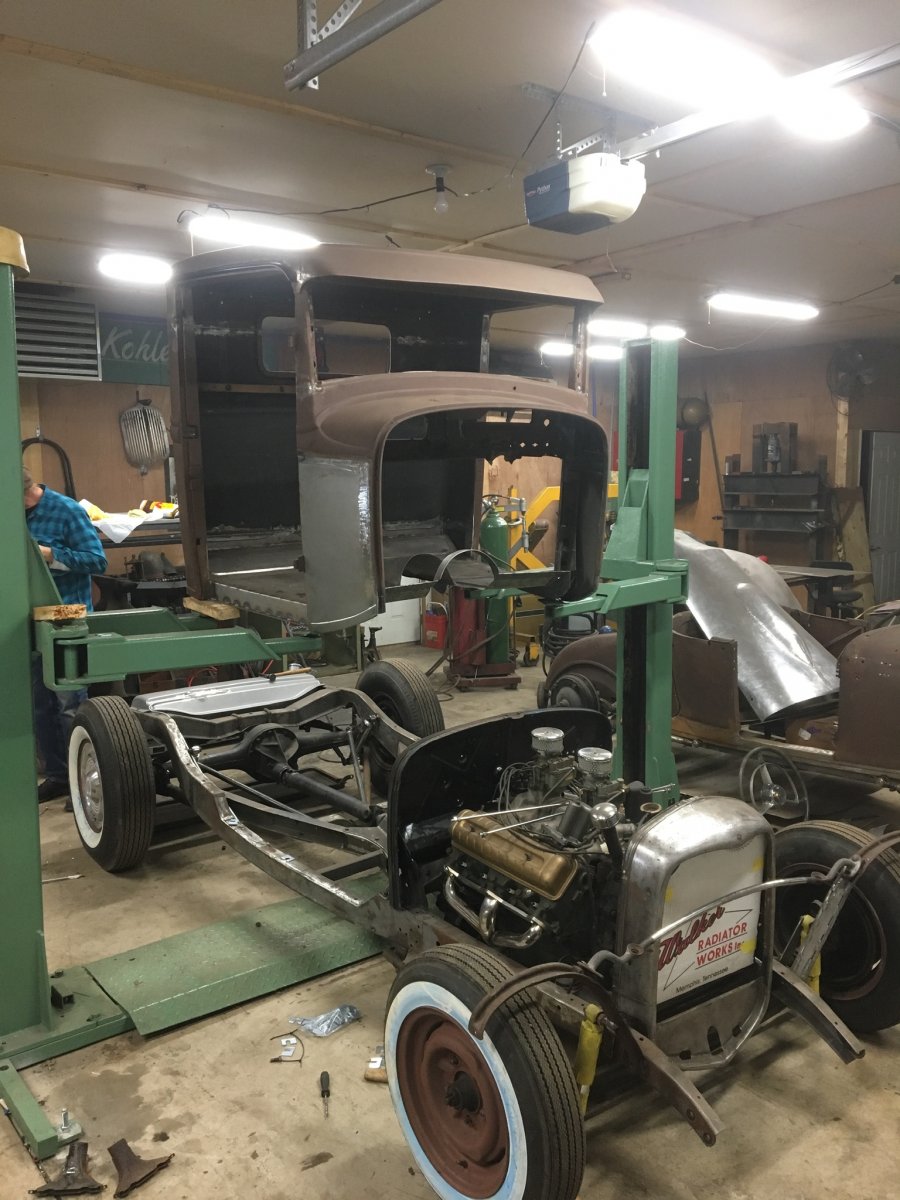

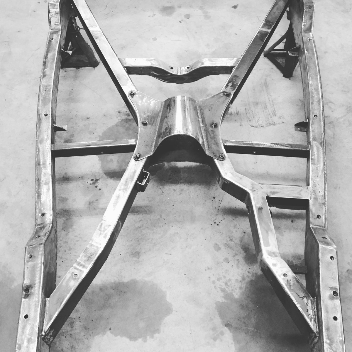

    My pal pats 33 3w we’re working on... gonna be a bad***, hard chopped, y block powered hot rod!

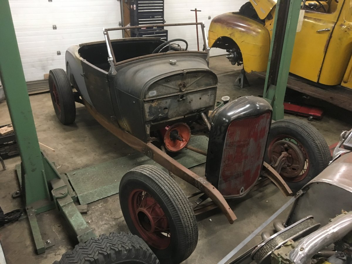

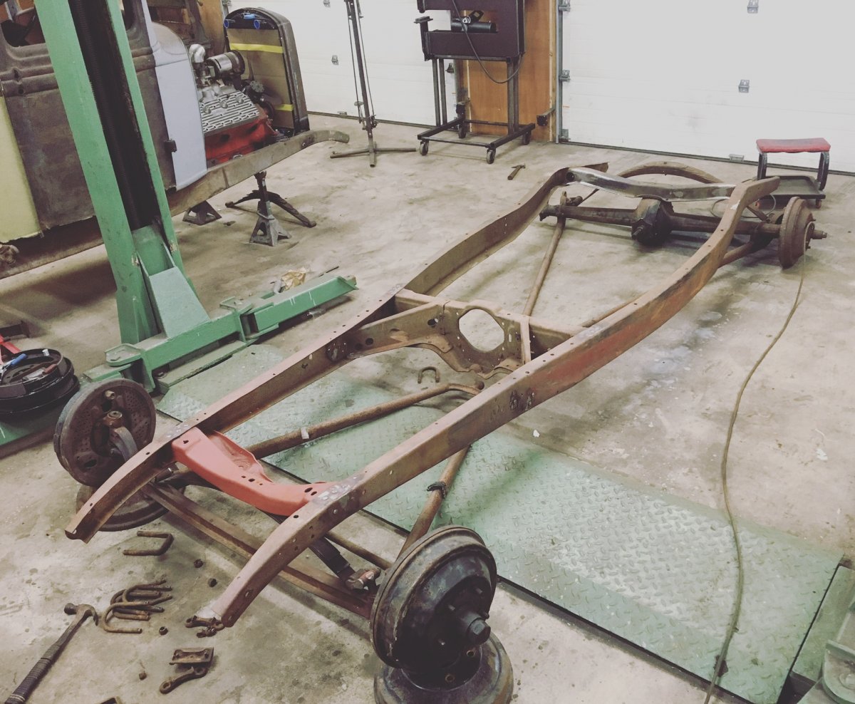

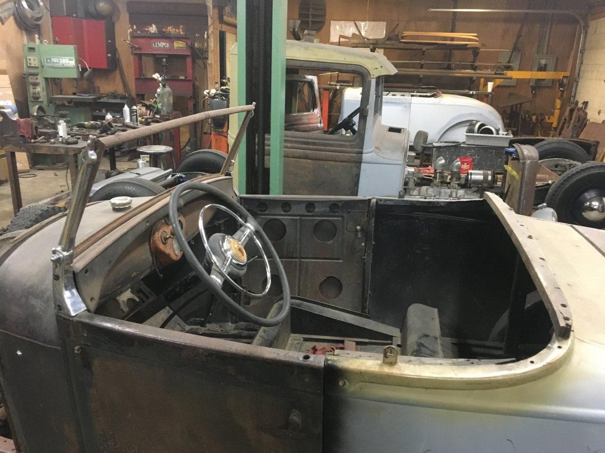

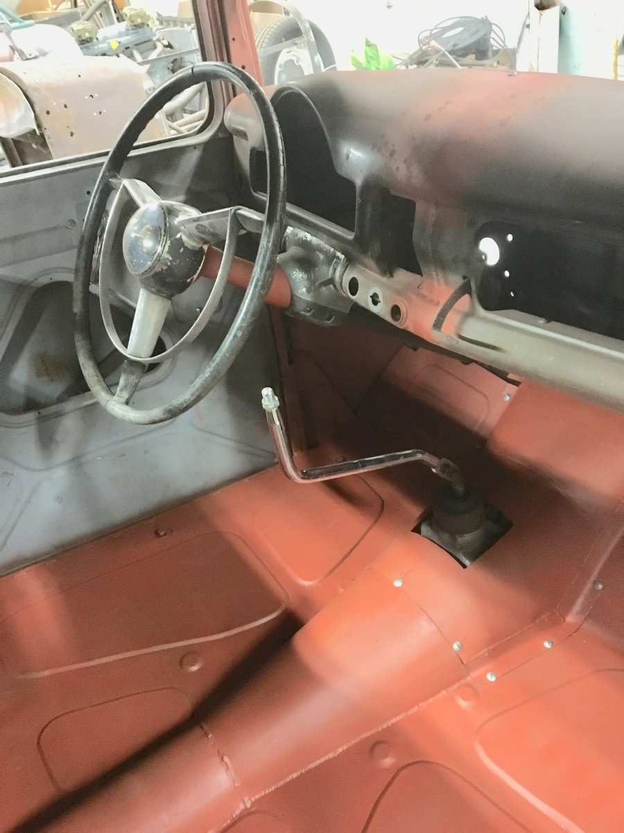

    My buddy romeos *****in 29 on deuce rails!
    D89DF01F-E82C-4224-9783-5137642950E0.jpeg 01BF28F1-9634-4C8E-ABC4-DE2AC2A84448.jpeg A29A327E-E9C6-4E0E-A21C-4E7EF9386ED2.jpeg C7A49A4C-9D07-4F65-8798-83BFBC685FAD.jpeg F56EA013-CFB1-4410-A676-D78E0EAE18D9.jpeg 6CCC6D7D-7081-451E-91C9-EA01C7F5A4DD.jpeg 5615AA57-6E0A-4834-A60E-D0A0C5EC98B2.jpeg 07C9DA85-16EA-4794-B869-C60ED8401E27.jpeg 397AD69A-BB95-444C-86D0-579C691962F9.jpeg 8B89EFD5-CA74-451D-86ED-96CDD3C6F2B0.jpeg

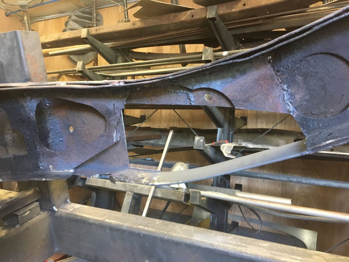

    Stock floors with subrails modified for the 32 frame

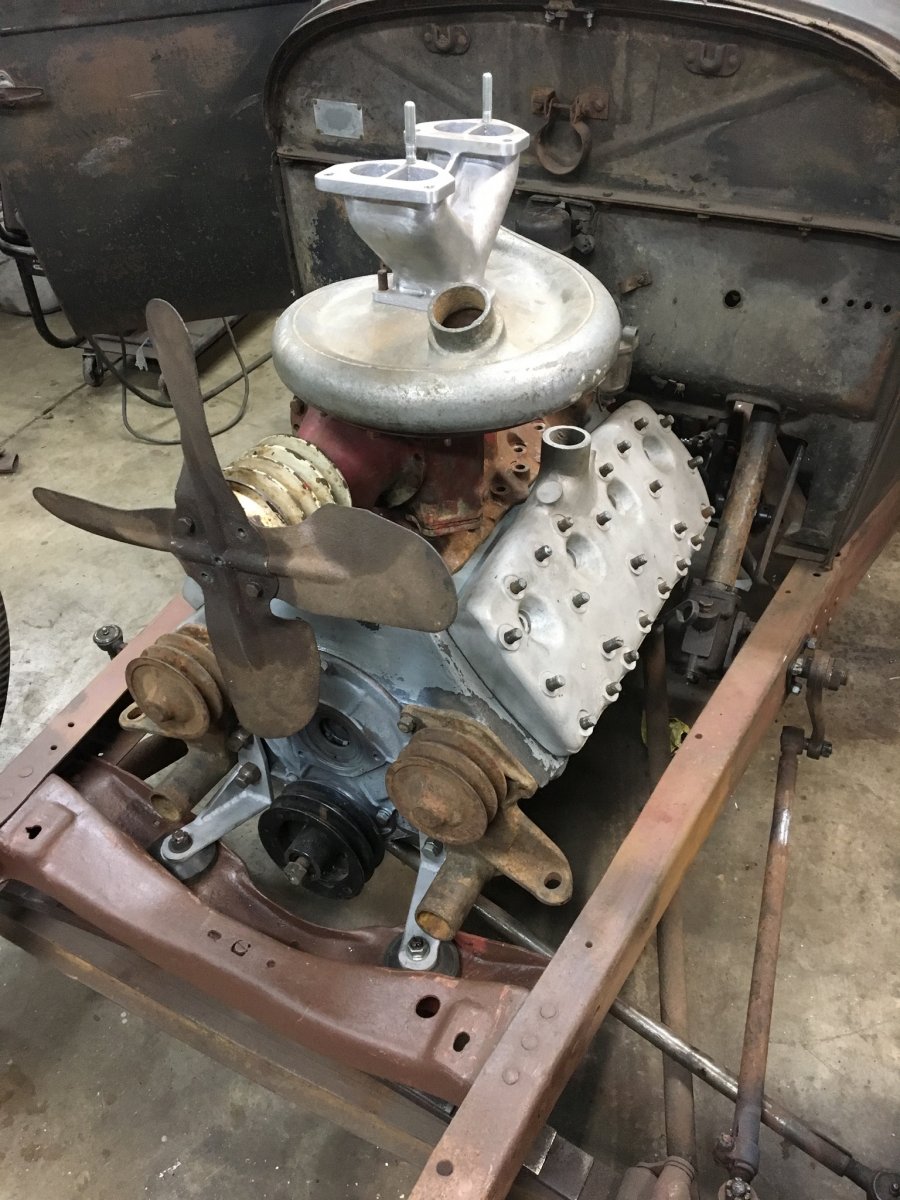

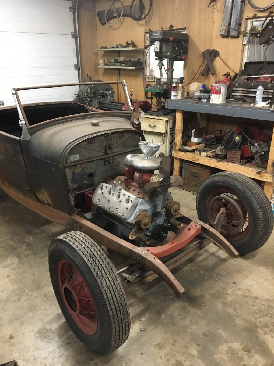

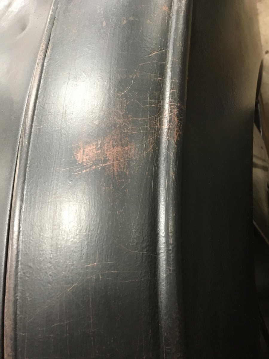

    McCullough supercharged! Doing our best to recreate the original patina black paint on the back half of the car that someone sanded and primed and the grille that came from the cl***ifieds.

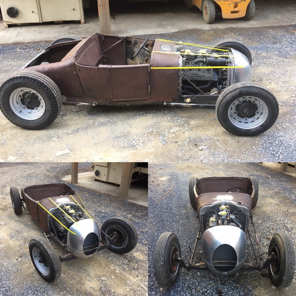

    You know I was looking at that and thinking does that ever look like Jerry's Hotrod...I did a Photoshop of that side profile for inspiration back when You were obviously ***isting him with certain details...;)
    Jerry's Build is at this link below should anyone be curious...
    https://www.jalopyjournal.com/forum/threads/jerry-s-32-5-window-project.1032277/page-7#post-11855093

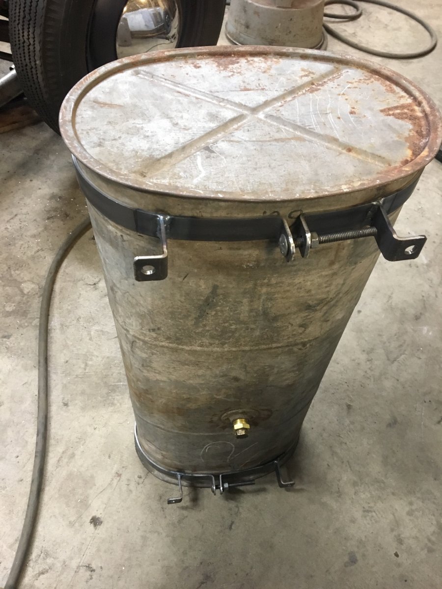

    T fuel tank for sergios roadster, I made some simple mounting strap brackets and added a pick up tube rather than gravity feed, if there’s ever a leak in the system it won’t dump the entire tank. We’ll be adding a rollover vent and sending unit, and a filler tube that extends to the edge of the decklid opening for fill access.

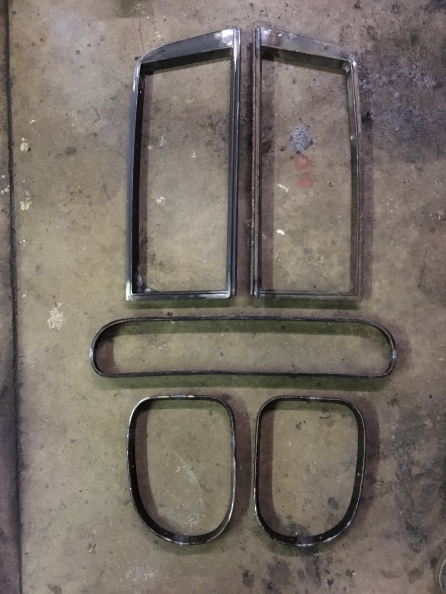

    the framework on the 33 look eerily similar to something we did before.:D

    If you wouldn't mind just measuring the centers of the windshield, side window & back window I can compare against my stock 3 wdo that I plan on chopping. Thank you. Bill

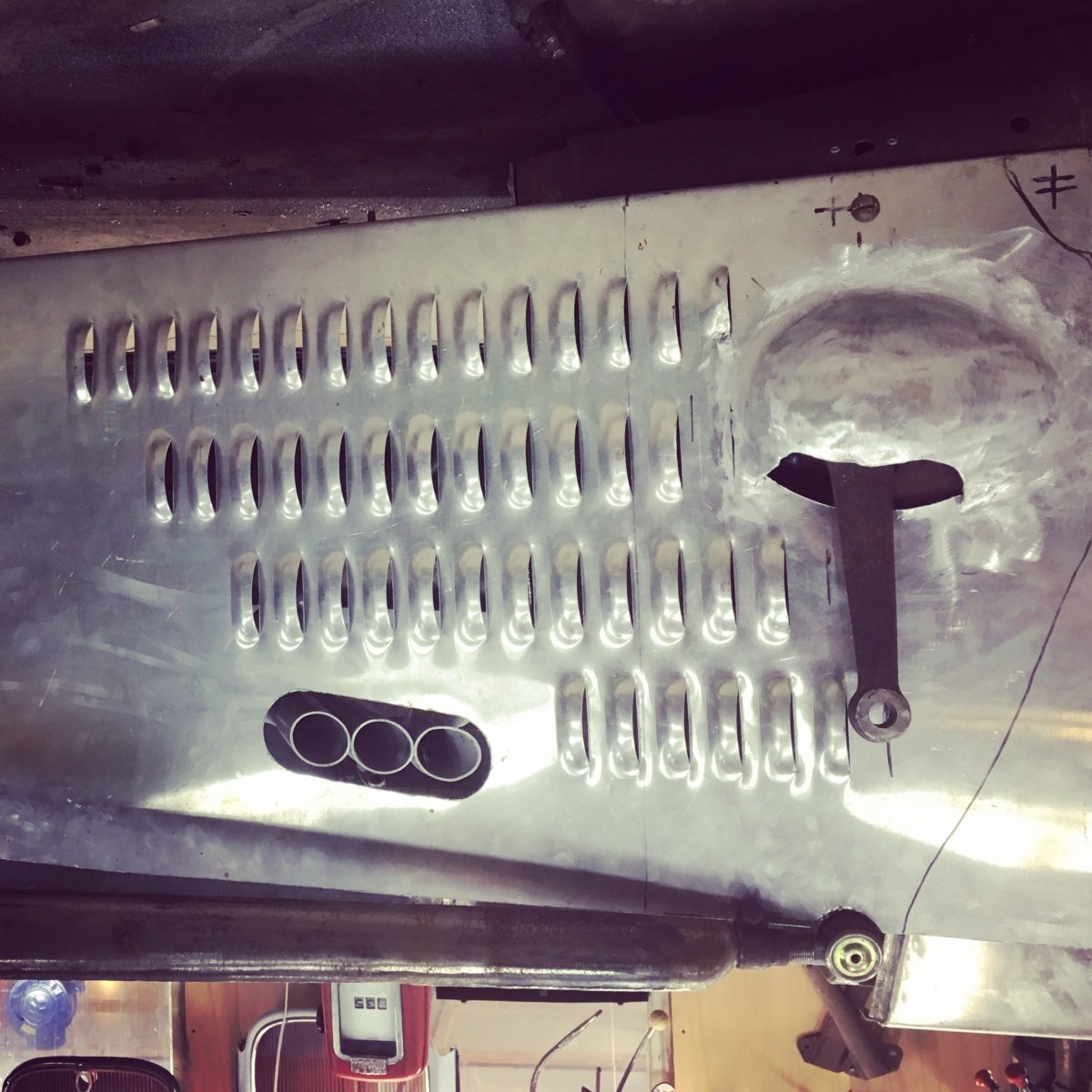

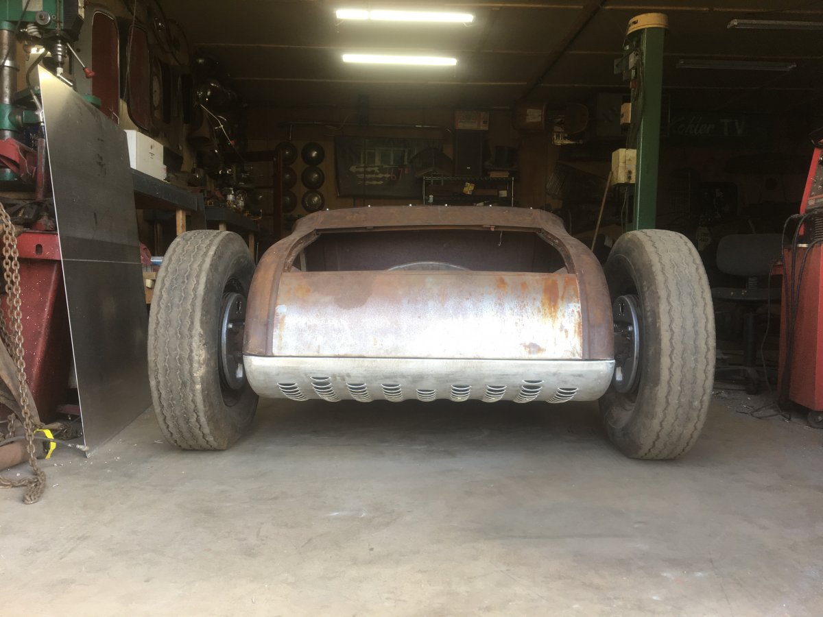

    No just at the back, I wanted to let the hot air out the back but keep it smooth underneath

    4.25" up front and about 4" out back

    Building brackets to mount a 40s ford 6cyl generator on the McCullough engine.

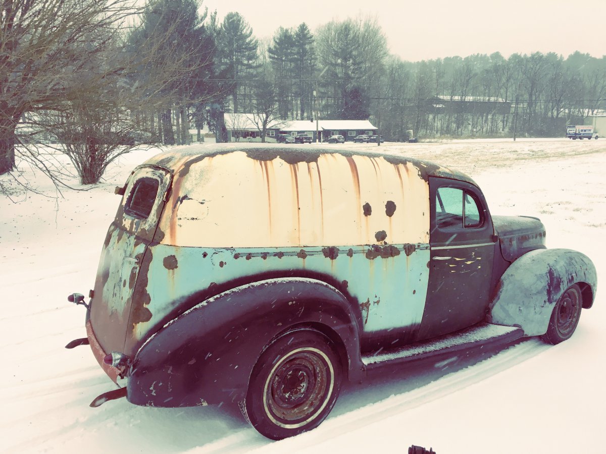

    And driving around the lot sideways in @kwmpa ‘s old sedan delivery...

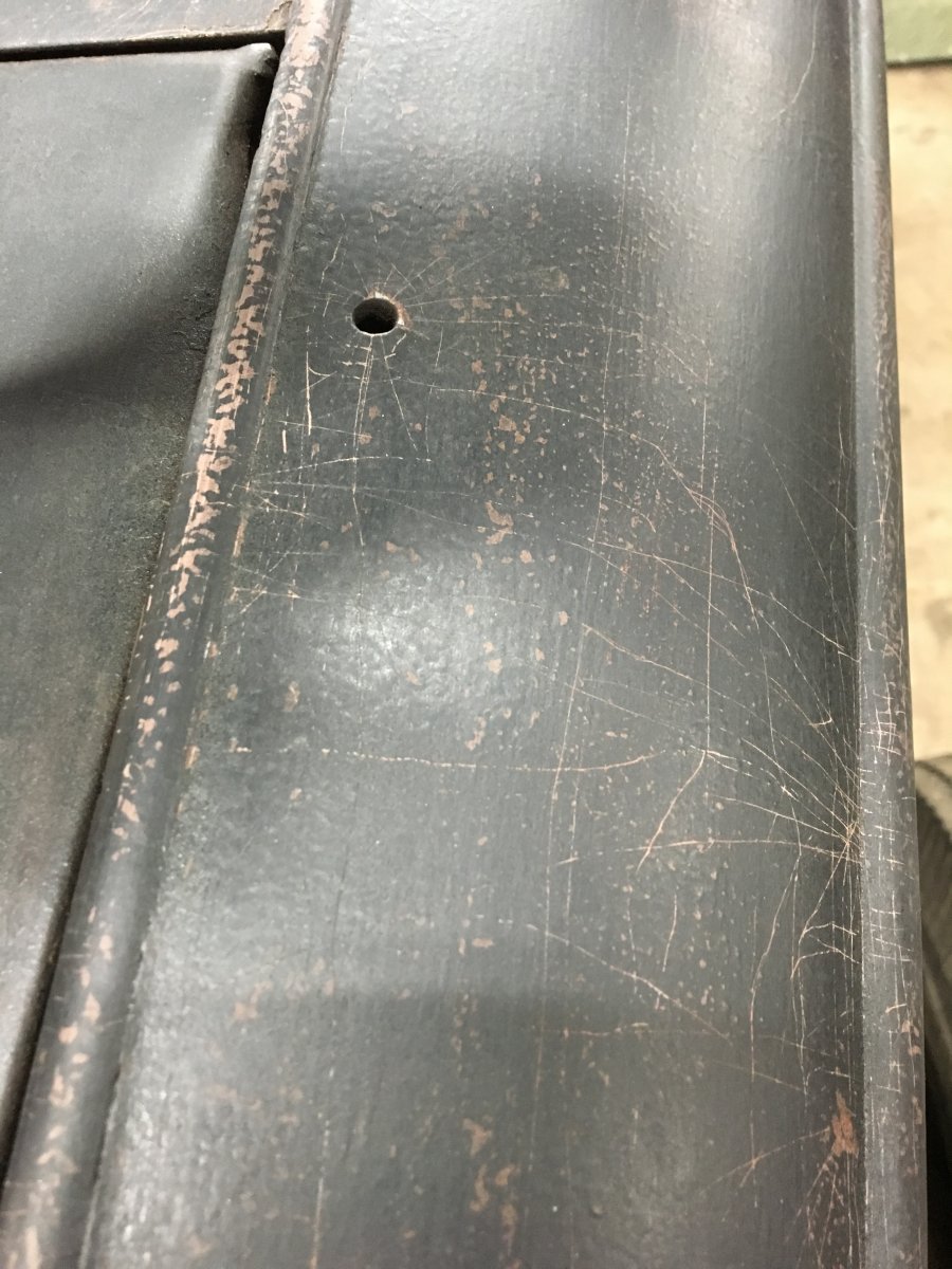

    More fauxtina on the 29 roadster...

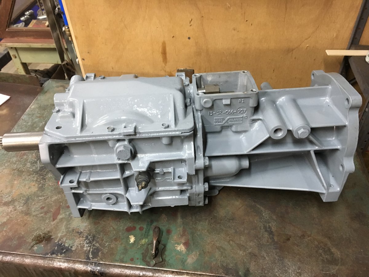

    And t5 ***embled for daves car too, non wc t5 ford case with s10 4x4 guts and tailshaft housing. 228AF174-6D65-4F47-A5CC-0E0E3B66A04C.jpeg B1153B51-39B9-4EB6-B3EA-4A4A1FDF1B5F.jpeg

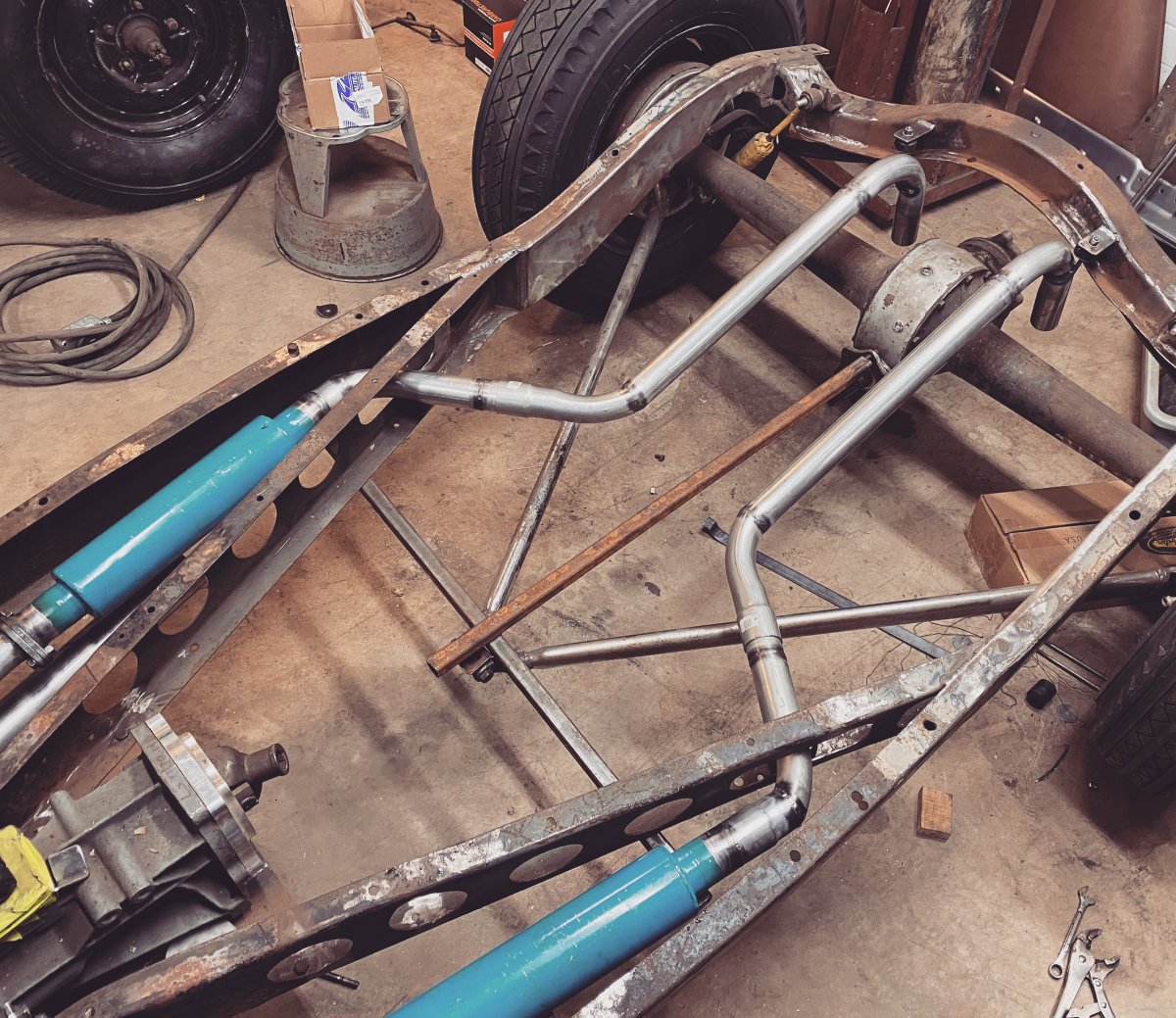

    Pats 3w ch***is got some pipes and a pair of porters, great mufflers and made in the USA. Yea that’s a pappy hough welded quickie... A7413C81-7671-4D78-A82E-4A3450935582.jpeg

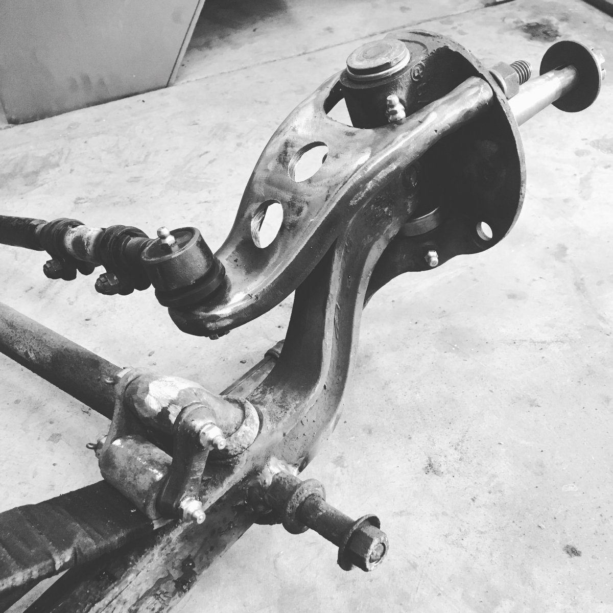

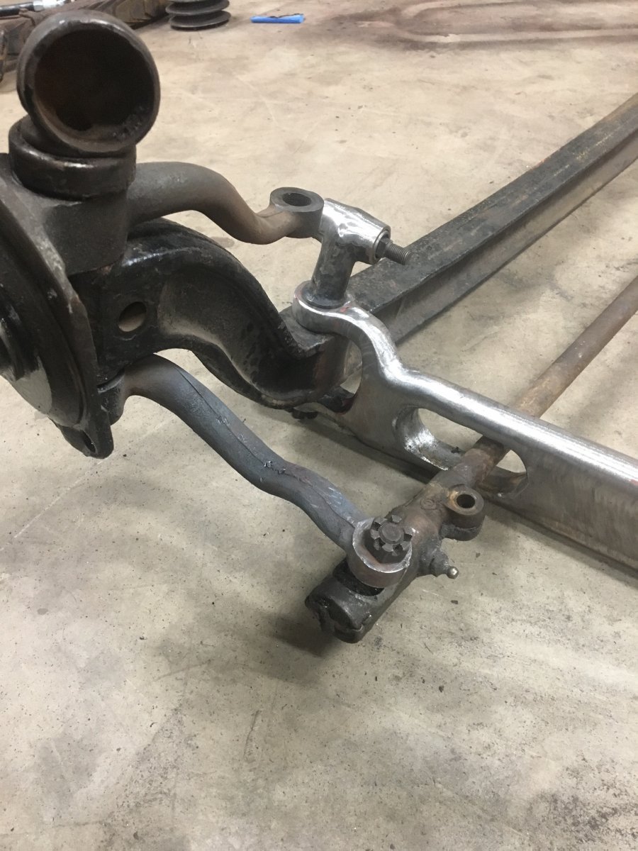

    A little repair work on a 32 axle we dropped for my pal Tom Watson. Someone had torched brackets off it at some point and gouged it pretty hard. 9338271E-FC35-4C62-B43D-E37B04055EEC.jpeg
