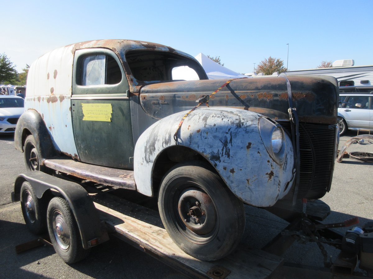

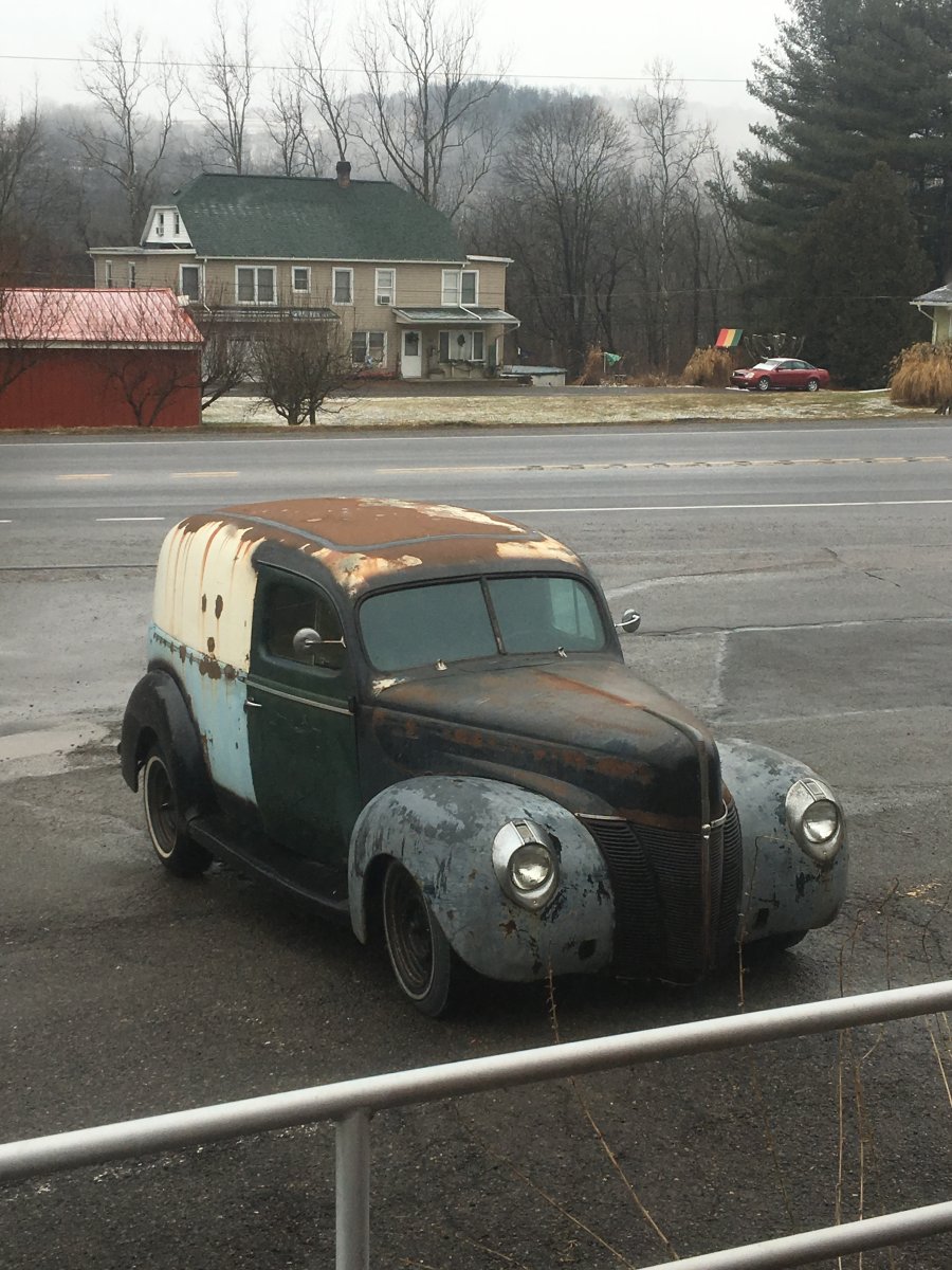

    ^^^^moon roof?

    Say what now?

    Rat Fink Hatch...:D

    On the 40? That’s just the factory roof insert seam. The sd body has a full length welded steel roof insert, probably too large of a body to stamp out of one piece of steel.

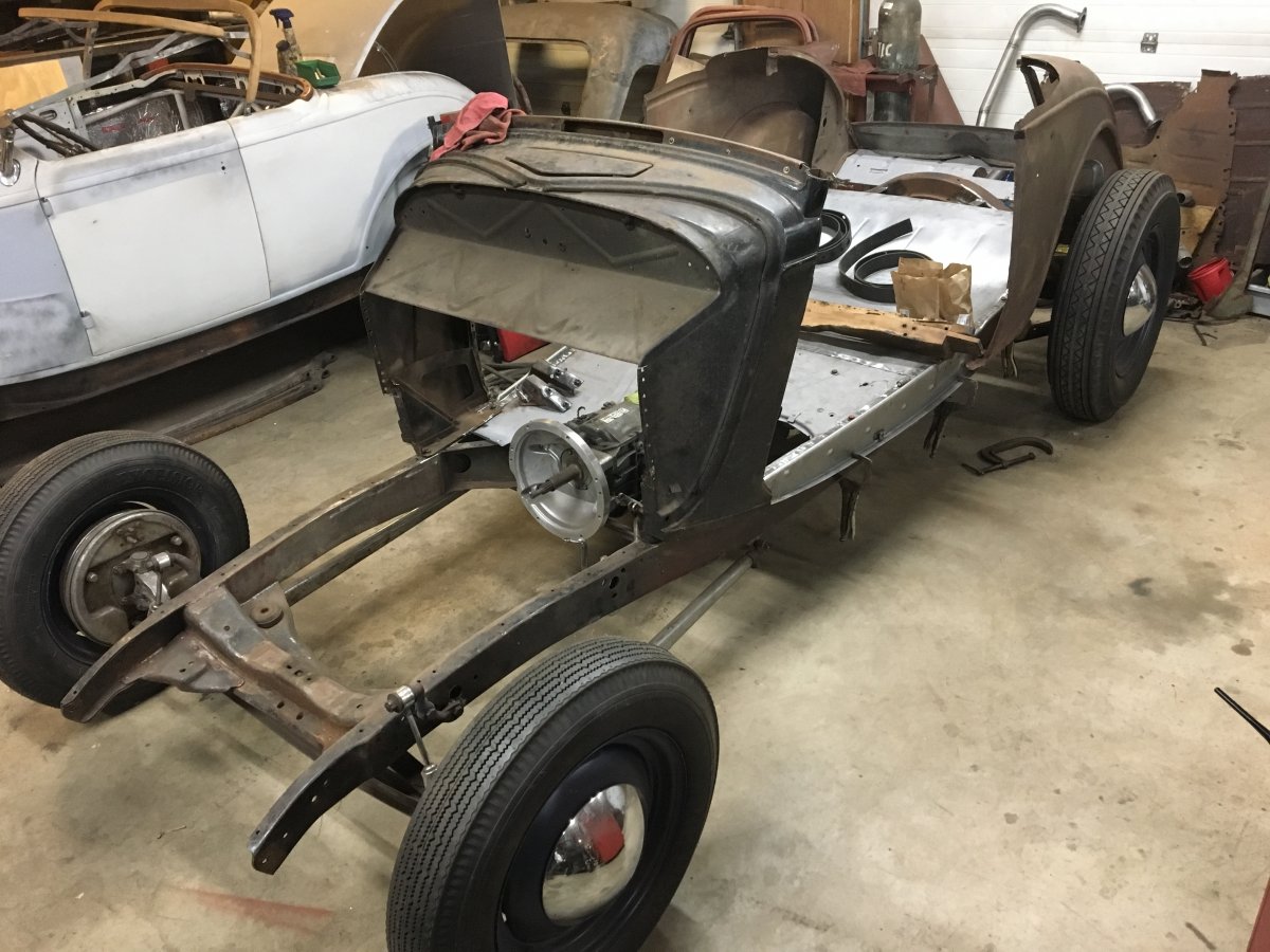

    Spent a few nights and weekends and we put together a different ch***is with extra parts and leftovers hanging around the shop, things happen faster when you’re not doing them under the car.

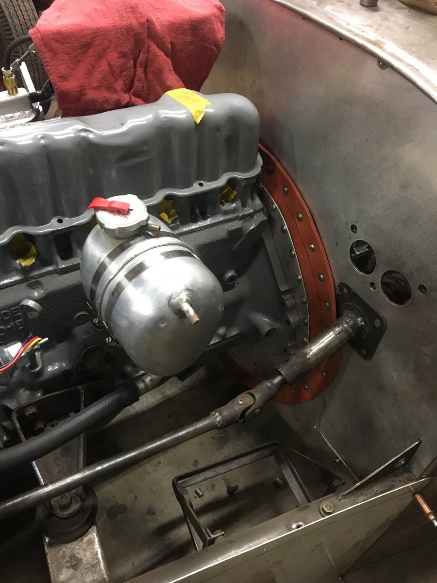

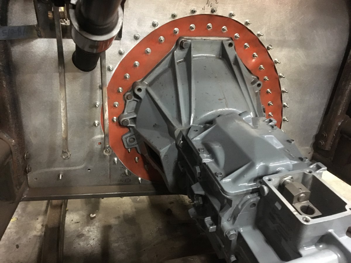

    775E8E6E-ACDC-48C0-B0DB-8A55EAD009F8.jpeg 377772A7-40A7-4C0F-962F-0E91D1631359.jpeg A little more work on daves special, getting the silicon firewall seal fit, just washers as we’re fitting it up but the perimeter on the firewall
    Side will get an aluminum ring with a rolled outer edge to improve the clamping area and for a more finished appearance.

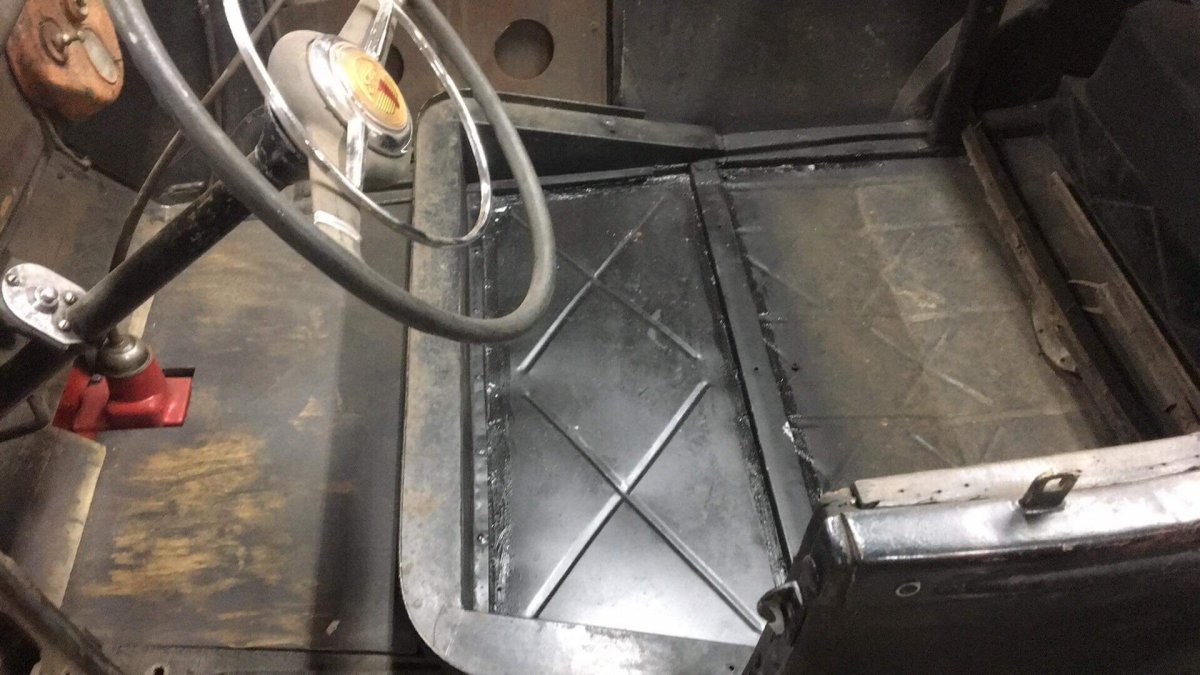

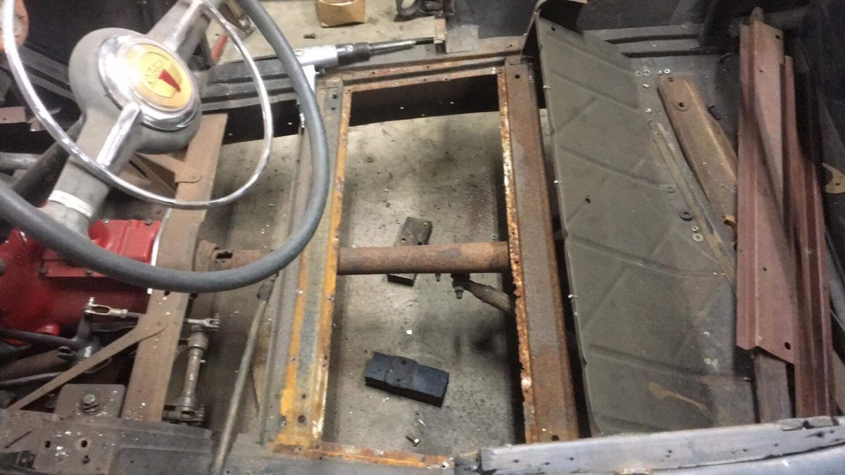

    Torque tube was dang near resting on the curtain pan on Romeos roadster, the pan and body crossmembers had some minor rot anyhow so we pulled it and installed new crossmembers, a flat panel, ditched the bustle, and moved the riser back a couple inches. We were able to save an old toe board that fits the cars personality, made a floor board from oak ply and gave it a paint job to match, with some real road dirt and a few hundred footprints on it, it should fit right in.

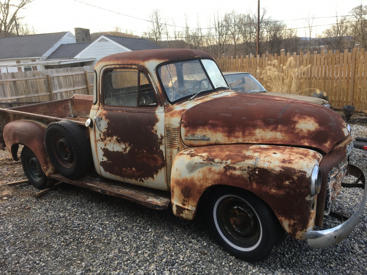

    Whew! Jeffs truck is torn down, blasted, straightened up and ready to head off to tuki for paint! Got a big pile of parts headed to the polisher and chromer as well. This is gonna be one fine hauler!

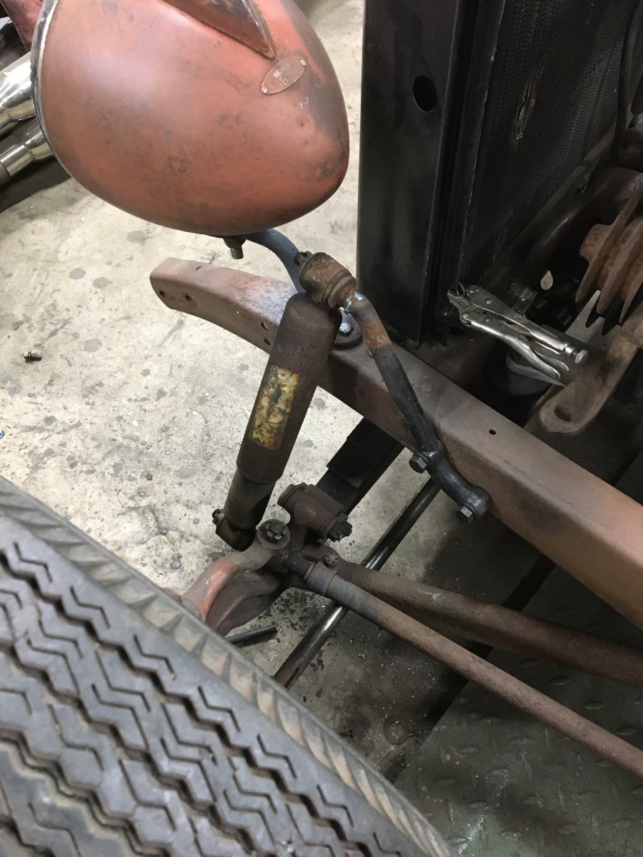

    Front shocks and a headlight bar in progress on Romeos roadster
