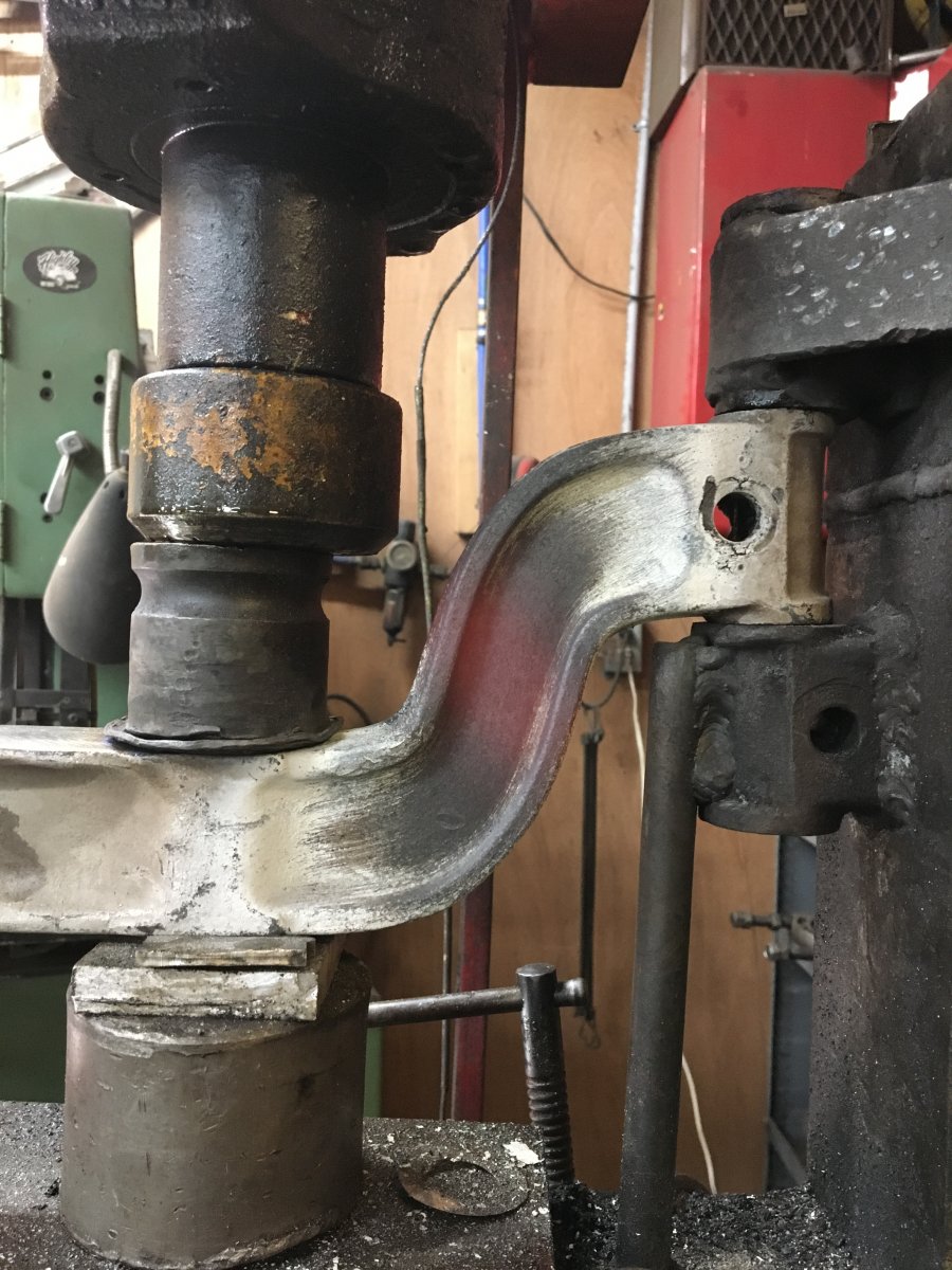

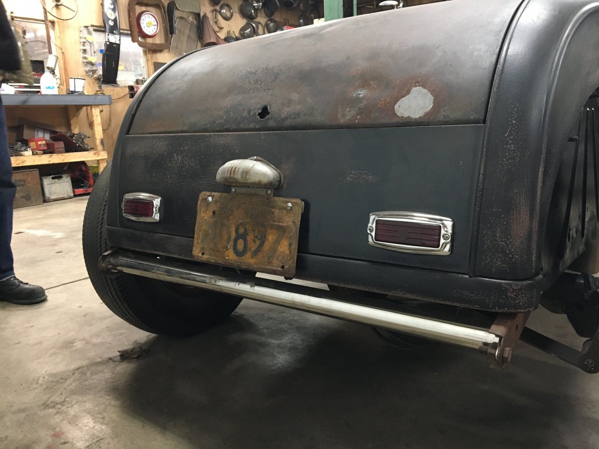

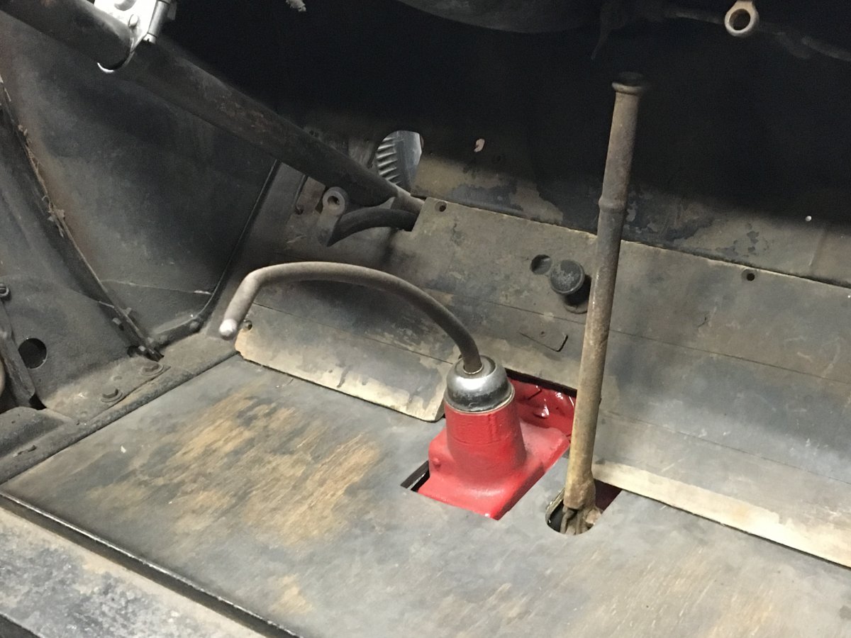

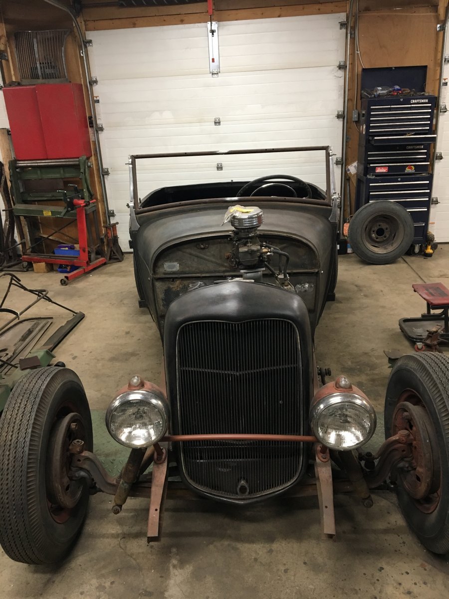

    Romeo’s roadster got its e brake, headlight tie bar, and rear spreader and tag light.
    BB2DFF90-57B2-4287-AB0E-CE59A150AF39.jpeg E99D01DD-E5C5-4625-A93F-9F132E28E402.jpeg 910DB08E-D8E8-4DD3-BA21-7FE21327CA6E.jpeg
    Brent’s beautiful 32 axle cooling slowly...
    And I was planning to be hawking dropped axles out of the back of this shady character at Cleveland autorama right about now but covid19 had other plans for us all. Bummer but Oh well, back to work... building a mechanical fan drive setup for the Brock’s supercharged 59ab, pics soon!

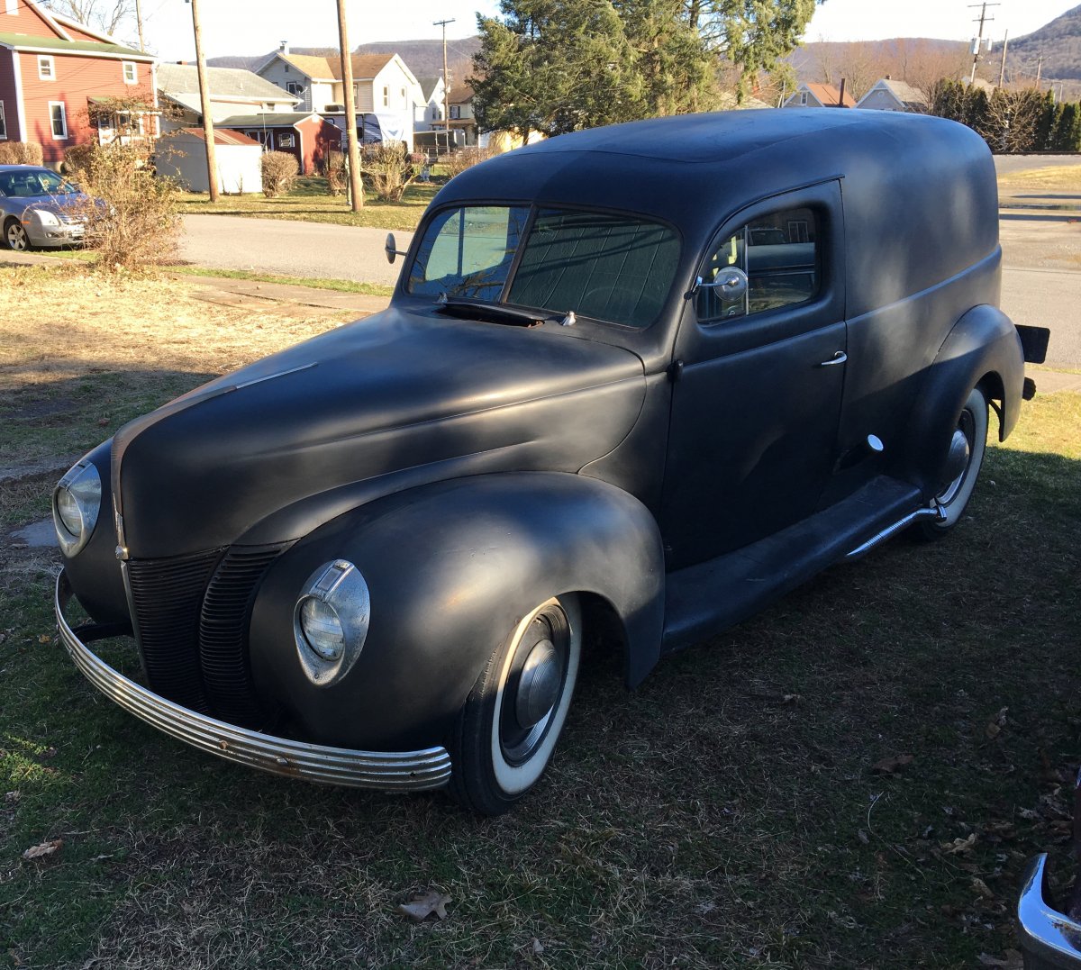

  24. thunderbirdesq
    Joined: Feb 15, 2006
    Posts: 7,091
    thunderbirdesq
    I don’t know if I’d call it a paint job... but. If it was all one shade of raggedyness I could have tolerated it but 9 different colors and bare rust and old paint just falling off all over.... it needed to be all one shade at least.
  25. Stogy
    Joined: Feb 10, 2007
    Posts: 27,218
    Stogy
    @thunderbirdesq, Your simplicity in mods on that Delivery really set it off...what a stunning balance of Shiny, Custom additions and Paint and yes primer is paint...the 1940 Ford one of Henry's Milestones in Excellence...
  26. KandN Kustoms
    Joined: Dec 15, 2008
    Posts: 491
    KandN Kustoms
    Lol! Yeah I get it, it just looked so cool with that "barn find" look!
    But I still dig it, and your other projects are looking good too!
    Sent from my SM-G960U using The H.A.M.B. mobile app
