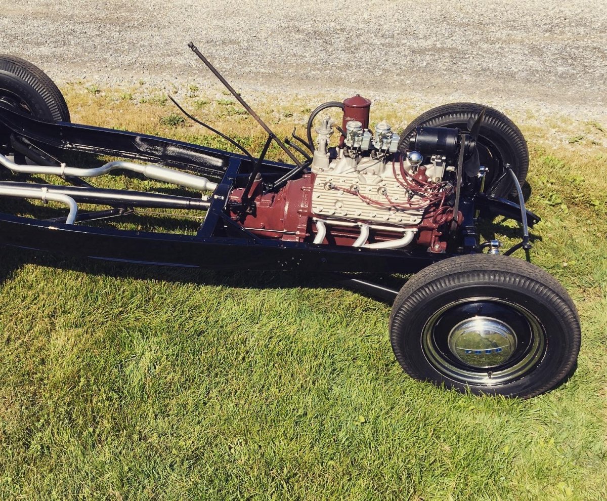

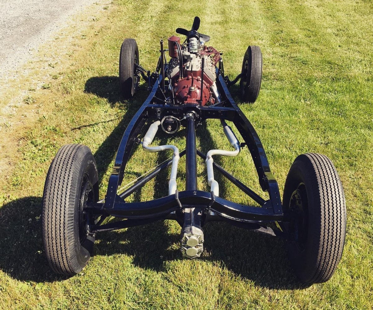

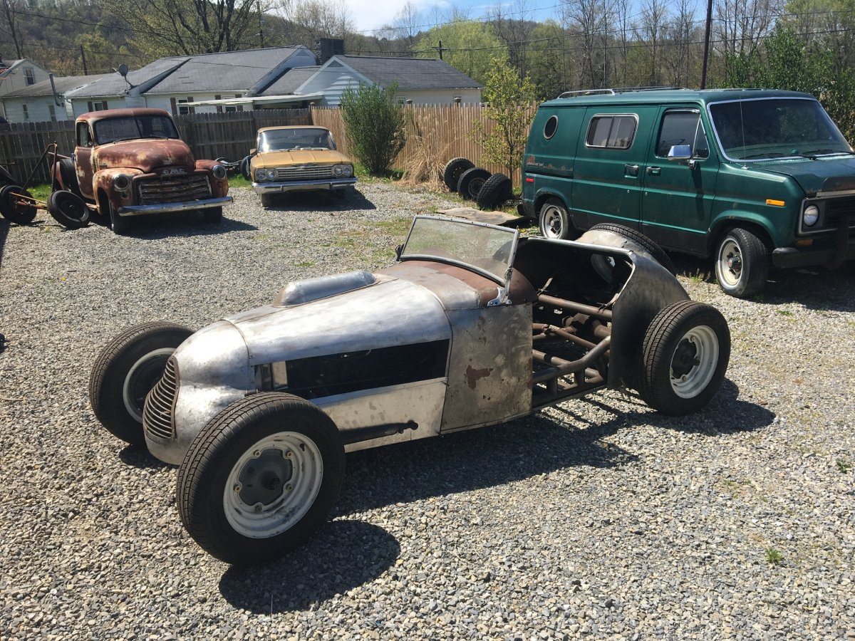

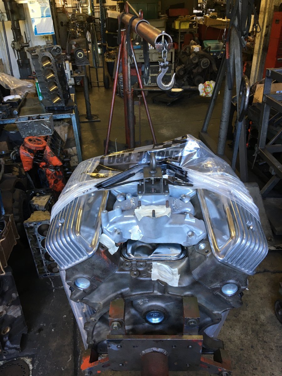

    Starting to collect parts to revamp ol 169, I had to move her from one storage spot to another for the last time. This buggy deserves to be driven so I’m gonna make a “few minor changes” this winter... 9491B289-4D65-443D-9B33-D96DE06166D7.jpeg
    working on this set of Belond-ish stainless headers for Rich’s y block, almost done, just gotta add an extension to the down tubes and a set of outlet flanges.

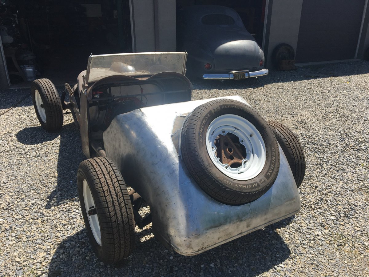

    And I’ve been ironing out the tail section to Dave’s manning ch***is special, still quite a bit to go but it’s starting to take shape, mocking up a spare tire faring in cardboard...
    62BC7B84-6820-4F36-BCB2-8D45B9C05116.jpeg E0C17929-46CE-4DE7-B1BD-0CB0AA5AA147.jpeg 11F7CF19-CEA3-4681-887A-31D3B08213A1.jpeg

    I really like that track nose. Rest of the car kind of remind me of an Allard. Be interesting to see some cycle fenders and partial rear fenders on it.

    It’s got some allard influence, a pinch of 40s Indy car, some early ford hot rod, a little mg, and a bunch of home built sports car. I’m getting pretty excited to drive it!

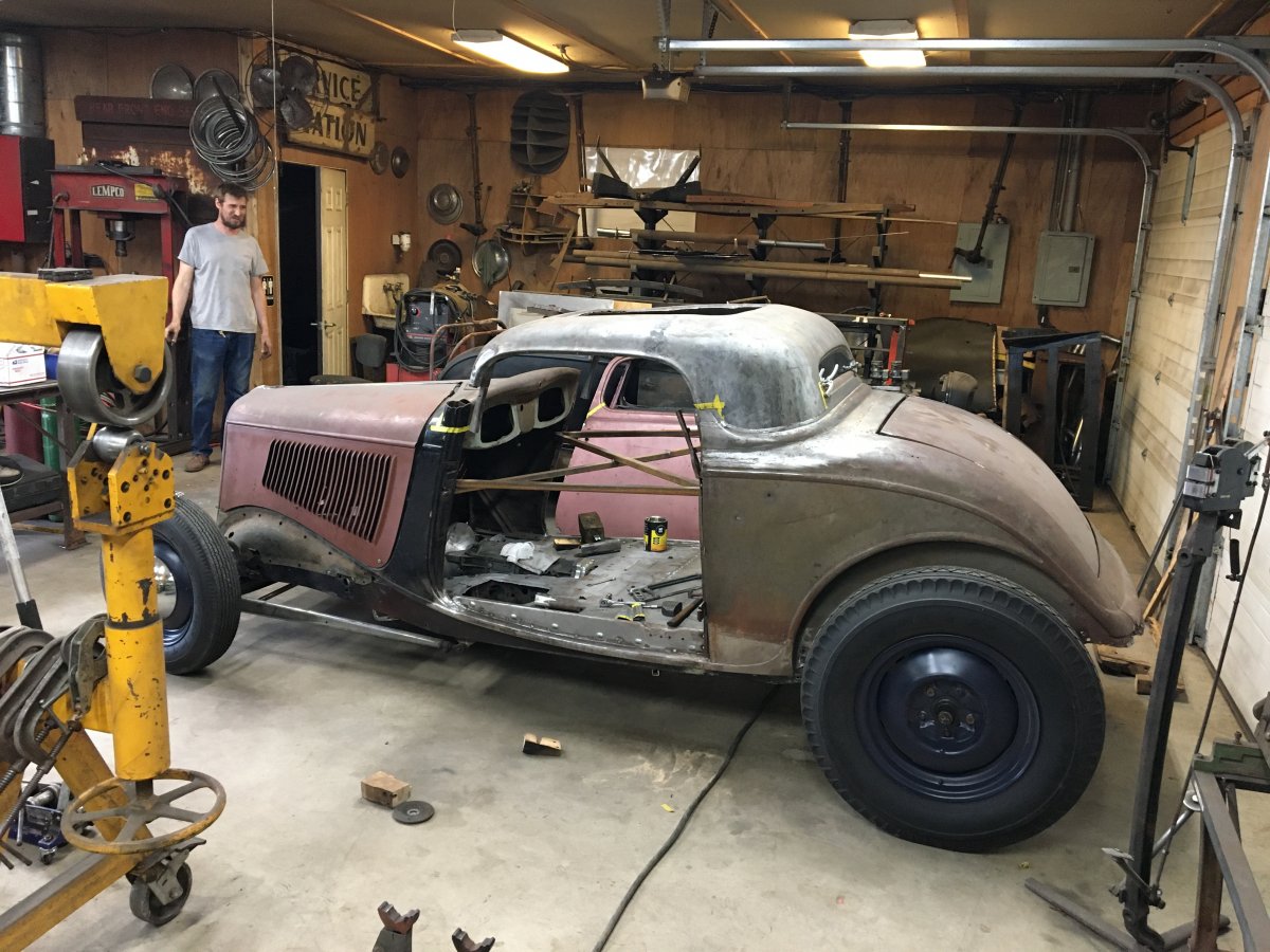

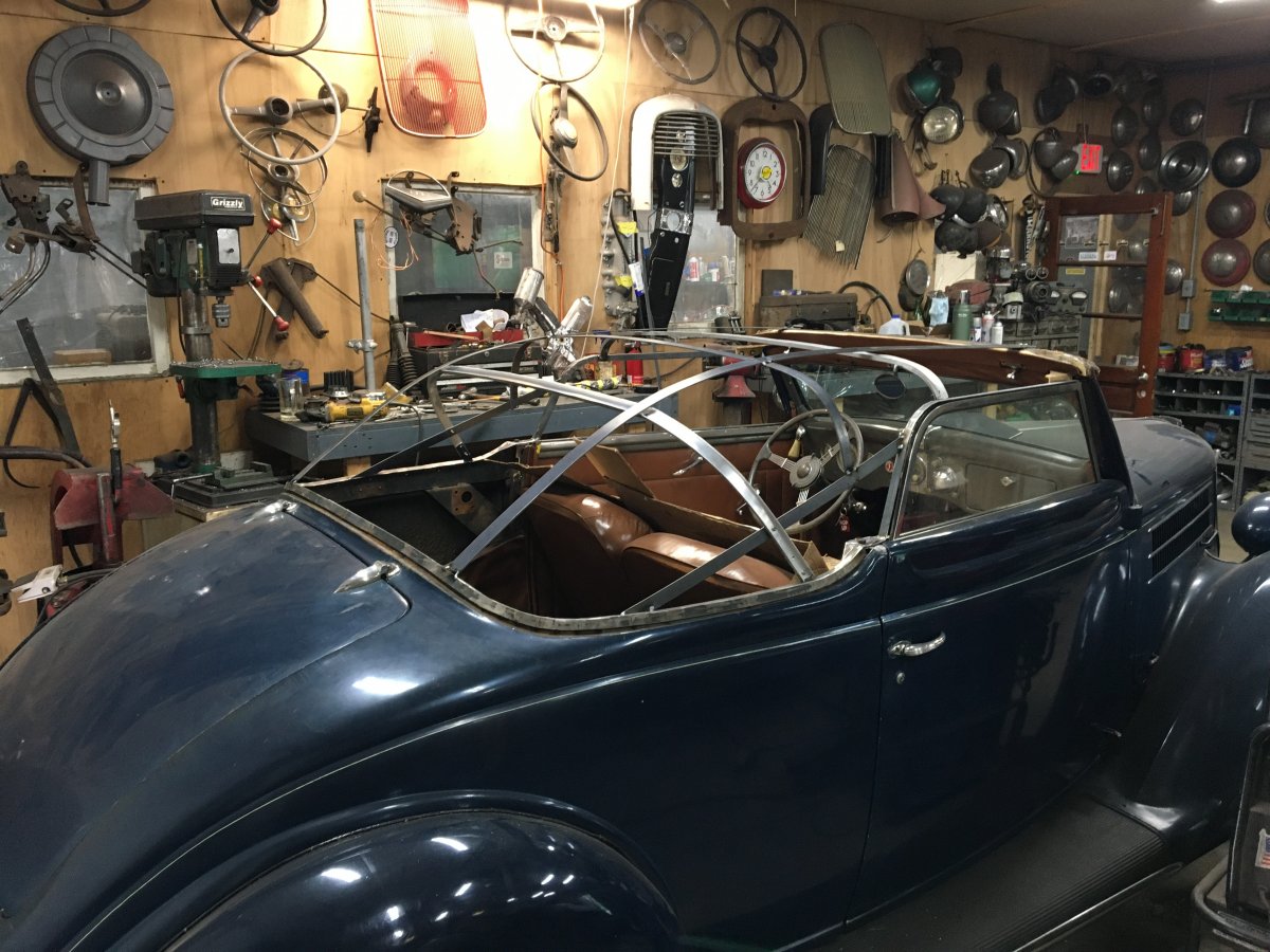

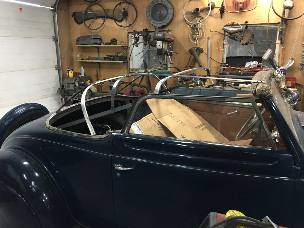

    a few more pieces of the 36 Carson top frame found their homes, got some more laterals to install and then a bunch of woodwork. And pat’s 3w chop started...
    AE36BCF6-33B9-4A43-9FE8-6D44EED3066E.jpeg 789C0A06-244B-4A70-B313-8B7686B76FCF.jpeg 1A0915E8-AEC3-461B-A5C9-F7DAD3B0164F.jpeg 66198449-BD4C-4B42-85C7-8CCC171AB7B8.jpeg

    Nice roof profile on the 36 roof.

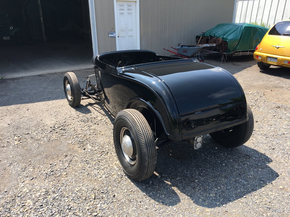

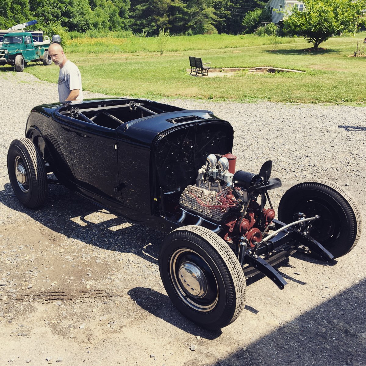

    Set the very black body on Sergio’s ch***is! Hot dawg!! my buddy Matt Wagner showing off his amazing body and paint work.
    48BE1232-F0F2-45FA-9BDE-82701363E5F5.jpeg 75C5820C-CD92-4978-96F6-355C91B073AC.jpeg 8DD2518C-0D08-431D-AB12-7F934AEE9859.jpeg FBB265D3-EBB2-4AAB-A58F-61A7A5A66F29.jpeg

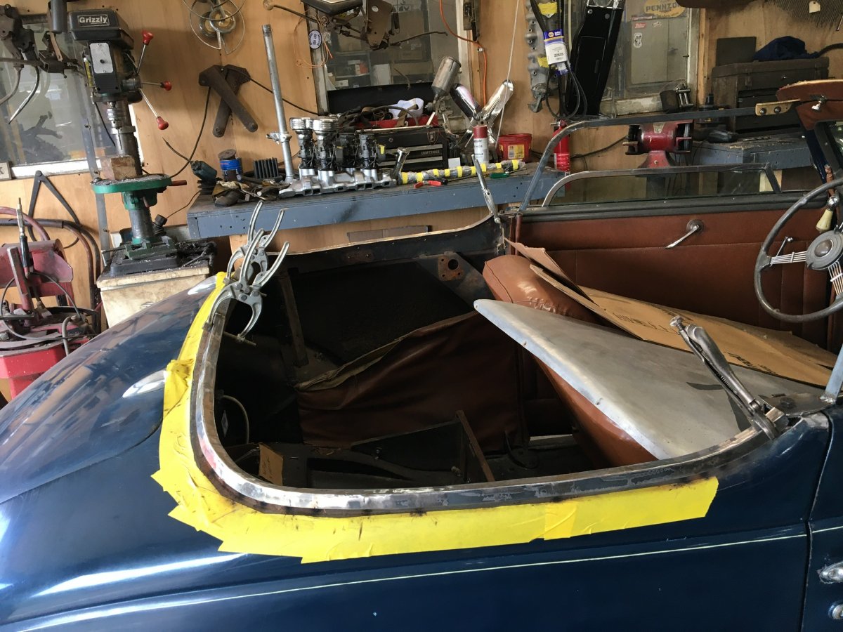

    Checking window profiles and fine tuning the roof shape on pats 33 3w. We got the rear roof tacked in place and inner structure on the a pillars finished. I completely remove the pillar skins in the chop area, this allows total rebuild a full penetration welding on the inner structure. The a pillars skins had some pretty serious rot around the factory weld and under the factory leaded areas, we will have to make the upper sections of outer skin.

    The reflections in that body are straight.
