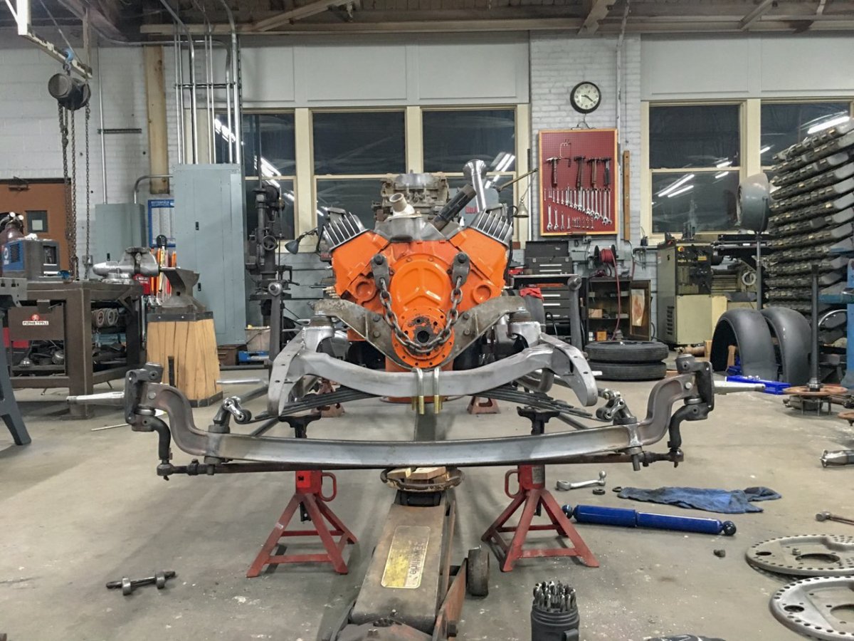

    Original 32 ch***is rehab...
    70E84970-90ED-4617-8A57-4789FB5F3CB4.jpeg D9C9E0B9-BC1B-44B8-932B-E0C89926C0D9.jpeg 83AEB15D-61F4-45B0-9616-E3D2D11EDD2B.jpeg 885FFDCB-CA0A-45B3-8915-05D7B1F3B964.jpeg E5A31ECE-94F2-4485-99F8-C45C3837063B.jpeg F66E1271-A7B0-4934-A65D-F1D6E3631337.jpeg 22F78A51-0C6A-4917-9671-F8F4100CBDBF.jpeg 248F5D62-19E5-40F7-81D1-C0F27D6A4735.jpeg 093F2B5E-20E0-44B8-BC06-2FCEBD04F6C0.jpeg 439D9C5B-3C41-4BA3-AAF0-7F46DAE0A221.jpeg 77678D92-1242-4745-A04C-5542D7EB3DB9.jpeg 7B08BB83-3051-49D4-9D33-A27FEE8958F3.jpeg FC1172BE-B1EE-4FDD-87AB-BFC07C35DB82.jpeg 9274B03A-0B4A-4AF5-B89E-FCE77DFDDD30.jpeg 3D17D2E2-B56D-4081-B0B6-5A7BD9E0FC62.jpeg

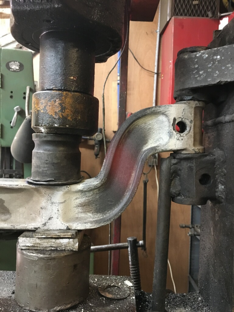

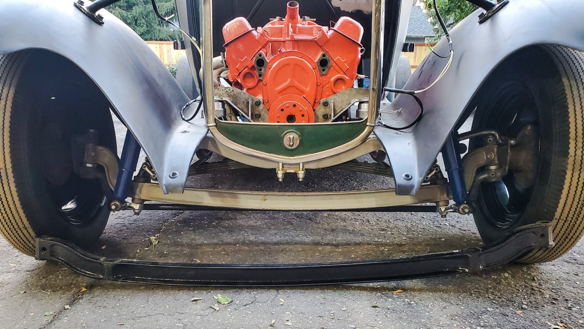

    Andy dropped and "squished" this 32 for me.
    Here it is compared to a stock 32.
