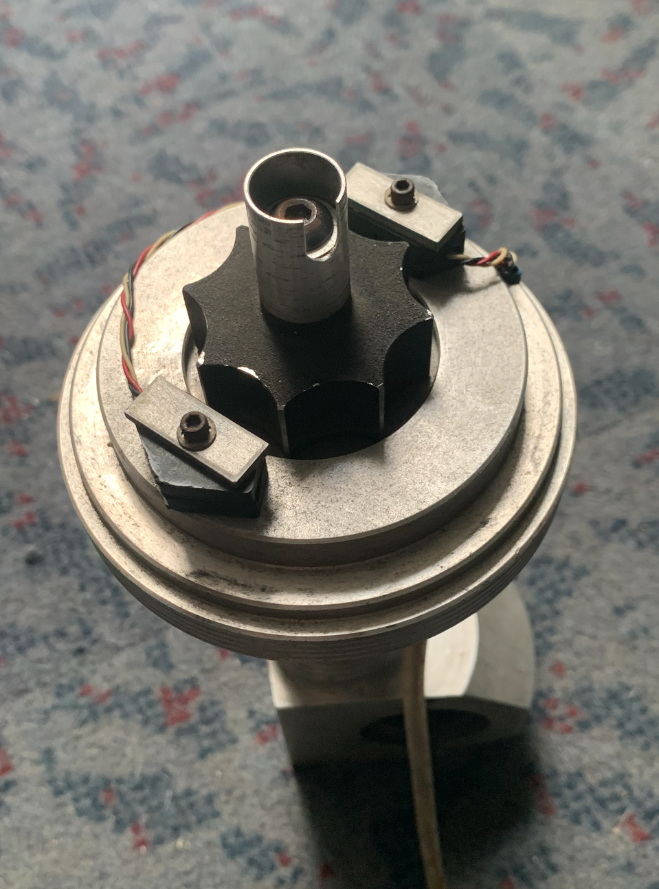

  1. Looking for any info I can find on off the shelf parts I could use to get this working. This will be running front-driven on a Model B engine.
    Also attached is a photo of said front drive with a cap on it. Can anyone identify the cap?
    Thank you!
    Screenshot 2024-06-30 at 6.31.37 PM.png Screenshot 2024-06-30 at 7.18.33 PM.png

    Somebody's homebuilt electronic - late 50s ear;y 60?
    I've got a 1929 Mallory centrifugal advance dual point. I bought a Pertronix kit to change it over. You'll need to change the impulse ring.
    Got anymore detail photos? How does the advance work?

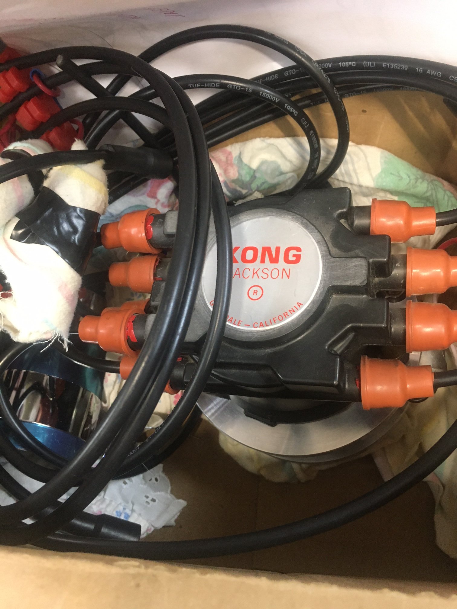

    I was told by a few KONG used Toyota parts. This is KONGS last ignition before he left us. IMG_0854[260].JPG

    I believe the last versions used Toyota caps & rotors.

    Retson, pretty sure the cap you show is a GM with the quarter turn clips and you would lift the door to adjust the points with an allen wrench.
