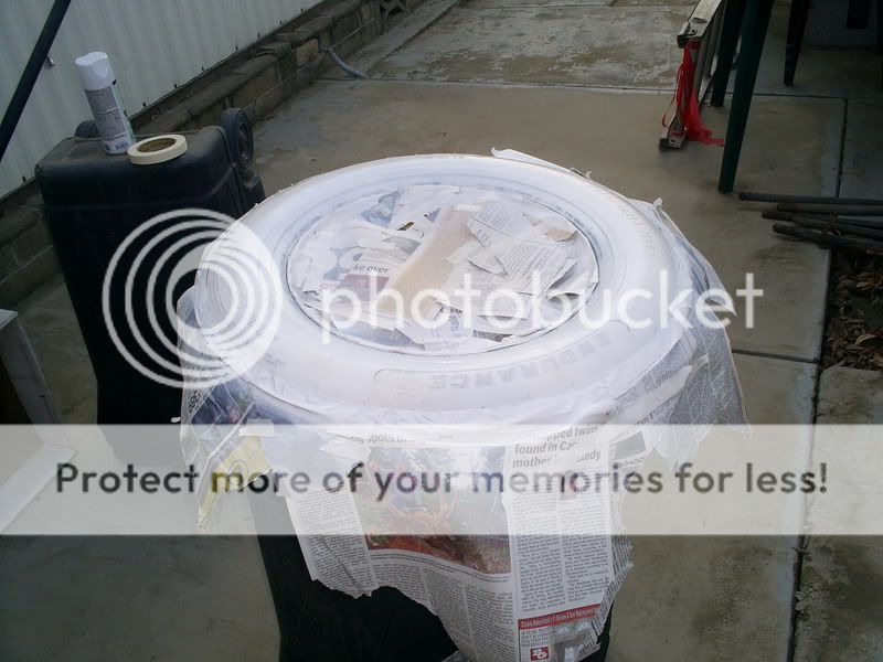

    i just got through painting one tire and its not good... it was bubbling up in some areas, and sort of brown, i took some pictures, give me a few minutes and i'll show you what i mean
  8. luvzccr
    Joined: Dec 10, 2006
    Posts: 668
    luvzccr
    as u can see in the first 2 pics i dont think that is supposed to happen..... ****
    and i didnt sand down the side of the tire because 1. its a test tire, 2. didnt have the time, and 3. i wanted to see how it'd look with the letters left on there
  9. luvzccr
    Posts: 668
    luvzccr
    i took the tape off.... from far away it doesnt look THAT BAD, but i hate knowing that there are flaws there even though others wont get that close to see it...

    I did mine over the summer to a set of tires I had....Krylon Fusion. I don't remember seeing a GLOSS or PRIMER...I just bought White. My prep skills were lacking, so I didn't clean them with brakleen, or sand them. I just cleaned them off real well. The first tire I did bubbled up just like that in the pic. The rest of the tires I used Brakleen and they worked great. Still no sanding.
    Let them completely dry before doing another coat, but that bubbling will cover right up.
    As far as how long they last....it really depends on the tire. I did it to a set of Mickey Thompson Sportsmans.....they're pretty oily. The brown started to show through after about a week. I just painted them again. For a few bucks a can....who cares really how many times you paint them. It is paint, so you have to understand that they're not gonna last forever...and they're not going to survive curbs and rubbing. Just take some time and make a template out of posterboard that you can lay over the wheel, and one over the outside diameter of the tire...then tape it up. If you have to re-paint them often, this will save some time.

    I painted the tires & the front ones where tires i had on awhile, over the years i used stuff to make them look good ( armorall, yada) Well they looked good till i rolled with them, they started cracking right away!! I tried cleaning them with everything under the sun & they still cracked.
    the back ones on the other hand really didn't have any "shine" stuff put to them so they held up alot better!!! BUT.............. They turned yellow!! big time.
    I finally ended up grinding the whites into WWW, its not as easy as it looks but its not rocket science either, results are much better.
    Sorry i didn't get to here earlier to save yas some time ,but i was being a winter slug & sitting around watching twilight zone marathons.But i hate to say it cause this thread got into some ugly **** but its not worth painting...
    Go with grinding them
    jimV
