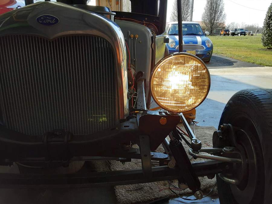

    Got headlight relay installed and wired. Left headlight hooked up and working.

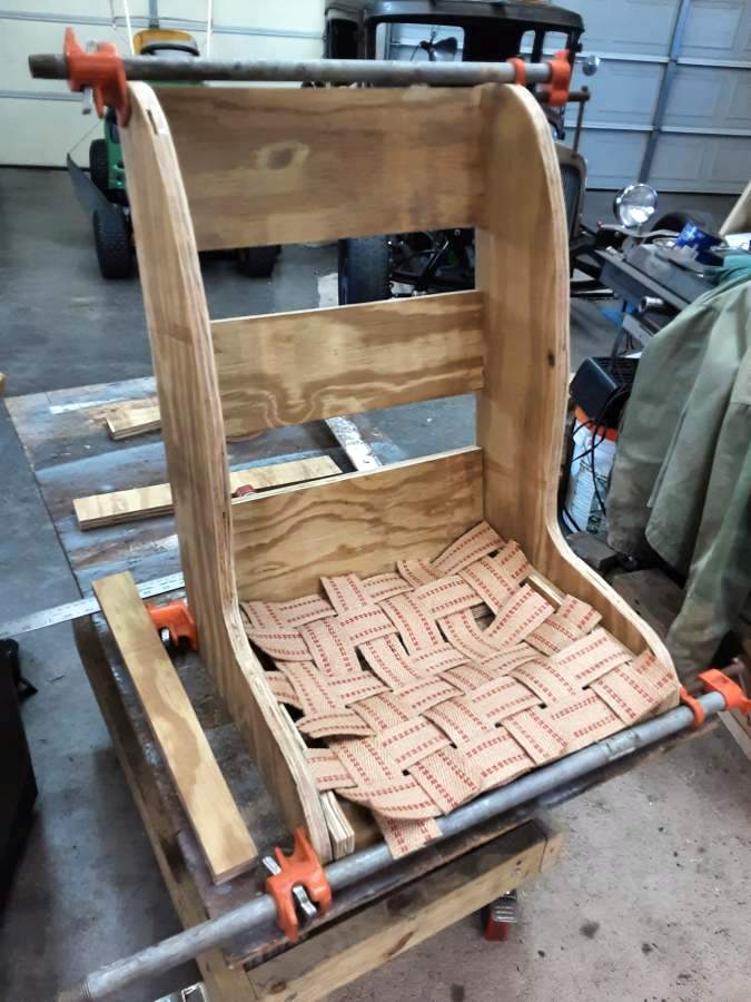

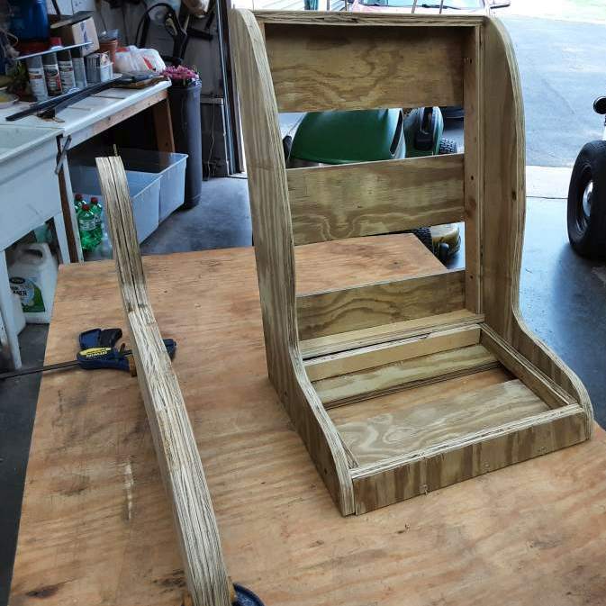

    Making progress on my home made plywood bomber seats. Drivers seat all cut out, holes predrilled, and slots cut for biscuits.
    Glued, biscuited, clamped, and screwed together.
    and all glued and sides traced and cutout for p*** seat.

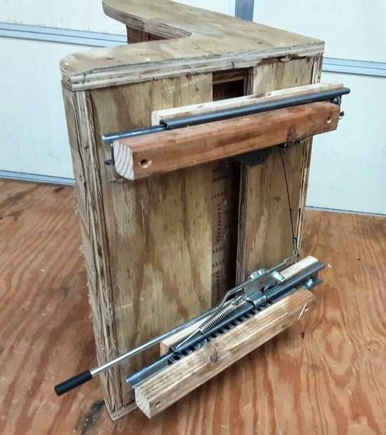

    Next up was to install the slides on the bottom of the seat. The wood sticks will be replicated in steel. Got to order it as I don't have a local supplier in town.

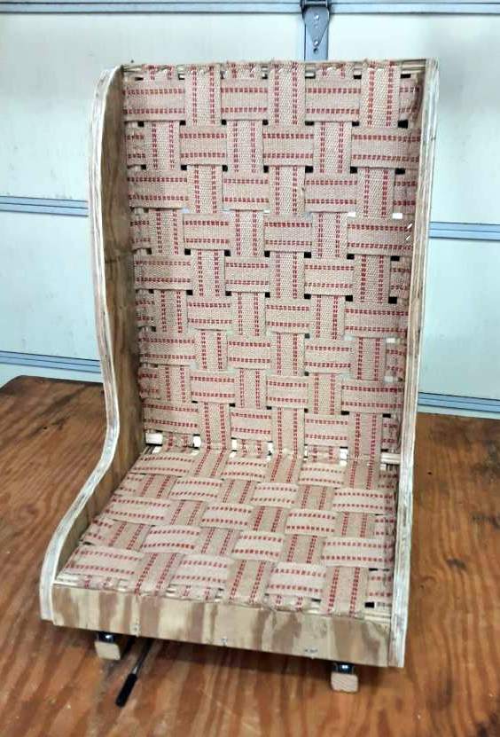

    Then installed the webbing in the seat and cut the 2 inch foam to fit.

    Tried it in the car and slides work great even without being bolted down.

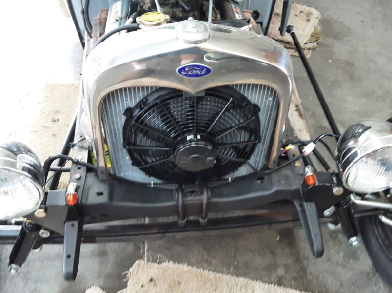

    Very little to show this week. I need to get a fan installed but went way over my Model A budget last month so have to wait a month or so. Also need to get some decent rear tires as the rollers on it are cracked.

    Got back to work on Kurt yesterday. Bought myself a birthday present (was today, 79). Got the pusher fan and Wiring.
    Got it mounted today. Next up install the relay, wiring, and thermo control.

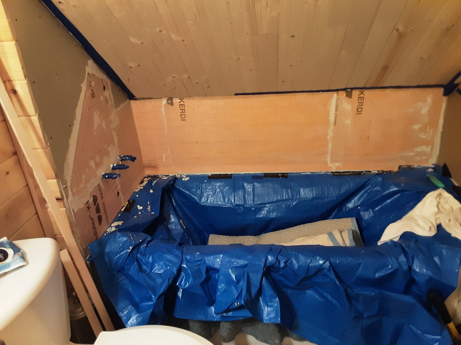

    So what did I do on vacation? Spent 5 weeks at my youngest daughters cabin in Northern MN. First built gates to keep the dogs on the deck.
    Then tore out the vinyl tile around the tub and installed ceramic tile.

    Not much progress to report. Weather has been terrible, hot, rainy and humid. I can only work comfortably for a couple of hours in the morning and I have been trying to catchup on 6 weeks of missed yardwork.
    Rained this morning so could not work in the yard and I got the pusher fan and relay wired. Didn't take any pictures since I need to get the wire braid on the wiring to make it look pretty.
