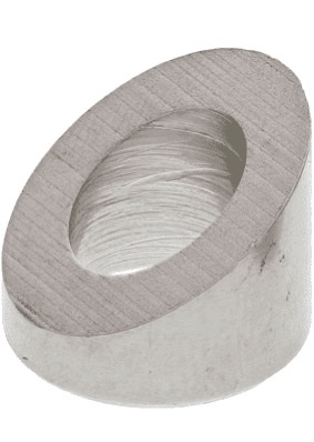

    Project for this week was to get the rear shocks mounted. Made a dummy shock out of 2/2 wood after figuring the 2/3 position on the shock.
    Had to make wedges to account for the ladder bar mount that is angled. I may redo these with thick wall tubing and cut an angle with a cutoff disk.

    Remade the wedges using two pieces of thick wall tubing welded together with a washer and then welded to the ladder bar bracket.
