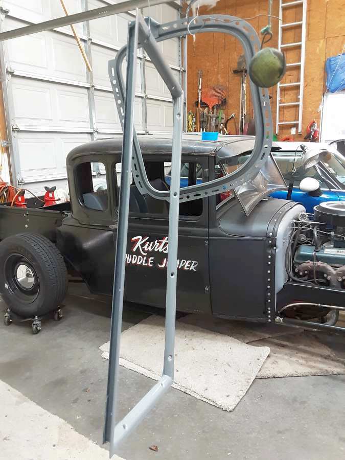

    Thanks Altheb*** for the kind words. Trying to keep busy to stay alive. The consensus of the HAMB and the Bionic Woman (my wife) is to not chop it. I wanted to do a 3 inch chop. Another HAMBer did a photoshop chop.
    Using existing gl*** so no $$$ being expended there. Been busy with other projects so not much done this week. I usually dedicate Saturday morning to work on Kurt while listening to Lynne Warfel's Saturday Movie Music program on MPR. I got sidetracked this week with another Bionic Woman project of making up a box to hold bells for some form of Christmas decoration. Spent the whole morning on that.

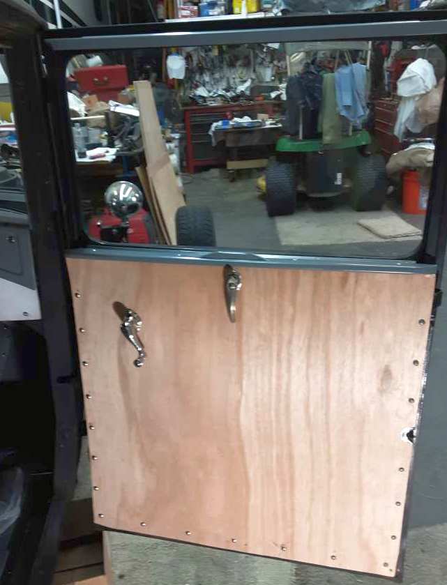

    Got a sheet of 1/8 inch plywood to make door panels. Have vinyl coming Tuesday to cover them.
    I though I ordered new inside door handles when I ordered the other door parts but somehow missed them. Ordered them yesterday. Think I need some type of door pull or handle to close the door from the inside when the window is up. Suggestions?

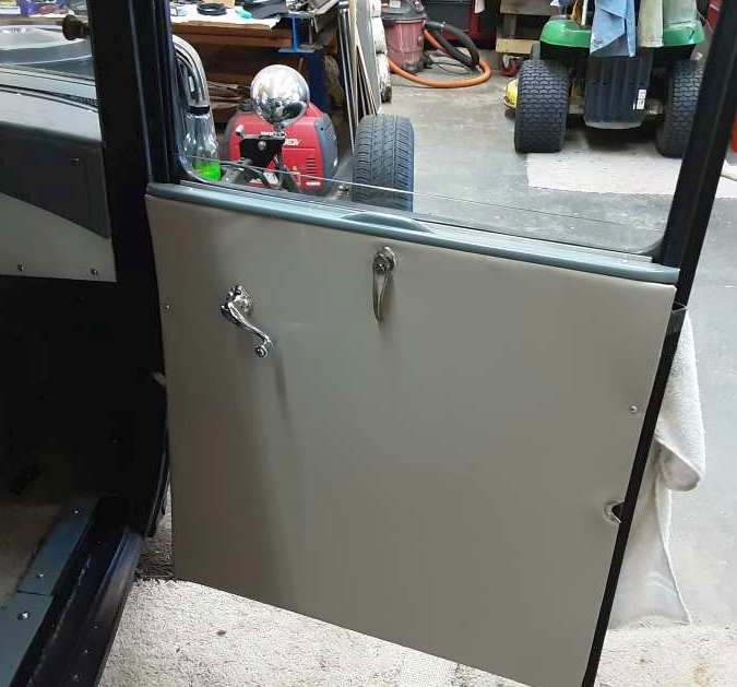

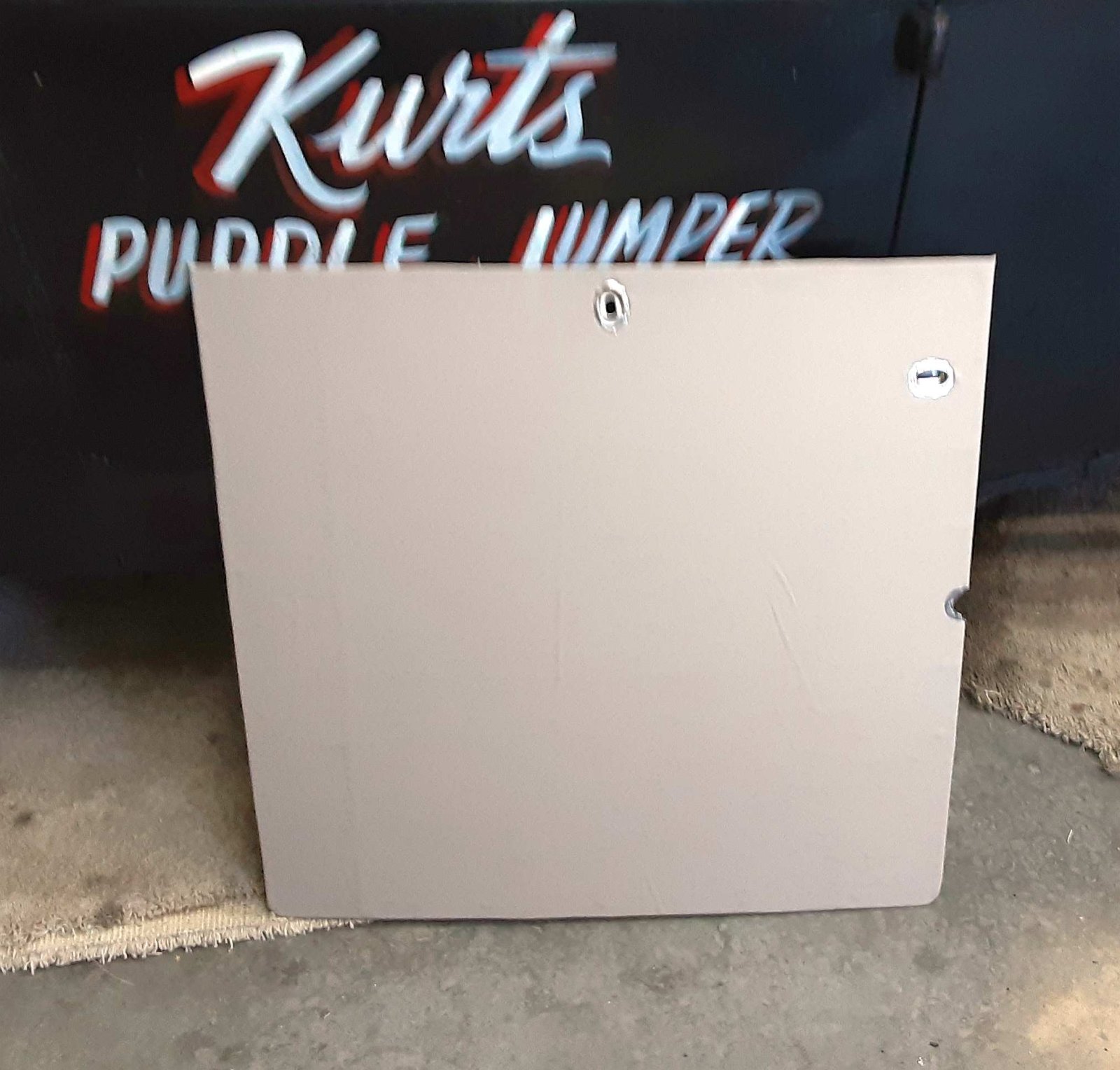

    Redid the driver's door panel. Was able to salvage the plywood. Door panel now has vinyl on both inside and outside. Got vinyl glued up on windlace and installed.
    989 021824 Driver's side door panel complete.jpg 990 021824 Driver's door panel completed.jpg
    Jrs50, Okie Pete, brEad and 2 others like this.

    A bit behind on posting. Raining so I don't want to head to the garage right now. Got the p*** door panel finished and installed.

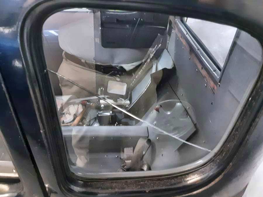

    Didn't get to work on Kurt for a few days with spring yard cleanup projects. Was walking in garage getting a flat shovel and heard a load "crack" sound. I wondered what that was? Walked back around Kurt and saw this Oh Sh$% minute. Must have tightened down to hard on the screws on the front trim piece.

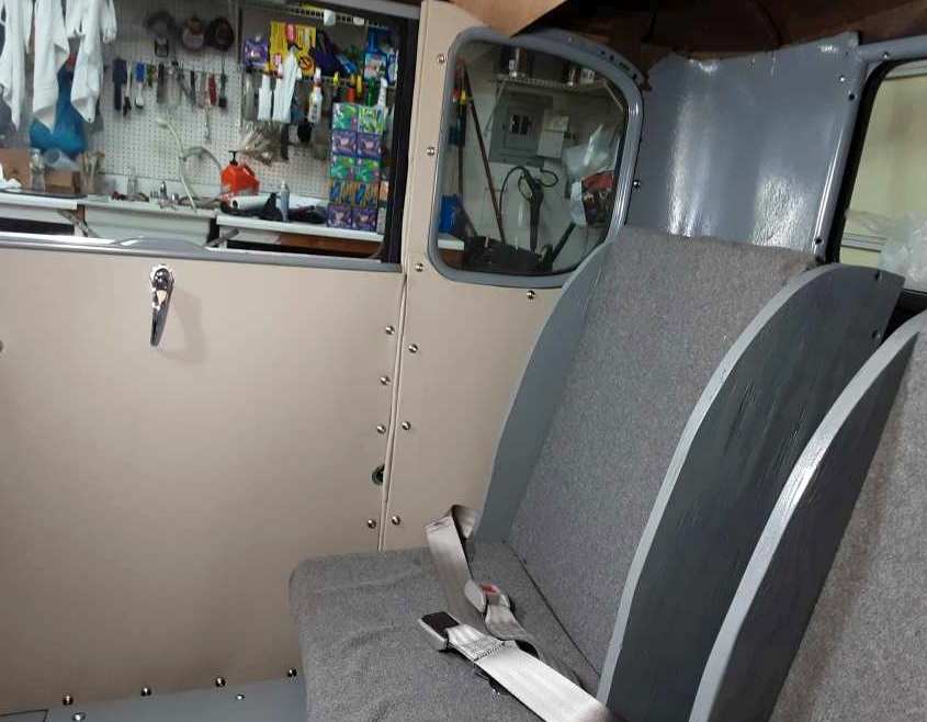

    Got the p*** side interior quarter panel with windlace done.
    Sat the seats back in to see what it will look like.

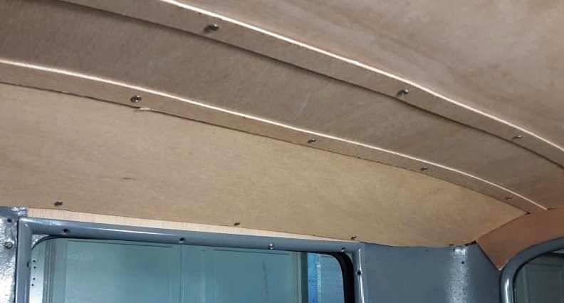

    Got all but the rear panel of the headliner fitted and ready to cover with vinyl. The rear panel I need to bend. Not sure what I'm going to do yet in the corners.
    Outback, Jrs50, brEad and 1 other person like this.

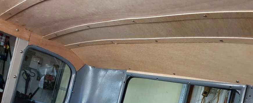

    Taking longer than expected to install headliner. Did not allow enough gap for 2 thicknesses of vinyl. Have had to peel back, trim, and reglue to fit. I'm also getting ahead of myself. Need to reinstall the left rear quarter window gl*** before I go further so I don't have to take things apart again. Phineas the Perfectionist is not proud of how it looks. I have to keep reminding him that it is a 94 year old truck and not meant to be a show car.
