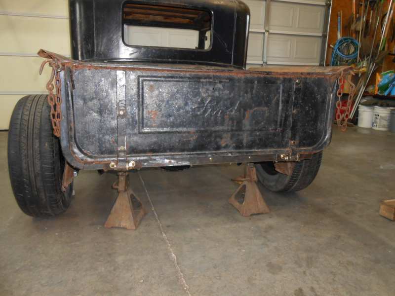

    I don’t have room to mount the bed over any frame, so I decided to hang it from a couple of 2 x 2 frame extension rails. Its never going to carry much anyhow.
    Got it just about to the right height. A little more adjustment.

    Not much to show for a full weeks work. Got pickup bed mounting done. Need to get some 1 ½ square tube to space it down correctly. Bed is mounted with 8 bolts of 3/8 by 8 inches. Need to order some grade 8 as local TS stops at 6 inches for grade 8.
    284 121017 Bed mounted in final position DSCN1613.JPG 281 120817 Bed mounting.JPG 280 120817 Bed mounted in final position.JPG

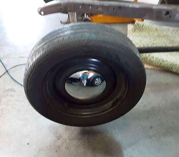

    Finally, installed the wheel, tire, and hubcap. Have had the hubcaps for 3-4 years but they would not fit on the wheels with the old Model A hubs.
    One side finished. Had to mow the lawn, so right side in a few days.
