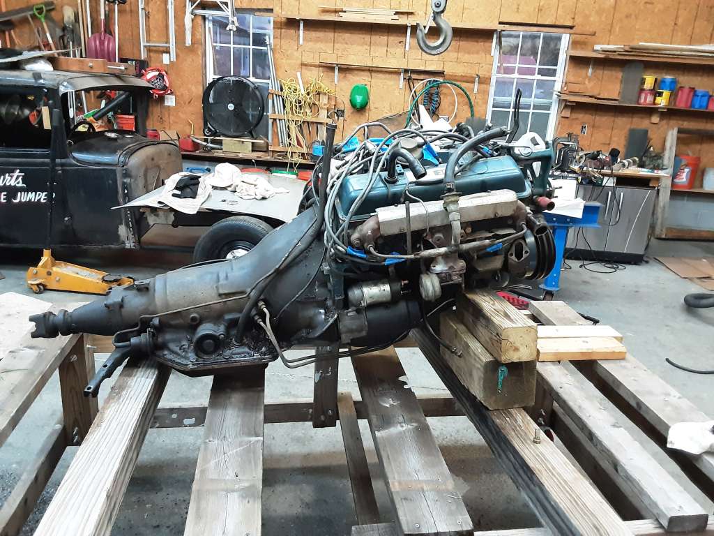

    Had not run for 11 years so spent a day getting it running before pulling the donor engine and transmission.
    361 101320 Donor engine and trans out on body cart.jpg 361 101320 Donor engine and trans out on body cart.jpg

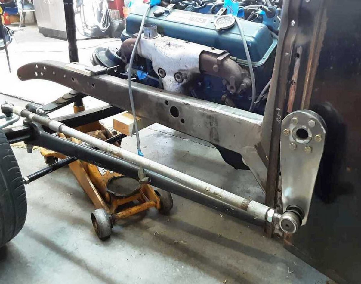

    Being cheap, I built a mount for the steering column rather then buy one. Not bad for using a drill press, hole saws, and an angle grinder with a cutoff wheel, but at my age, I decided I should not invest $$$ in tools.

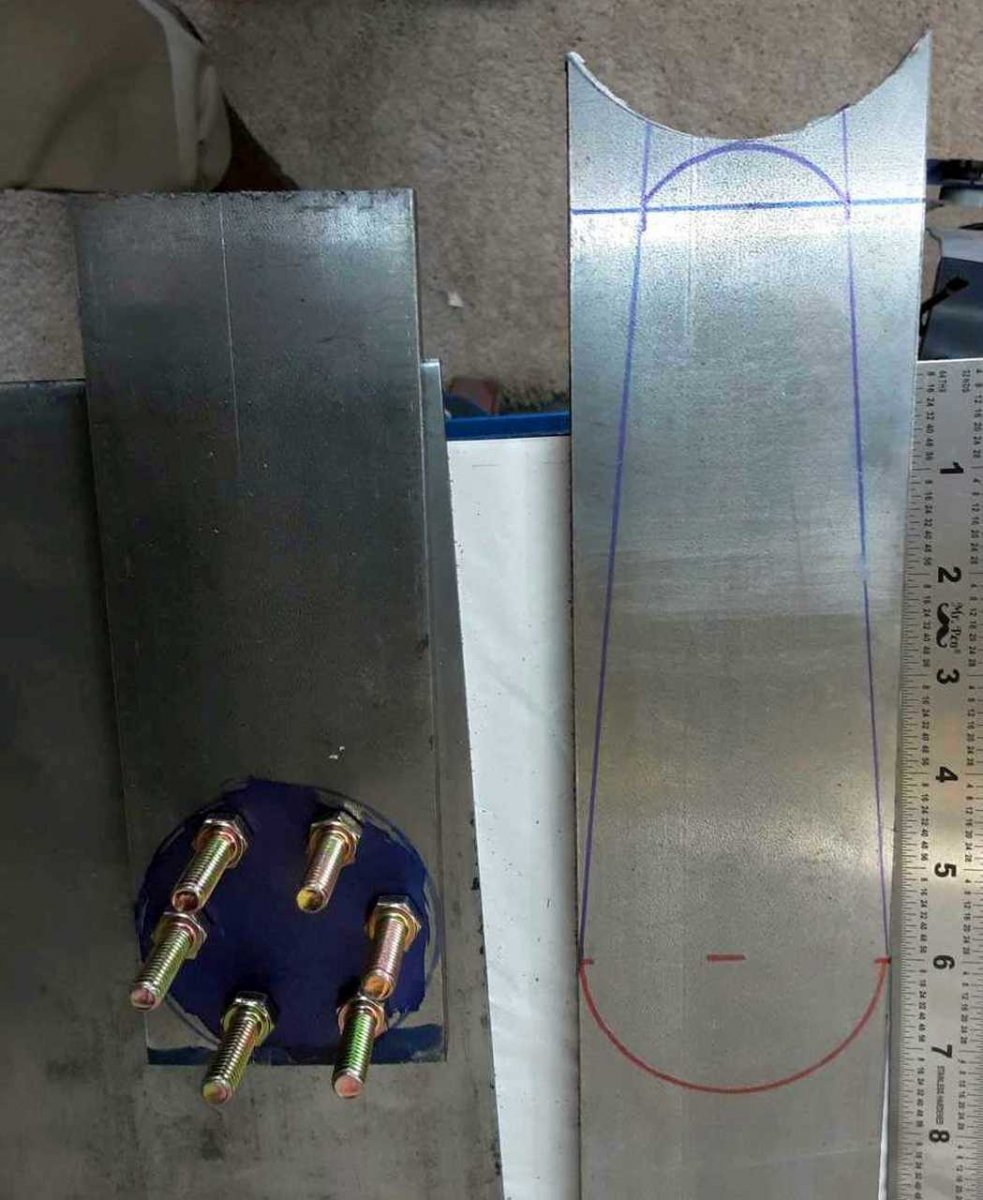

    392 112620 Begin layout steering arm.jpg 393 112620 Steering arm Drilled and tapped.jpg 395 112820 Steering arm shapped and temp fit.jpg 396 112820 Steering arm shapped and temp fit.jpg
    Next up was to manufacture a steering arm for the cowl steering. Again, not bad for using a drill press, hole saws, angle grinder with a cutoff wheel, and tap. Still needs a bit more grinding to finish it off. Can now measure to order the drag link tube.

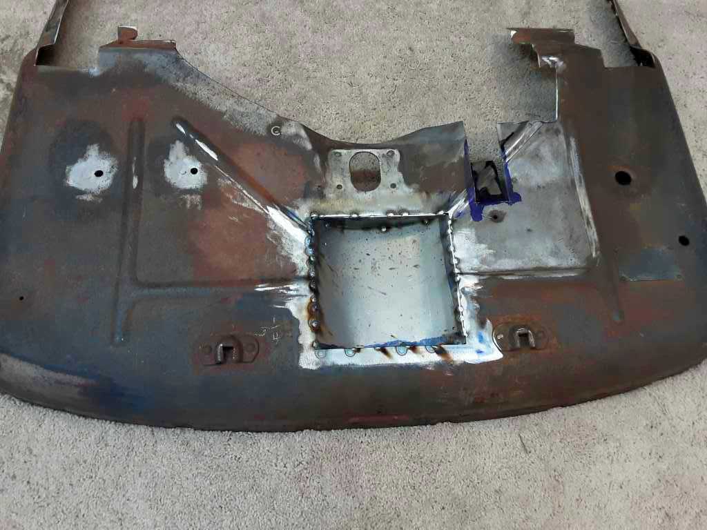

    Worked all week getting the engine in final position. Decided I needed to move it back to have room in front for a fan. Had to notch the firewall for room for the distributor. Hand rolled the insert around my argon tank.
    402 121120 Notched firewall for distributor.jpg 404 121120 Notched firewall for distributor - need to grind inside angle.jpg
    I don't think I did too bad for welding 16 gauge metal. Need to do some more grinding on the inside edges. Anyone have a tricks for cleaning up these welds?
    Not that you can really see the welds very much behind the distributor. Now I have to get back to making the engine and trans mounts.

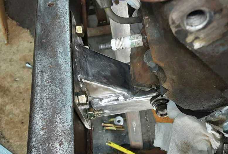

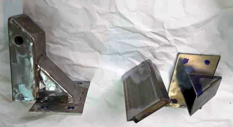

    Been working on building side motor mounts. Could probably have bought some easier, but what's the fun in that.
    Not proud of my welds. Need to get back into practice. 410 011421 First side motor mount done, pieces cut for 2nd.jpg 411 011421 Pass side motor mount installed.jpg
    Got passenger side done and parts cutout for drivers side. Need to get some 2 1/4 inch grade 8 bolts. 2 inches is too short, and 2 1/2 is too long.

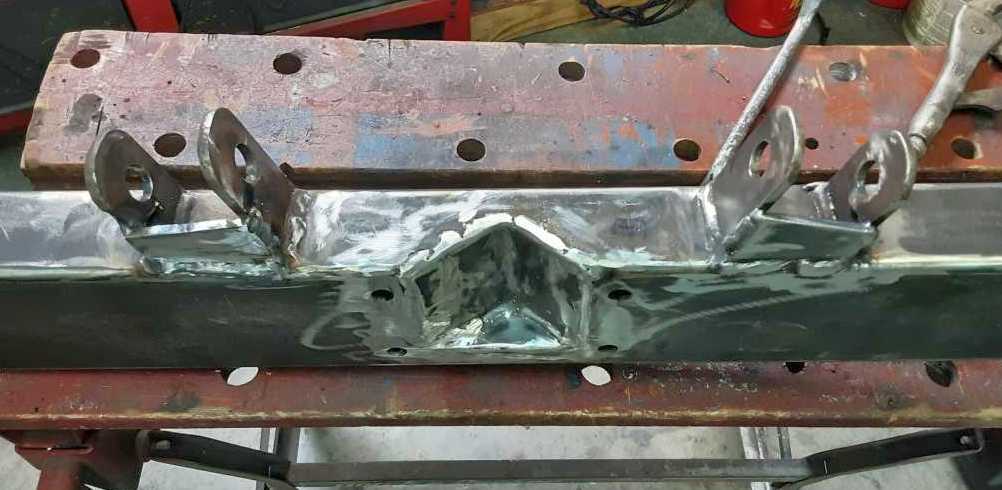

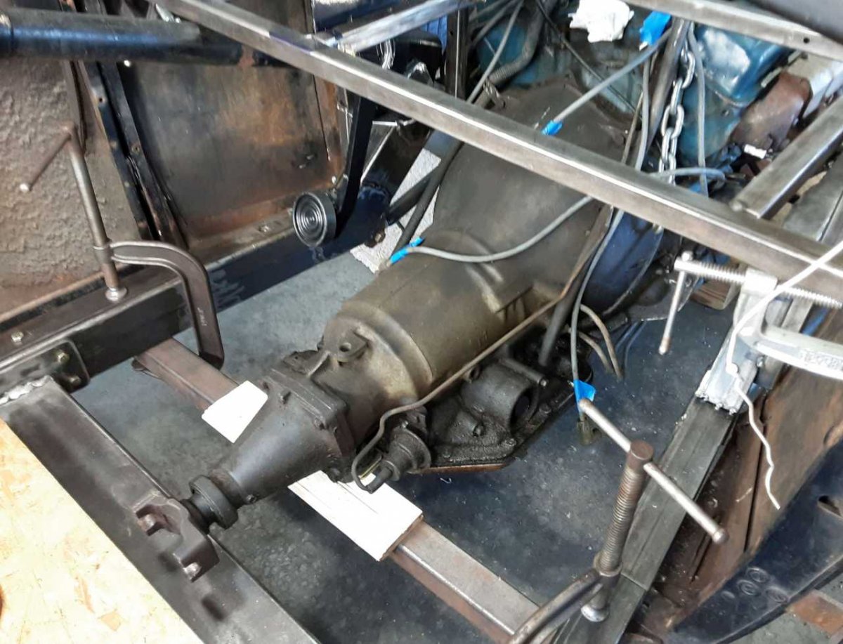

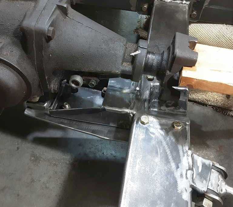

    Took way to long, but got transmission mount built and installed. Decided to notch the back side of the crossmember for some more u-joint clearance. 416 012221 Transmission mount ready to weld to crossmember.jpg
    417 012221 Ccrossmember notched for ujoint clearance.jpg 418 012221 Transmission mount & crossmember ready to reinstall.jpg 419 012221 Transmission mount installed.jpg
    Installed a wooden driveshaft, LOL. Just to help see clearance needed for building floor. 421 012221 Wooden driveshaft.jpg

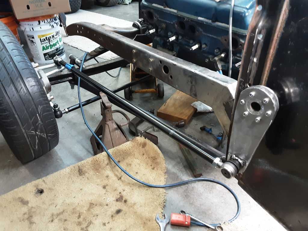

    It Steers! Been working this week finishing up steering. Got sidetracked for a day and a half with battery problems in the OT stablemate of the Model A. Replaced the battery 10 days ago and wife tried to start it and its dead. Spent a day searching for a parasitic drain before deciding to replace the battery again. So far, so good.
    New smaller steering wheel give clearance getting in and out. Not sure if I will shorten the steering column somemore or not.
    Still need to finish welding bung in steering arm. Will not install safety wire on the bolts on steering arm until after teardown and painting.
    I'm not sure if I'm just lucky or I planned perfectly, but wheels turned to full stop have 1/16 inch clearance from tire to drag link. These are just rollaround tires, so final tires may be narrower. Also, steering arm and tie rod end just clear the cowl sheet metal at full stop.

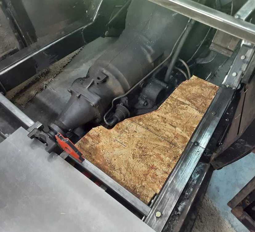

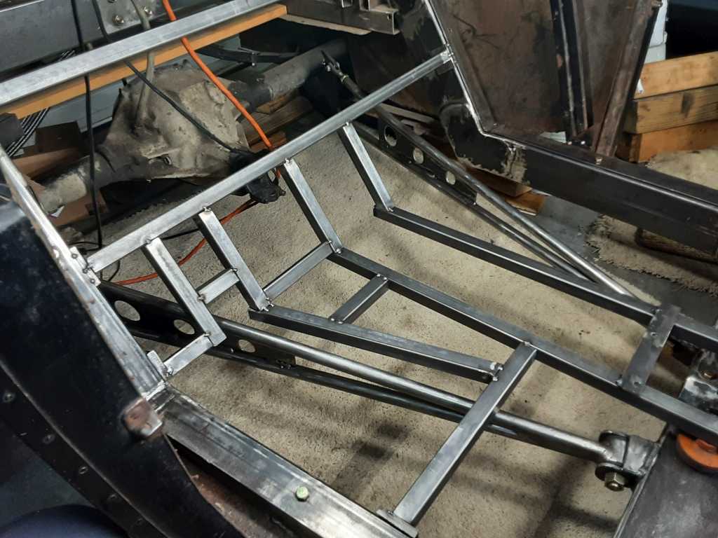

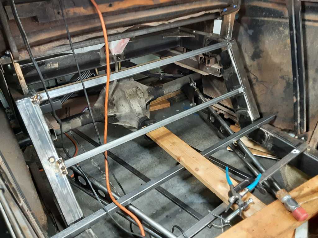

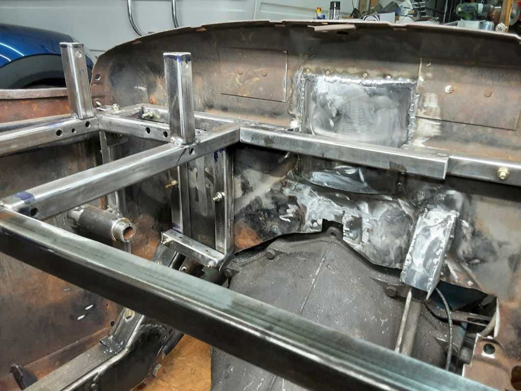

    Worked this week on framework to hold the floor and rear bulkhead. Some will say it is overkill, but since there was nothing between the frame rails left of the body, and the ladder bars stickup to high, the floor is really suspended from the middle bulkhead support.
    Just tack welding everything together for now till it is all fitted.

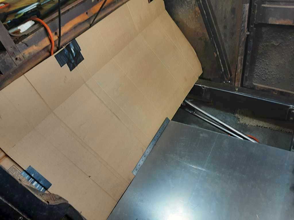

    Cutout templates for the bulkhead and front floor. Front floor will be dropped about an inch to increase foot room.
    Time for a question. I have sheets of 2 feet by 4 feet 16 GA. The bulkhead is 50 inches wide if extended against the inside of the quarter panels. How do others usually seal off the ends of the bulkhead?
    I could fit a wing on each side to the inside of the quarter panel and overlap the large bulkhead sheet an inch of 2 and then use aluminum sticky tape to seal to the quarter panel.
    Picked up some steel Friday to cobble together a sheet metal brake to bend the bulkhead and floor pieces. Will post pictures when I get it together.

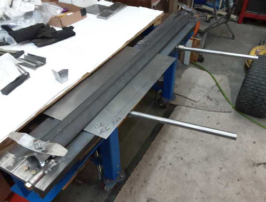

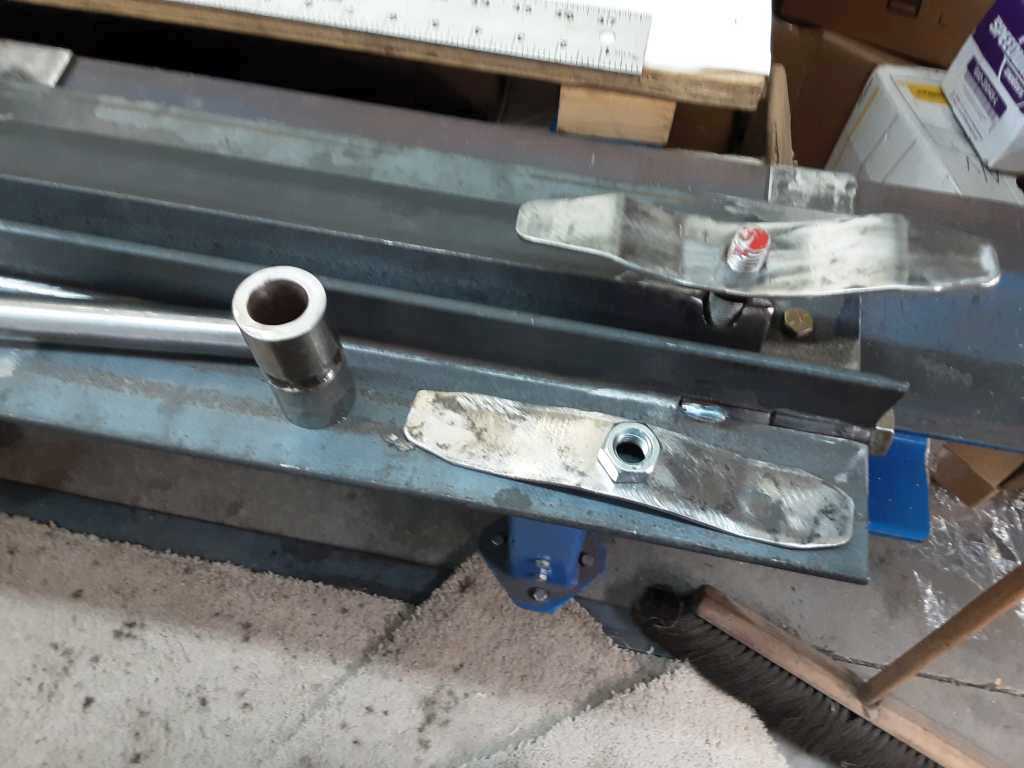

    Some progress on sheet metal brake. Got steel cut to size yesterday and started drilling holes. Had to dig out my old cheap portable drill press to drill the holes in the I beam of my work table (made from half of my frame table). Heavy duty table makes a good mount for the brake.
    Next need to cut the slots for the hinge tubes (one marked out on left of previous pic).
    Have to weld up some big wingnuts and sharpen the bottom edge of the clamp. Can't forget to build some arms. All that will have to wait till Tuesday. Have to take the bionic woman in for a lube and oil change tomorrow (just normal maint.).
    chryslerfan55, Jrs50, brEad and 2 others like this.

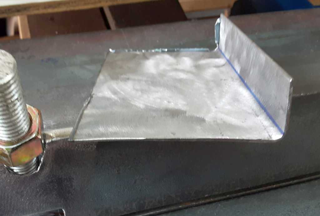

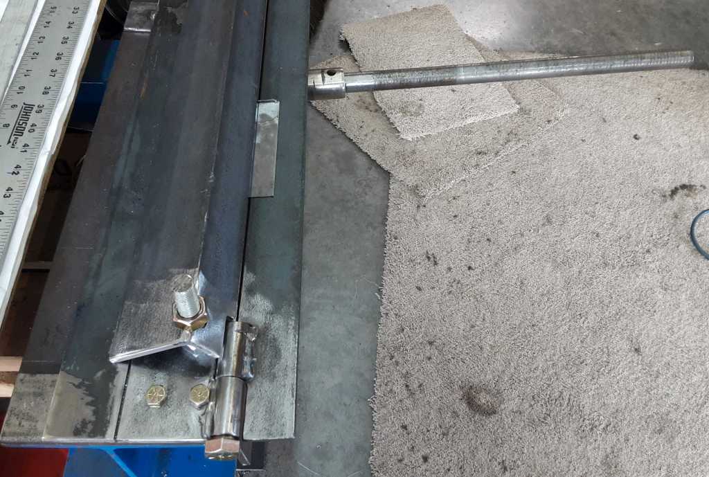

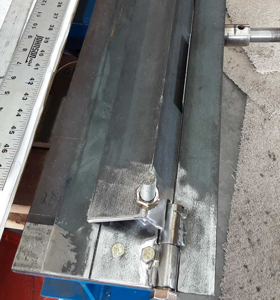

    Took both Tuesday and Weds, but slots cut and hinges welded on.
    After tack welding hinges, brake turned just fine. After half final welding them I had trouble getting it to swing down to horizontal, just 5-10 degrees shy. Ground, ground, ground for a couple of hours getting clearance and now works fine.

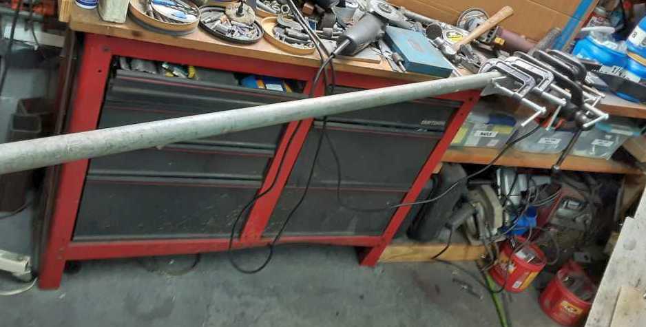

    Found some old heavy tubing from an old tow bar with a 7/8 inch ID and some 7/8 OD tubing to make handles. Caliper says both 7/8, but took an hour grinding and sanding to get the one to slip into the other. Have to do the second handle tomorrow. Setup a piece of scrap 16 GA for a test run.
    Not a very sharp bend, but good enough for what I need and I have not yet ground the clamp bar edge flat yet.
    Goal for tomorrow is finish the 2nd handle, weld up big wingnuts, and grind the clamp edge flat.

    The sheet metal brake looks nice and stout. Are you going to add any additional support to the clamping angle iron?
  25. rgclouse
    Joined: Apr 30, 2014
    Posts: 366
    rgclouse

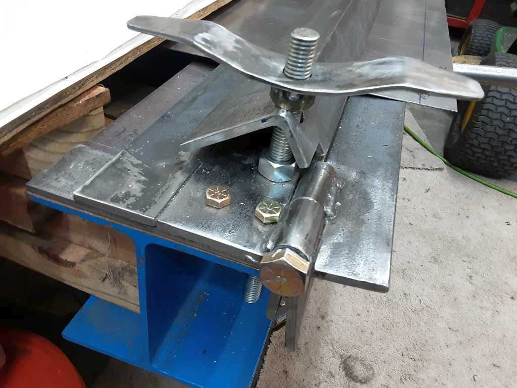

    Goals for today accomplished. brEad, short answer is yes, see later in post.
    Second handle and wingnuts completed.
    440 021121 Large wing nuts and 2nd handle ready to weld.jpg 442 021121 Wingnut detail - setup for first real bend.jpg
    Ground lower edges of clamp down a bit. Can still grind some more. Setup and tried first real bend.
    Result. Did not want a 90 degree, but angle on gauge. Pretty close.
    I will have to add reinforcement to the clamp angle. Got deflection on the far side of the sheet, but not enough to ruin the sheet. I have seen reinforcement inside the angle and with a truss on top with an adjustment bolt. Will have to get some more steel. I seem to have plenty of short pieces, but not 4 foot or larger pieces.
    I realized I never said why I made the brake 4 foot wide. I have a few 4 foot sheets I want to bend. After those are done, I may shorten the brake.

    Got truss cut and tacked in place.
    Truss would have been much easier to bend if I was too cheap to invest in a torch. $200 for a torch I can handle, but $800 for tanks is ridiculous. Had to breakout my long arm. A 6 foot length of pipe that I slip over the end of a breaker bar for really stubborn bolts.
    Closeup
    Also made up some depth adjusters for the clamp. Need to get some 7/16-20 bolts and nuts.

    Short day today. Cut some angle out of scrape 2 inch square tubing to reinforce the clamp bar. Taking the rest of the weekend off to watch racing at Daytona on TV.
