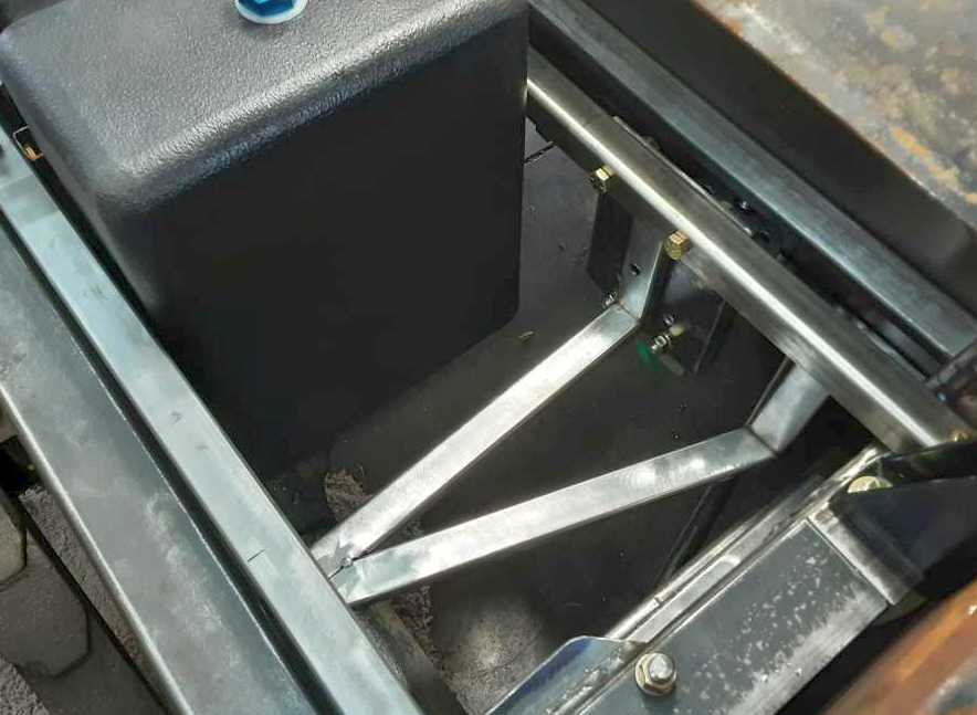

    Finished the reinforcement of the clamp bar. Truss welded in place and reinforcement angle welded inside. Seems much stiffer. May have to put a truss on the front moving angle as I can see it deflecting now.
    Tomorrow back to work on the Model A and use the brake for real.

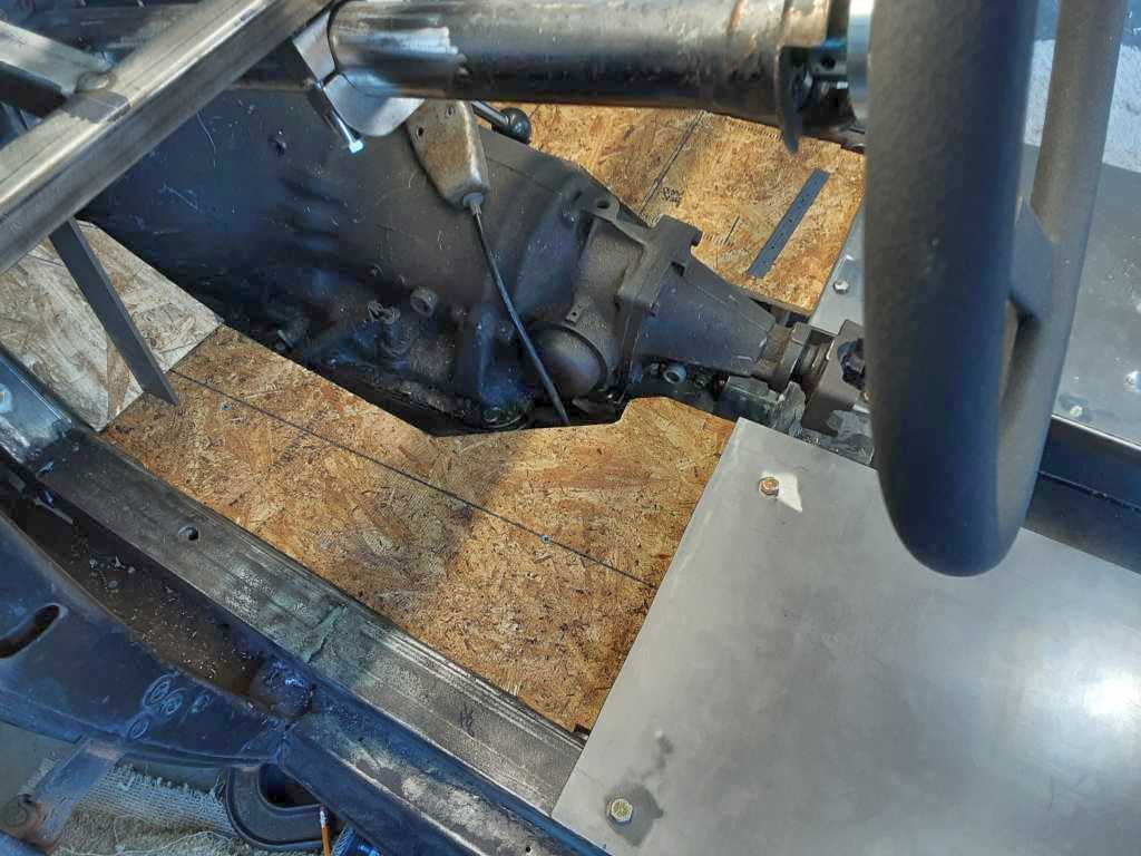

    Finished the p***enger side and cut and fitted the drivers side.
    Bolt head are for body mount bolts. Need to get some round top socket type screws but the one toward the transmission is 5 inches long and I can't find ones that long. The rest is screwed down with stainless screws I have had for over 20 years since I rebuilt the compartments on a MH.
    Got templates made for front drivers and p***enger side. Hope to work on them tomorrow.

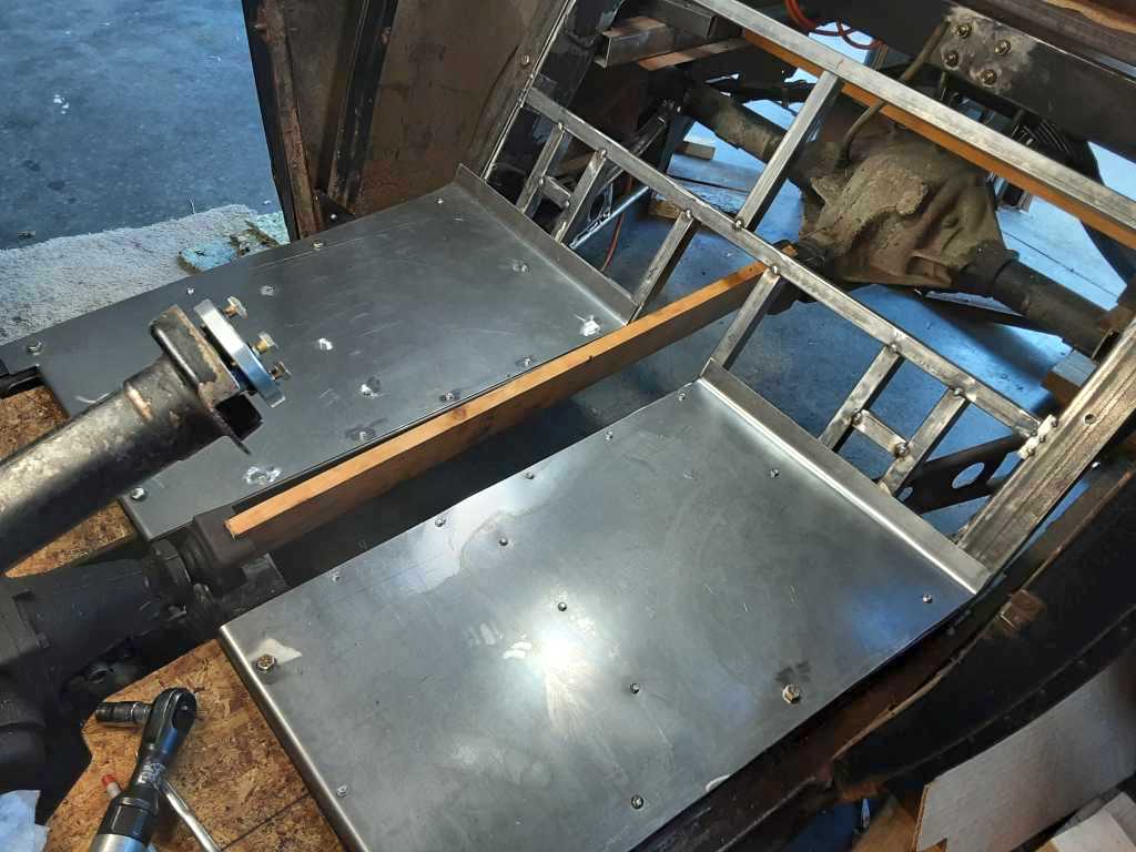

    Got the drivers side rear floor completed. Really nice weather today, sunny and 70, so had to do a few chores outside. Nice to work in the garage with the doors open and heat off. 68-70 in the garage. Perfect!
    Found McMaster Carr has 5 inch Hex Drive ****on Head Screws. Got template ready to cut bulkhead center panel tomorrow.

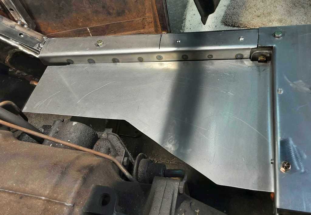

    Got the 2 pieces of floor cut and fitted from the templates I made yesterday. Still need to attach them together and to the firewall.
    Had to layout where to drill the 3 holes in these pieces. I knew trying to measure and mark would end up off a 1/16th or so. Made a homemade "marking point" by cutting the head of a 3/8 bolt and grinding a point.

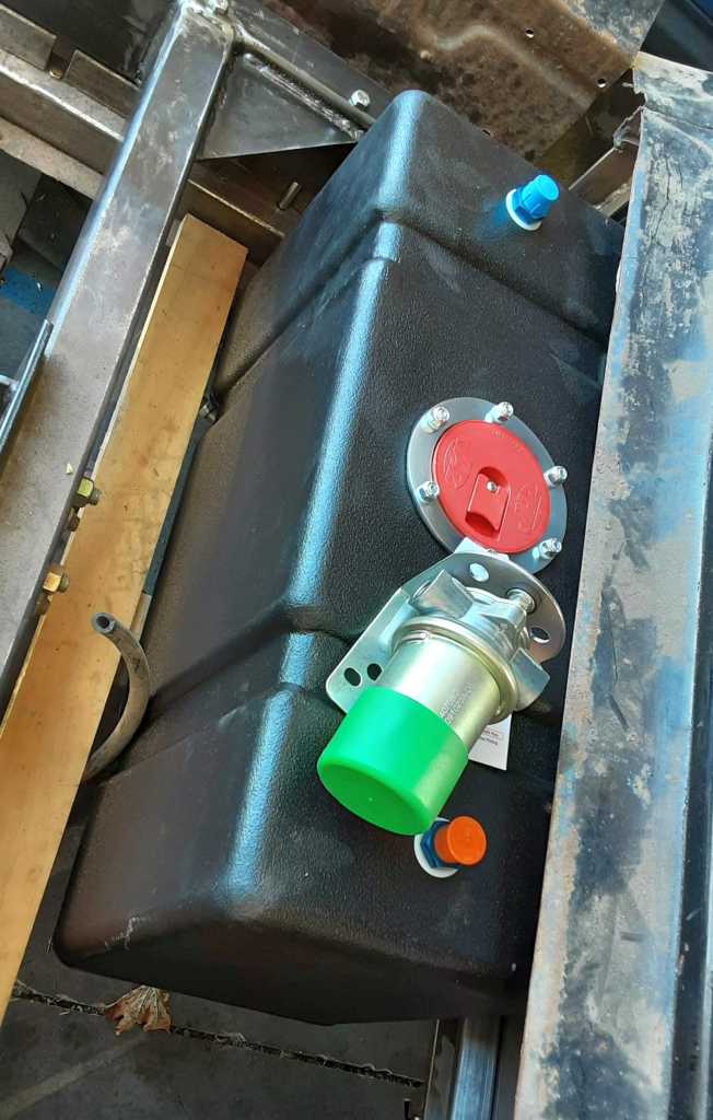

    Well I got the generator back together and reinstalled, but then had a bunch of Spring chores before I could get back to work on the A.
    BEGIN RANT: I can't believe how difficult fixing the generator was. I don't think they thought about ever having to service it either when it was designed or when it was installed in the MH. It either had to be dropped down 6-8 inches before it could be moved sideways to remove it or you had to cut the compartment framing (as I did) to slide it out level. You could not drop it even if you had a trans jack because the full width mudflap frame was WELDED in place about 4 inches below the generator. I had to remove the mudflap to have room for my cart. Bolted it back on.
    Oh well, it went 17 years without ever being removed. It ended up to be the rubber coupler on the engine pulley. The belt was worn but intact, but I replaced it while apart. END RANT!
    Got to work on the fuel tank mount. Decided to adjust the rear spring mount to raise the back end about 1.5 inches. Gives it a better stance and made more clearance under the tank. I had made the mount adjustable when I build it, but had it a the lowest setting. Sorry, no picture yet of the improved stance.
    I had to cleanup a bunch of rust on the bed mounting frame. I guess I forgot to Gibbs, Gibbs, Gibbs three years ago when I mounted the bed. Also didn't think I would not have torn it apart and painted everything by now.
    Got the tank mounted and hold down straps fitted. Next up is a battery box beside the tank and mounting the fuel pump.
