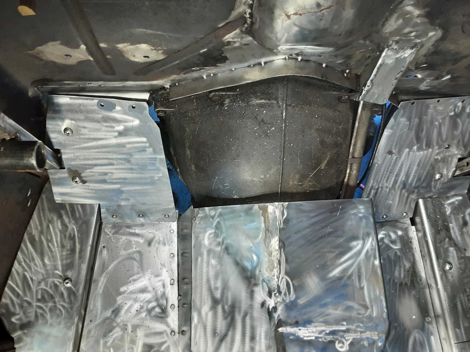

  5. rgclouse
    Joined: Apr 30, 2014
    Posts: 366
    rgclouse
    Thanks JRS50 for the encouragement. That's exactly what I have been trying to do, work on it 2-4 hours a day. I just can't believe how much time I'm spending on the transmission tunnel.
    Practicing my s***ch welding techniques in preparation on doing some bodywork repairs. S***ch welding 16GA seems to be going pretty good. One more p*** to go. Cut first template to fill in the gap to the firewall.

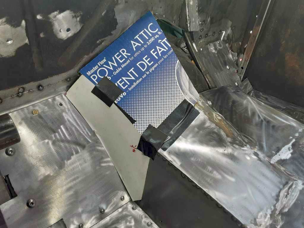

    Got some work done on the firewall to floor connection. Started CAD work on filling the gap.

    Back on topic, got a couple of gap fill pieces cut. Had to quit because I need to weld and I can't see. Helmet fogs up with the 100% humidity. I will either splice together 2 pieces of 16ga or go to Tractor Supply and pay $19.99 for a 12x24 piece.

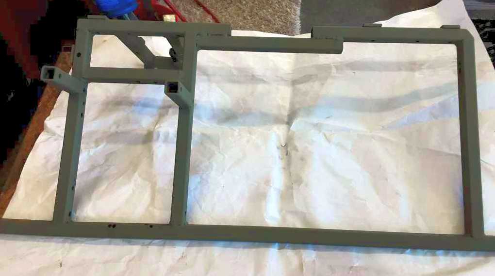

    I was feeling real great about progress this week till I read what I posted for the goals for the week. Transmission tunnel is done, primed, painted, but NOT back in car.
    First, underdash framework now has a much more pleasing color.
