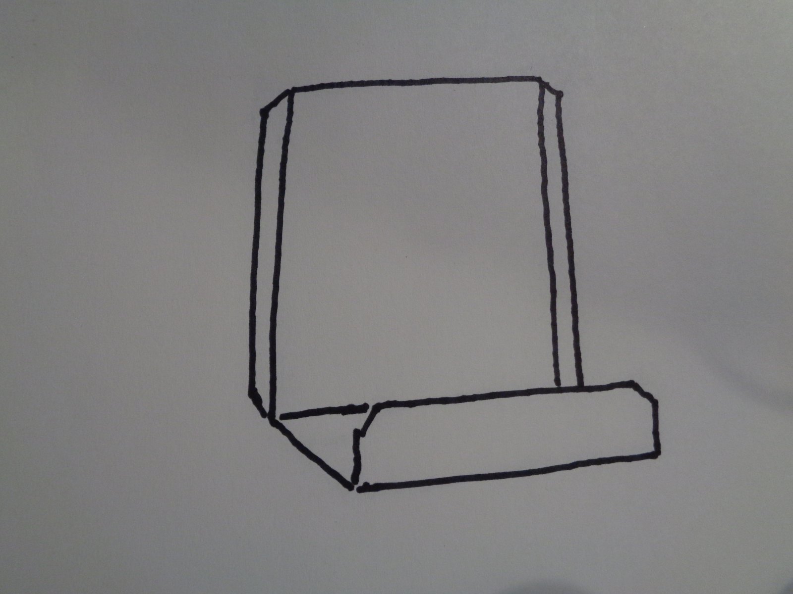

    A complication I need to address is my boxing plates where notched around the lip on the rear of the crossmember. I need cut that part out.
    You can see the one remaining rivet on the driver's side on the right.

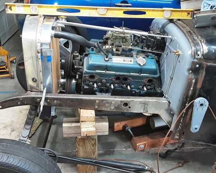

    Got the spring back clamped down and it sitting on its wheels. Tack welded the temp brackets on and sliced, diced, and tack welded the rear of the crossmember.
    Looks pretty level to the naked eye. A level on the frame and on the cowl to radiator seems to say the same thing.
    Just a little forward rake on both.
    Picture of the front of radiator clearance and the tack welded rear of crossmember.
    Hard to see but 1/4 inch clearance. Think I may move radiator back another 1/8-1/4 inch.
    Rear clearance is still good.
    I think I like it the way it is. Hurry and chime in if you don't like it. Should the top of the grill shell be level with the cowl or slightly lower? ????????????????

    A possible solution for both problems. Make a bracket to bolt to the existing tab on the radiator. A piece of your 16 ga. should do it.

    Well, the consensus was it needed to be a bit lower (me and one other in the radiator thread). So here it is a bit over an inch lower. Level says it is about 1 inch lower then the cowl. Will come up 1/4 since it is sitting metal to metal and it will have a 1/4 inch rubber pad.
    With level
    Without level
    Made up one of the support rods. A 5/16 coupler drilled out and welded on the support. Then a piece of threaded rod. Cut a small aluminum plate to bolt to the radiator so the steel threaded rod is not touching the aluminum radiator. I know I bought two 5/16 couplers but can't find the other.

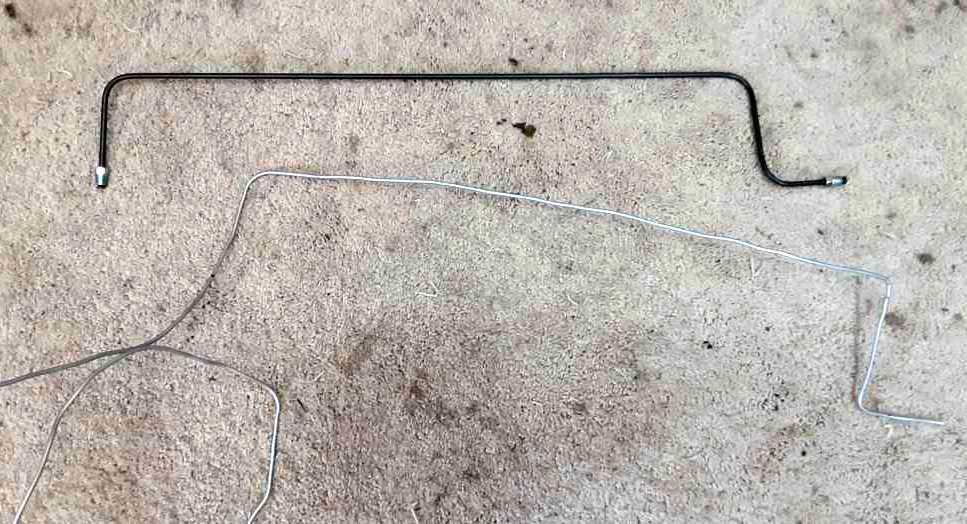

    Yesterday and today I worked on redoing the front brakelines. I made a template with some aluminum wire I have had for over 20 years. Don't know where I got it. I used to use it a a snake.
    I had to get a piece of straight 3/16th brakeline. This clad line is all the local O'REILLY'S had.
    Line installed in front of radiator. Have not installed the clamps yet.

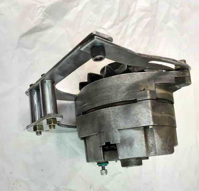

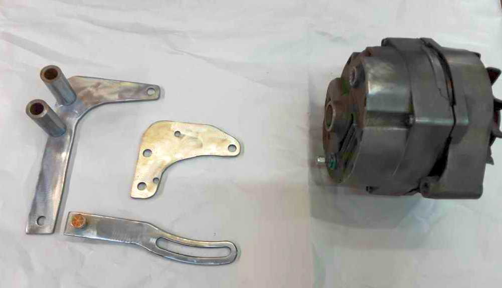

    Close but needed some adjustments.
    Not as pretty as the chrome one Speedway sells, but mounted low, no one will see it.

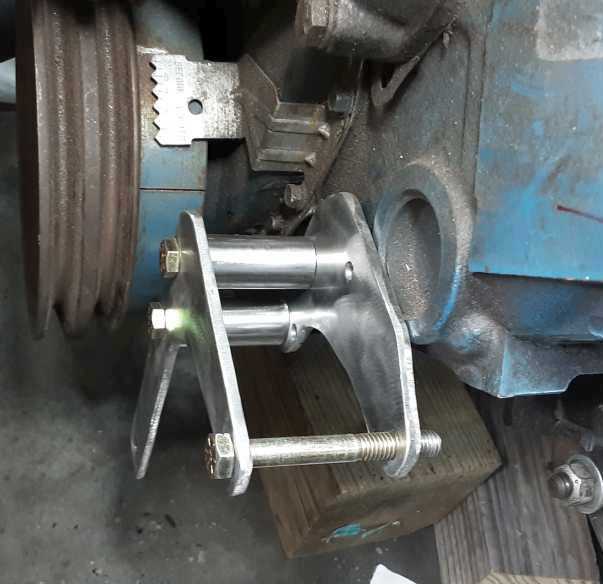

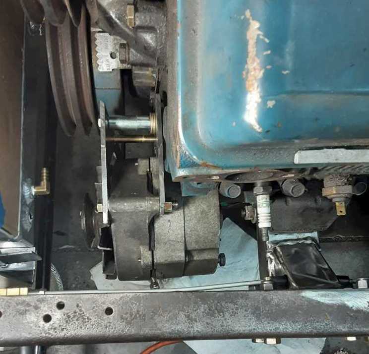

    Installed:

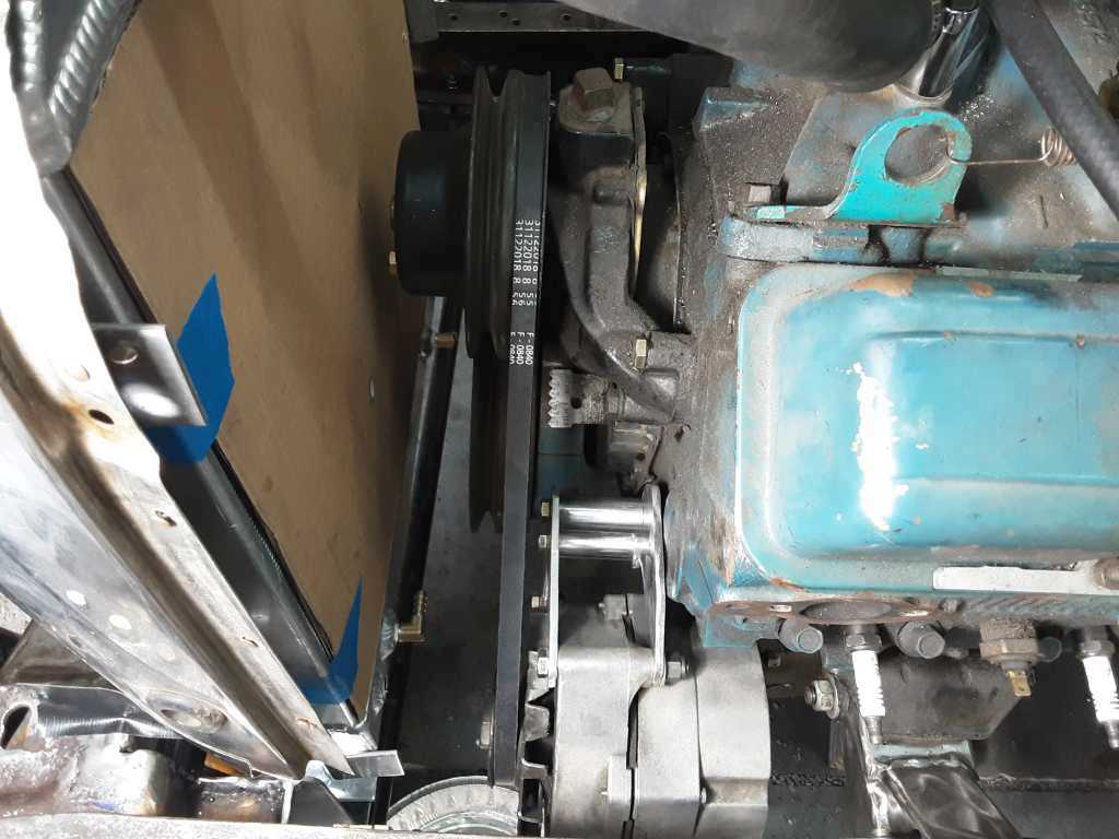

    Alternator installed with 44 inch belt.
    Interesting, to naked eye it looked like perfect alignment but this picture looks like I may have to shim it forward about 1/16th of an inch.

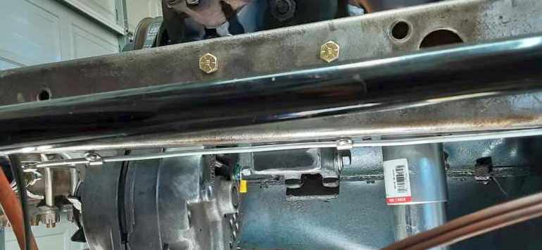

    Well, I thought I had fixed all the brakeline leaks, but overnight the pie pan was half full. I tried again to tighten them but got frustrated. Decided to do something else.
    I need some kind of exhaust system to finish the start phase. I was going to build some lakes style headers but the bionic woman doesn't like the look. So decided to use the original vette exhaust manifolds for now. Got all the airpump holes plugged. Got some flanges that matched and cut up some 2 1/2 to 2 inch reducers to make matching flares.
    Installed manifold and fitted a 90 degree elbow that looks good.
    Only one problem, flange is almost touching brake line.
    Decided to relocate brakeline to under the frame rail. Made a new line in one piece to eliminate the coupler. Had to do it twice as I cut the first try 1.25 inches short. Drilled and tapped holes to install clamps.
    Front line secured as well.

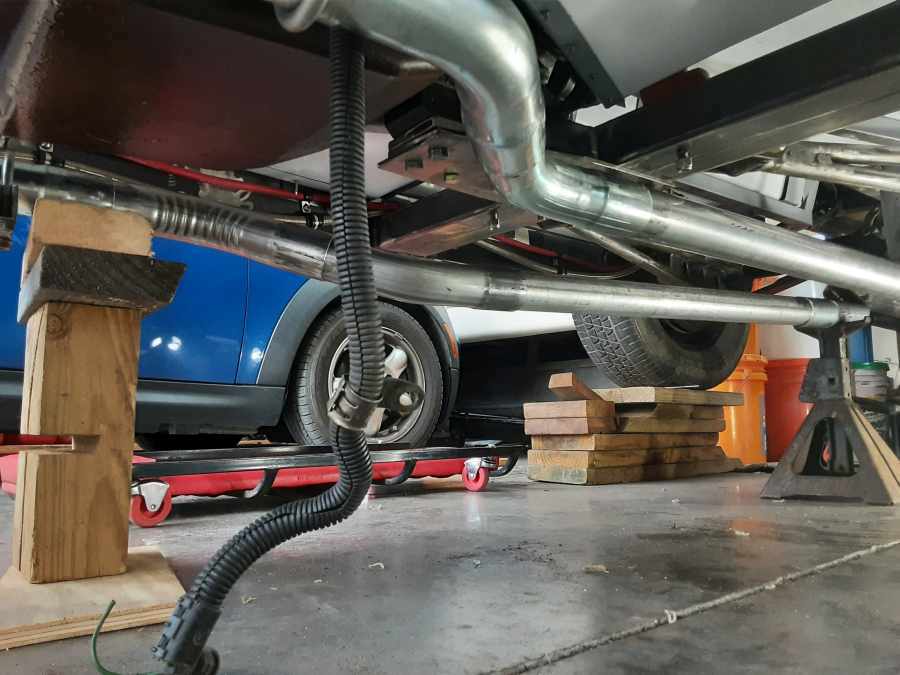

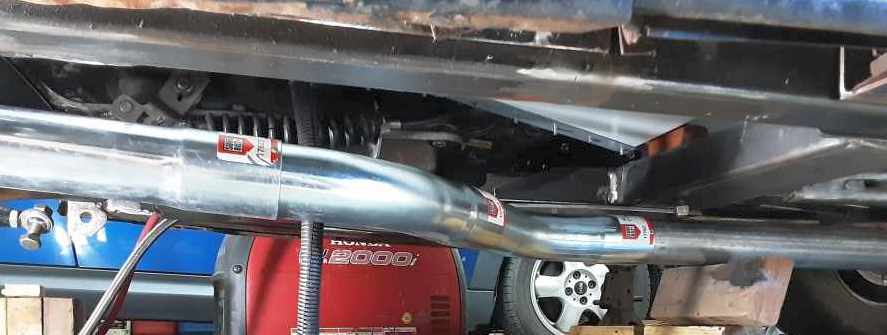

    A couple more pics of the exhaust. Nothing welded yet. I had to route them over toward the center to be inboard of the ladder bars. Need more 45 elbows to move back out around the rear-end pumpkin.
    Original idea was to just put a 18 inch pipe out to the side for startup but got a great deal on 2 8 foot straight pipe sections from Advance Auto Parts with 15% off and free shipping. Had them in 2 days. (I had searched online for exhaust pipe and found them at Advance. Next day they sent an email offering 15% off).
    Will just run the straight pipes out the rear for startup. Will install some gl*** packs for the drive phase.

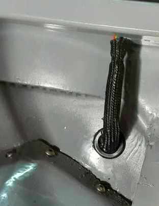

    Got a good 5 hours work in garage today. Again, one 1/2 wide puddle of Brake fluid. Used a level to plumb up to find likely suspect fitting. Managed to tighten it about a 1/16 of a turn. Was dry the rest of the day.
    Got the starter and alternator wired. Have to get some wire loom to dress them up.
    Got drivers side exhaust mocked up all the way to tailgate. Hope to tack Weld and work on hangers in next few days.

    Worked on exhaust off and on for 5 days. All fitted, tacked together, and hangers made. This old body does not like crawling on a cold garage floor. A bit too tall on creeper and wheels get caught in joint between slabs. Easier crawling on big carpet s****s.
    Not easy to take good pictures of exhaust.
    You can see in the last pic I'm missing a clamp at the end of the pipe. Thought I had more, but will have to get some.
    Also need to get some isolators for the intermediate hangers but good enough for getting the engine started. I can't wait to hear how it sounds with the straight pipes. Will hang some gl***packs before I get it driving.

    Three days working on the A and minor progress. Got three hole saw holes in firewall drilled. I had to cut and weld a plug for a larger hole for the throttle linkage.
    Two grommets installed and rewired. Had to take a picture from under dash since you can't see it behind the distributor. 713 011222 First firewall grommet installed.jpg
    Stogy and Dustyp489 like this.
