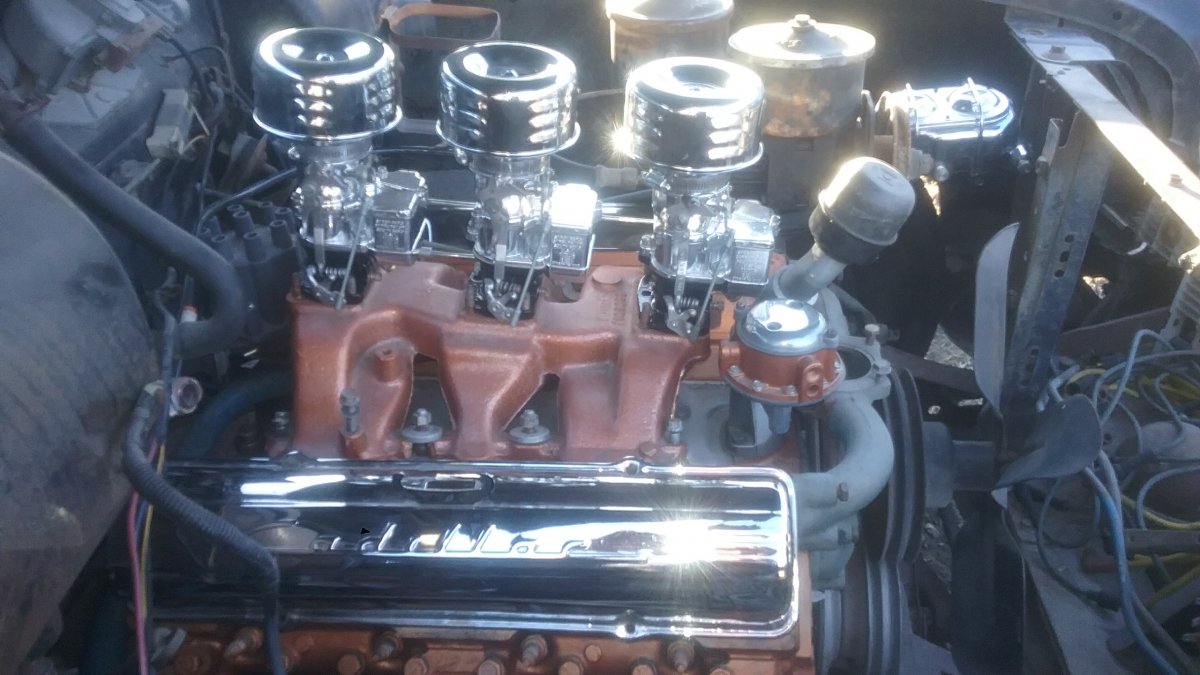

    Just looking for some pointers since I'm new to multi carb setups. I got to read quite a bit of great info here on Tri power setups already but am still yearning for more.
    1956, stock, uncut body, mild custom interior and suspension. Has 1958 caddy 365 with stock auto trans. Has pertronix electronic ignition upgrade.
    I have pieced together a beautiful Tri power set up with a 58 caddy 3x2 intake, a set of chrome stromberg 97s, speedway progressive linkage.
    I am not ready to crank and fire her up just yet... I'm well aware that I need a vacuum signal for my vac advance, my wipers, as well as my brake booster (upgrade to vette booster and mastercyl and p vavle).

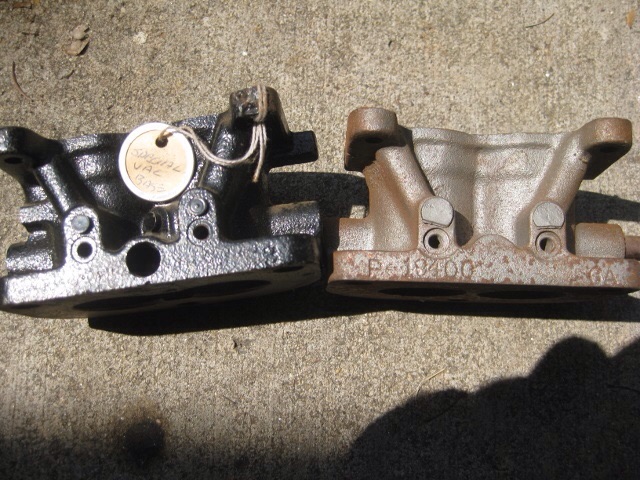

    The 3x2 intake has a boss cast into it that to me, would've been such a vacuum fitting had it have been drilled. I would like to know if I should attempt to drill and tap it, or have someone with more precision equipment do it for me? I've dug around online looking at spacers. I see I can get a set of offenhauser adapters that are approximately 1.5 inches tall, or I can get spacers meant for the Rochester carbs. My stromberg bases were modified to fit the 4 bolt setup before I got them and I see no reason to need the huge offenhauser adapters. Personally, I want to drill the intake boss as I think it will look alot air cleaner than using spacers.
    Has anyone here done a 3 stromberg 97 setup on the old 331/365/390 mills here that may have some more great info?
    Thank you all in advance

    Kinda Strange it doesn't have a provision for a vacuum port on the factory intake,considering the tri power would have been the upgraded engine, hence power brakes... But if you see a spot That would work drilled/tapped, I wouldn't think twice, good Look'n set-up.. Most tap an die Set's have pipe thread tap's for what you need, just figure the Rite drill size, You'll be good ta go, not really that complex

    The original Rochester carbs were tapped for vacuum in the throttle bodies. The center carb for distributor vacuum, the front carb for power brake vacuum source.
    Since your probably way too small 97's don't have this provision, a better way to acquire a vacuum source(s) would be to take a page from Pontiac and Chevrolet, and use a drilled manifold to carburetor stud for vacuum. These are readily available as reproduction items.

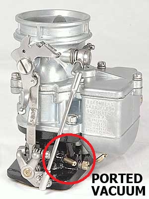

    Stromberg did make a vacuum base on left.

    The new ones do...or can if you order them that way. http://www.stromberg-97.com/

    Thank you all for the advice. I had tought about a spacer with a vacuum port but am starting to worry on hood clearance. I could be being paranoid about that aspect but until I can get a real look at clearance I want to stray away from anything that gets much taller. I honestly have no clue why the caddy intake was never drilled from stock. I can only ***ume it' original rochesters had to have the ports instead. When I heard the engine running with a 4 barrel before I bought it, it did sound like it could have a larger cam. I know it was gone through around 2000 or so and has about 10k on it for miles now. Sounded amazing. My 56 cdv has the upgrade dual quad engine but was long gone when I got the car. I was chasing dual quad intakes on eBay when this bare 3x2 came up. Believe it of not i got it for 125 plus shipping then got an amazing deal on these carbs. I'm doing all I can to keep this car looking as if someone built it in the early 60s. I jumped on the strombergs for looks, I won't lie. They seem so simple to maintain also so that' a huge draw. The carb stud idea above is really cool. I like the idea and didn't know that kind of thing was being done. Where would I find such bolts? If I can't get those I will probably drill the boss and tap it. It' la there for it so I'm not too afraid of it. Thank you so very much again. I truly appreciate it.

    Those hollow studs are freaking awesome!!! I never knew such a thing existed. I mean, from an engineering stand point, I can't believe I hadn't thought of it haha! It's really simple when thinking about it. You all have been great help here. I had read that I may need to go solid linkage and I'm not afraid too. I just figured the progressive was a better idea since I plan to run long road trips. I do have a final question... can the items on the car that need vacuum, the advance, the brake booster, and wipers, all run on same port? I know I should be able to upgrade to electric wiper motor so that's an option too. Weather is supposed to break this next week here so I'm excited. Been building and scavenging for 2 years now and its so close to being mobile I can taste it.

    Thank you so very much guys. I'm going to look into getting those studs and will probably drill drill the boss and tap it. I could use it for brake booster only and use the hollow studs for the others. That not drilled boss is what makes me say it's a 58 intake as those still had tredelvac brakes if I remember right. A 59 tripower most likely had alot of other vacuum robbers haha!

    Just checked the number with that chart and it's definitely a 1958 3x2 :) thank you again for the info. You guys are the best
