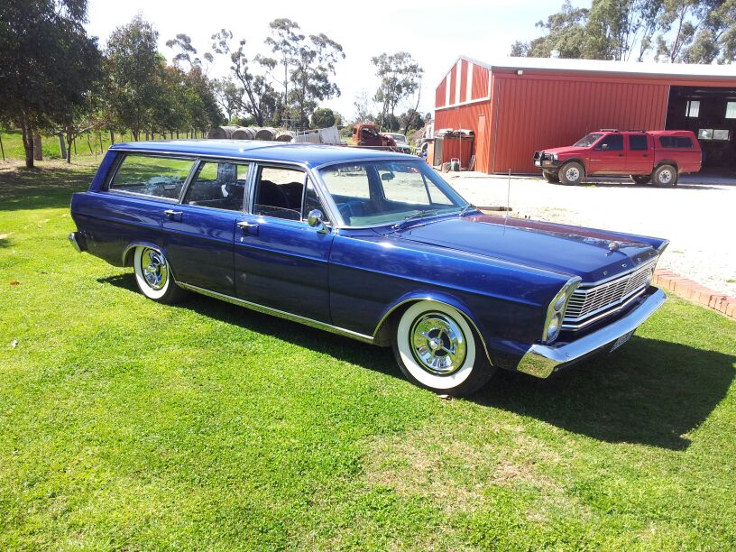

    I put my wife and kids in a 65 Galaxie daily driver a few months ago.

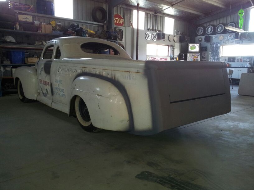

  5. Wardog
    Joined: Jan 12, 2010
    Posts: 2,457
    Wardog
    Koolkemp. I bought it as an unfinnished project that had been past around unfinnished for about 20 or so years. It came to me on what i think was an International truck ch***is. I have put it on a (GM) HQ Holden ute ch***is that I cut the centre out of and fabbed to suit the taper of the 46 rather than the square holden. I pretty much just used the front end, rear step up (which has been extended and stepped down) and ten bolt rear end. I also added 10" to the wheel base when I made the 4 link (Jag coil overs). The HQ swap is common in Australia I think it is simmilar to the chev s10 swap. Not 100% traditional but the doner ch***is was $50 and the right trak width. I has a 351 Cleveland and FMX drive train. You can see what the rear looked like and how high it sat in the photo.
  6. koolkemp
    Joined: May 7, 2004
    Posts: 6,006
    koolkemp
    I think it looks great Wardog , it looks great that low , with the chop and the lenght of the bed, looks awesome I really gotta think about building some kind of Ute based custom .I built thie Chevy here about 10 or so years ago from a 4 door 48 , was more of a pickup than a Ute but it was fun and I miss it! Had it on the road for about 2K ....
