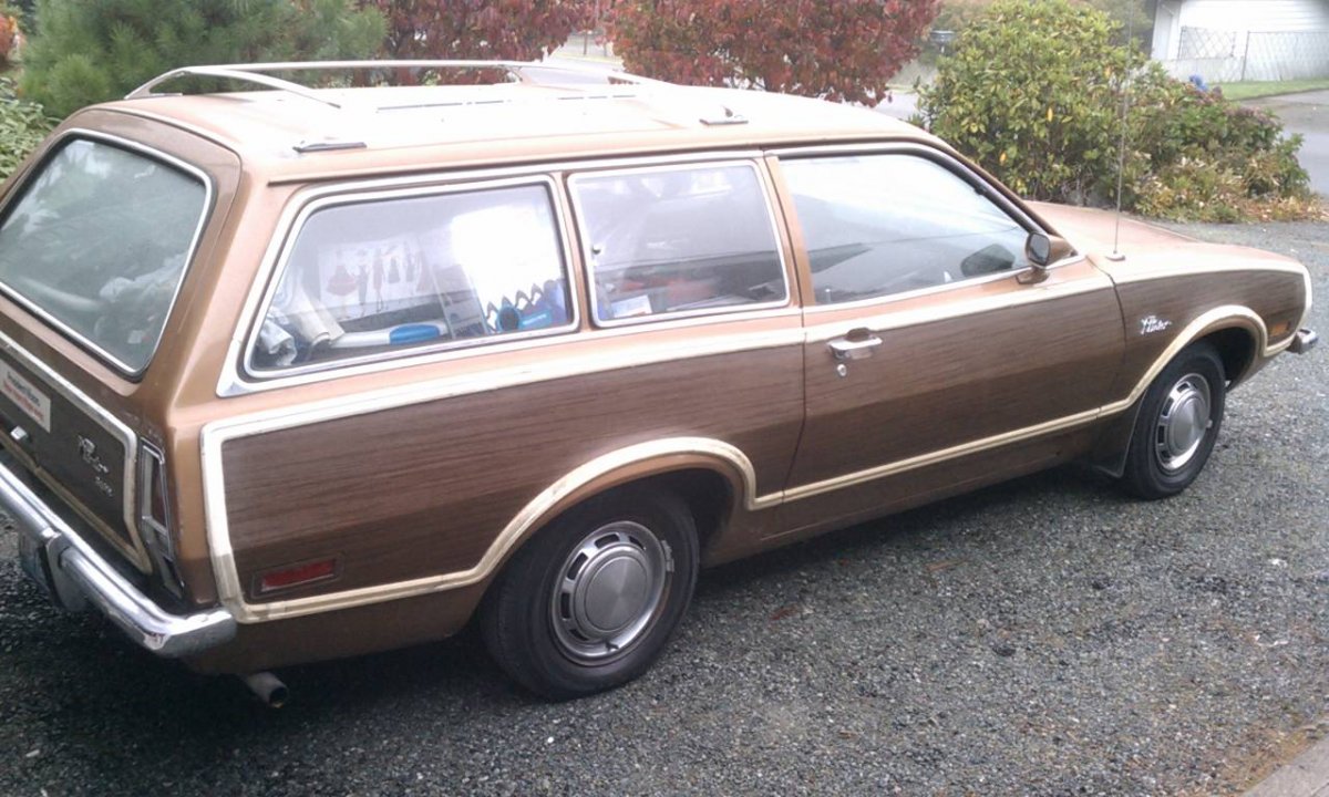

    Got rid of this a couple of years ago. 1972 with the German built 2000 with new cam, followers and valve work. Unfortunately all the head work got the compression up to the point where a rod would knock over 45 mph.

    ^^^Careful now, looks like you're sporting a little woodie there Roger Ramjet. o_O
