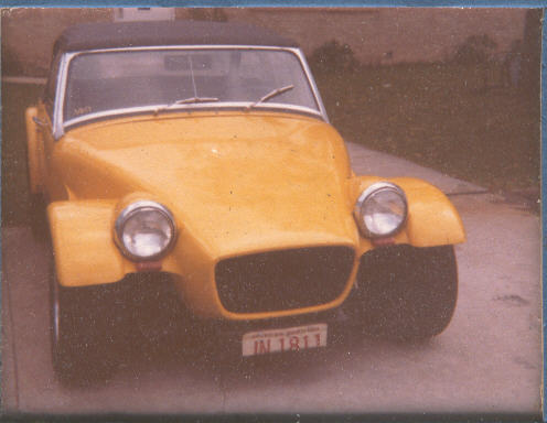

    I drove for 20 years with my front plate folded at a 90 degree angle. Never got stopped for it. ark 001.jpg

    It's a 1968 Austin Healey Sprite with an Arkley SS body conversion. BMC A, 1275 with a 0.160" over bore to 1340cc. 225/50/13 tires on 7x13 wire mag style wheels. Summer daily driver and autocross champ.
    Keep up the great work.
