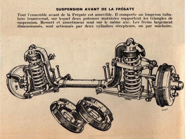

    Is this your front suspension? Are those your front springs you posted?
    Ratatouille and chryslerfan55 like this.
  7. Ratatouille
    Joined: Sep 3, 2014
    Posts: 619
    Ratatouille
    from France
    Yes, this is my front suspension on your pic, and these are the originals springs, uncut. I just received them.
    Next week I gonna clean and paint this parts, and install these new used springs.

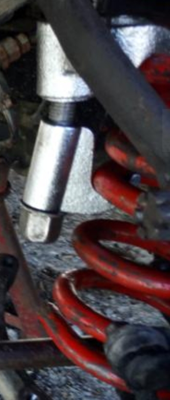

    You know guys, yesterday, I wanted absolutely to fit that wrong springs, I'm waiting that about 2 month....but....the big BUT.....a little voice inside me asked "be careful Ratty, you have limited tools, the parts are not the right parts, and in fact, I was not really "in the mood" with this operation.....
    And then...I have read your post........BE CAREFUL......and you right......I have drop it.....this is for the example, my bad condition......don't do this at home, or anywhere ;-)
    My floor jack.....no good.....[​IMG]
    My bad floor...no good.....
    Jack for secure a little.....
    Spring compressors are cheap....but with that small springs, I cannot use bigger one.....
    No way to mount that springs.....the diameter is too small to fit in the bottom socket, and it floating in the top "housing shoes"...
    Well, I made ****:mad:, of course, I can cut some coil of the old one and weld on the bottom and top of the new....but I don't like that, and in the futur the car will be drive secure...so I'm looking for original FRONT springs.....again......:confused:
    Yes, it's better to read and follow your great caution, because this time I had lost my way:oops:
    Spray-can springs red was THE good idea....no epoxy screw upo_O

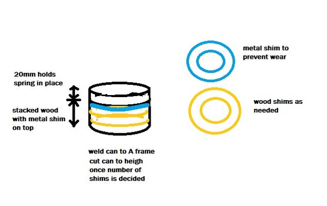

    It's a lot of work, but inexpensive. Make a can that your spring will fit inside. Trial and error to find how many wood shims you need to get the proper ride height. Put a thin metal shim on top of wood shims to prevent wear. Cut can about 20mm above shims to locate spring then weld can to the A frame.
