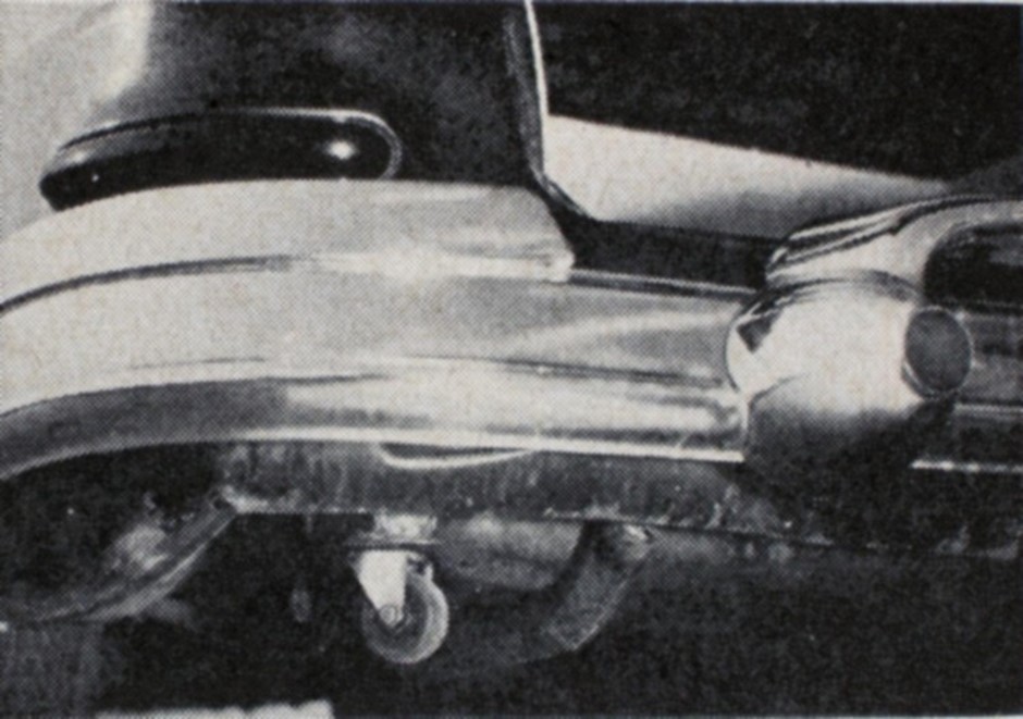

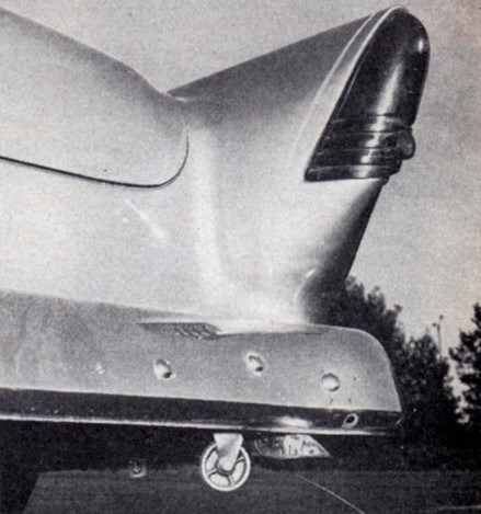

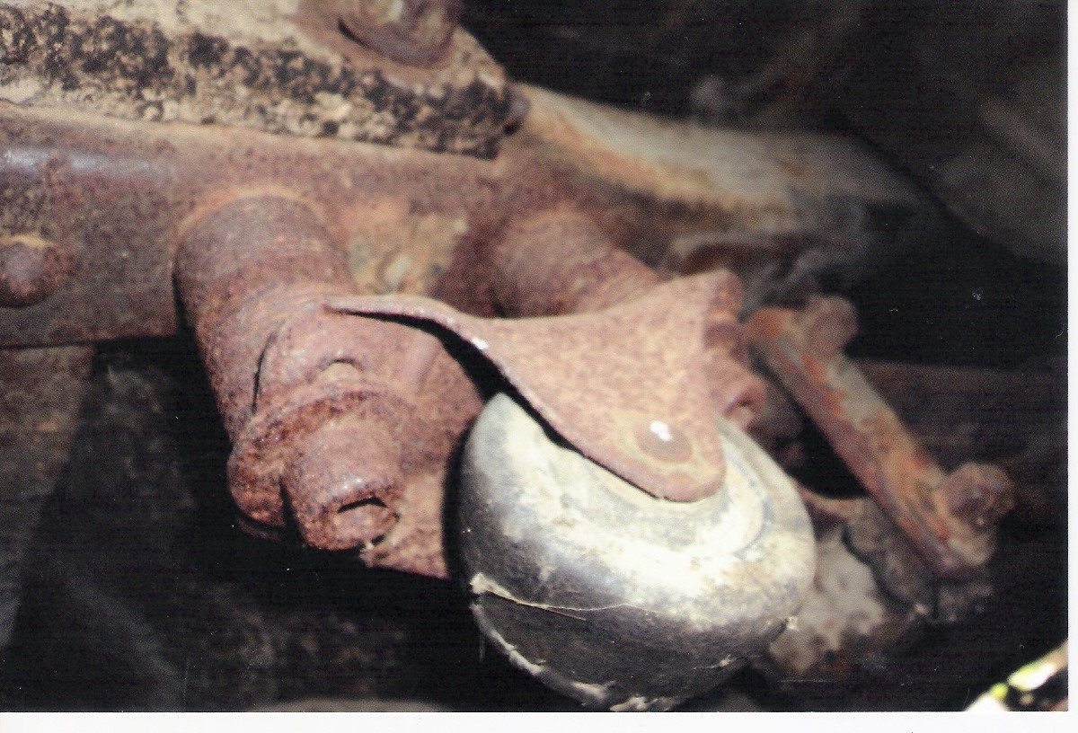

    With that in mind, I thought I’d see about fitting some castors somewhere under the rear of the car. (If they’re good enough for the Hirohata Merc, they’re good enough for me).

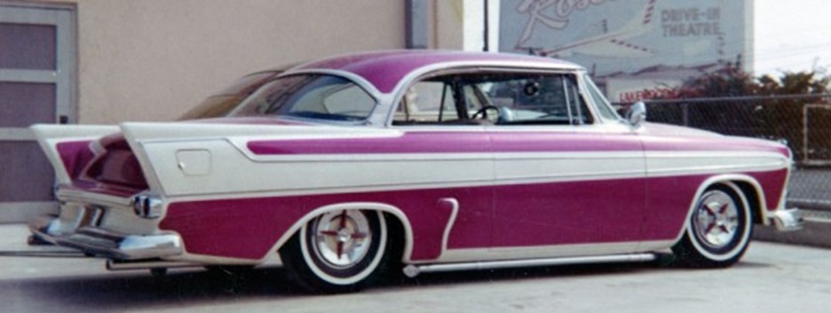

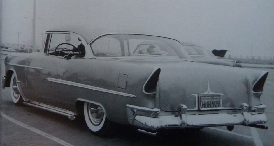

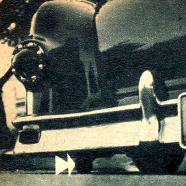

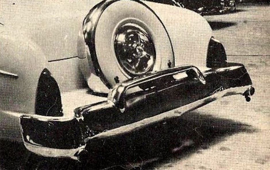

    And the Hirohata Merc is not the only Kustom that used them in the days before air bags. A few other examples from way back include these: –

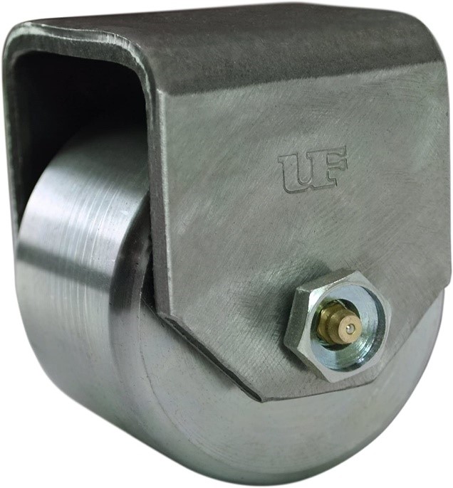

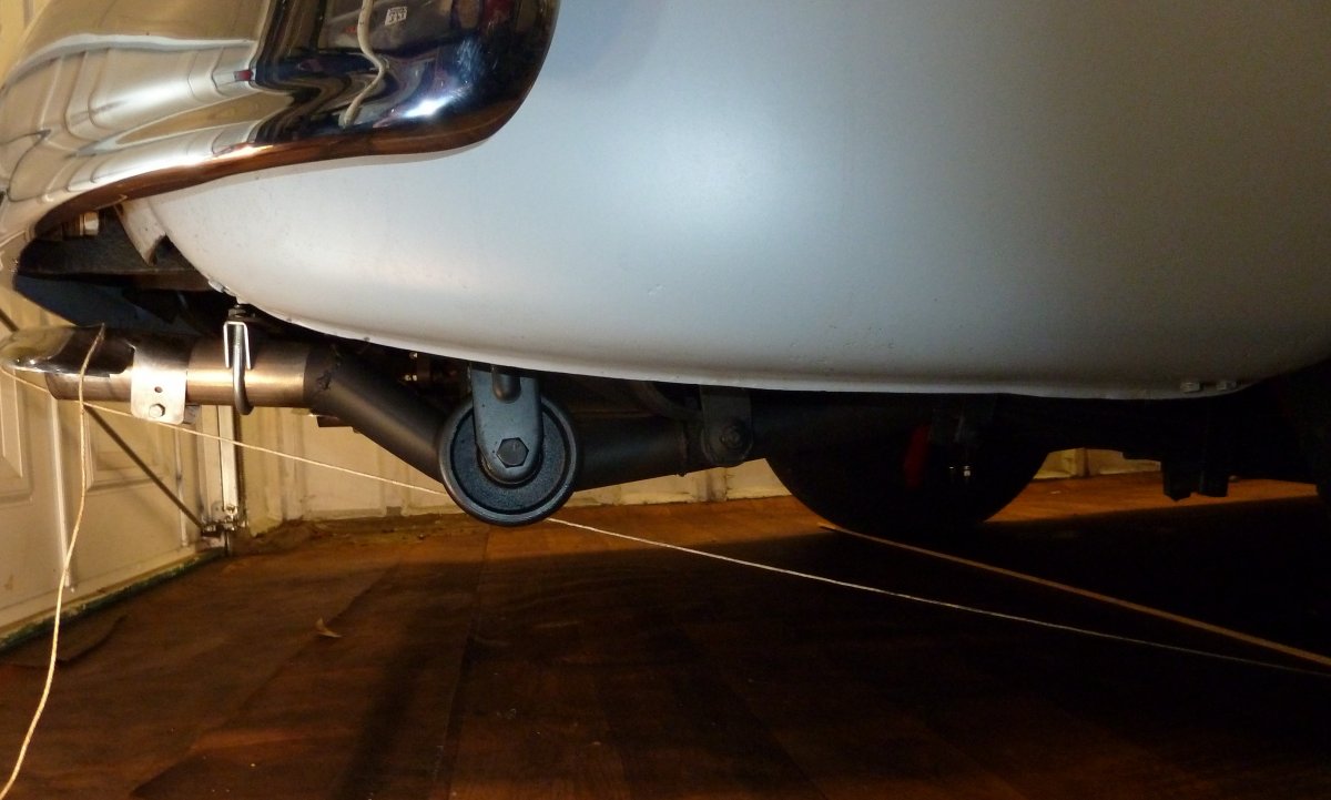

    One good idea I came across elsewhere on the HAMB, was to make castors using wheels from an old trolley jack, as they’re obviously up to taking a heavy loading. Only trouble is, I don’t have an old jack to cannibalise.
    Checking out what is commercially available I decided I needed ones stronger than those on your average office chair, not huge so they don’t look like 747 undercarriage hanging down, and most importantly, cheap!
    In USA it seems easy to get these ones for use on trailers. They have no bearing, just a greasy hole through a solid steel wheel. They look very robust, though they don’t really look anything like the ‘authentic’ castors in the photos above.–
    Not being able to find any of those in the UK anyway, a good alternative were these ones.
    They have steel wheels and roller bearings with grease fittings that make me feel they are of a reasonable design quality. A bit big maybe?
    I figured they are only going to be under stress for the ‘blink of an eye’, but if they are going to fail, it would most likely be the ‘forks’ bending, rather than the wheel or spindle bolt breaking. I therefore beefed them up a bit. (Maybe I’m being over-cautious, but you have to understand just how many gipsy tops the other half insists on packing for weekends away).
    I didn’t go for the more expensive swivel castors, even though I appreciate that the further away from the axle the castors are fitted, the more side stresses fixed castors would endure when turning whilst crossing a ramp. I think it would only be a problem if I came out of my drive at speed, with the rear end side-ways. If that was the case, I really should be re-evaluating my style of driving!

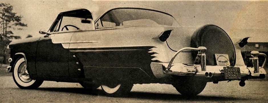

    This photo, (also found on the HAMB), makes me feel a little more confident, as it was fitted to a Dean Jefferies ‘51 Merc built back in the day, and appears to be a less than heavy-duty looking ‘fixed’ castor, and not a swivel one.

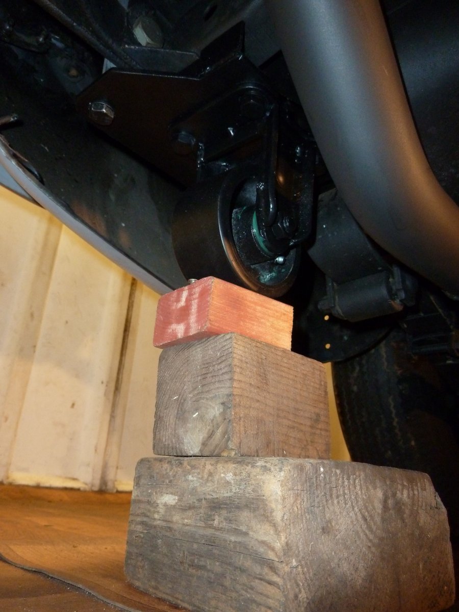

    Before fitting the castors, I got a piece of string from the bottom of the rear tyres to the lowest point on the back of the car – the exhaust tail-pipes. I figured the casters would need to hang down just below the line of the string.
    It’s at times like this I wish I’d paid more attention to geometry lessons at school. Had the teacher talked about mathematical equations, such as X = chopped Merc scrub line, times angle of the dangle, over inclination of rampness, I’d probably have been more engaged.
    I established where to put them by standing them where I wanted under the car, and then building bracketry that pressed against the bottom of the ch***is, and attaching that via the two huge bolts that hold the bumper irons on.

    I tried to camouflage their shopping trolley looks with some satin black paint to help lose them in the shadows.
    Hopefully they don’t look too obvious, as I fear it may look like I’ve run over a senior citizen, and am dragging their Zimmer frame, caught under the rear bumper. Not a good look!
    There is very much a danger of spoiling the lines beneath the car with people’s eyes drawn to a monstrosity dangling from the back, like some dog with a ‘claggy on the waggy’. Hoping I’ve got away with it. –

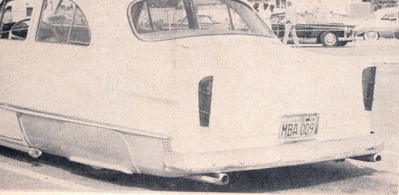

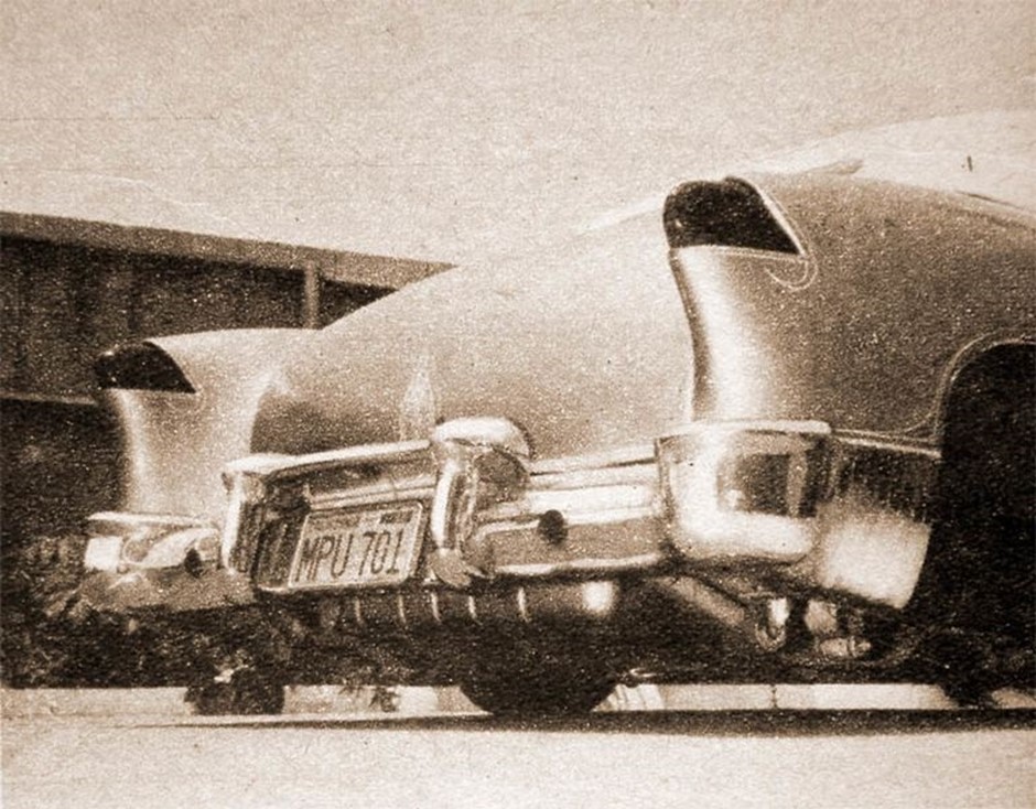

    This Shoebox, pictured in the 1958 Custom Cars Annual, has noticeably worn exhaust tips.
    The same car, in a 1960 Rod & Custom magazine, appears to have gone down one driveway too many, and lost them completely. Is that a castor I now see?
