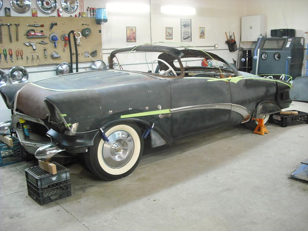

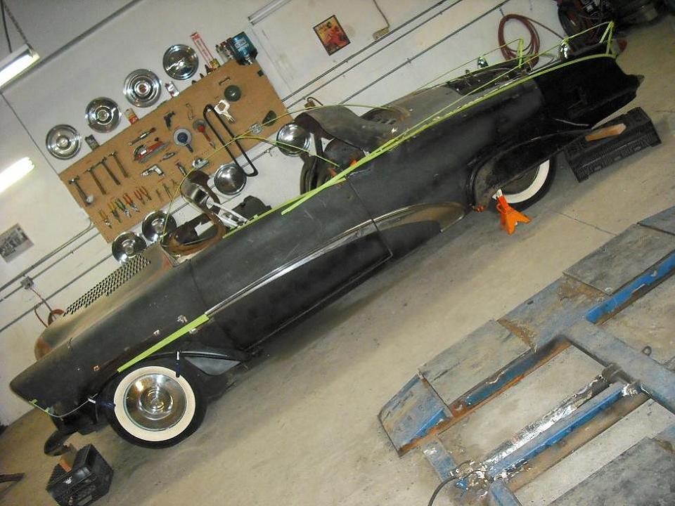

    snapped a few pics today,,,i may cant the fins a little and possibly have them fade into the door to facilitate the illusion of length,,,,,i was consdering doing fins similar to barris' modern grecian,,,but after some thought and some feedback from you guys, decided against it in the end,,the fins will be formed from sheetmetal...also trying to figure out the deck area,,will most likely do a pancaked trunk, and a rounded rear panel (see mock-up),,roof will be very similar to the golden sahara II,,(the bob metz version)...getting there,,,,,,(maybe,,hahah,,,,,)

    It looks great, you took this car to another level of custom... Much respect to you man...

    NOW we're talking! Those fins are really helping to "bring up" the rear of the car visually. I like your style man. :D I never know what I'm going to see when I click your threads. :D

    I don't know Jim I'm torn I like the sweetheart dip in the door and rear quarter and the extended fins would kind of eliminate that. That being said I like the look of the long fin. HAHAHA not much help hey. I'm sure you will figure it out.

    its kind of hard to see because of the tape,,,,but the fin will be canted and wont interfere with the sweetheart dip of the door,,,,,,its only two dimensional in the mock up

    i like the fin idea, definitely helps the rear IMO

    it really did need the fins,,,now when i look at the car i can't imagine it without them,,,untapering the back wouldn't have had the same effect,,seems like i spend more time studying the lines of this car than anything,,,but im hoping it'll pay off it in the end,,

    Love the fins. There sure isn't much 'Shoebox' left in that car, and I mean that in a good way. Keep on doin' your thing.

    I'm really digging the fins. Are you planning on the tail light and back up light (future exhaust port) pods to stay aiming down, or will you tweak those to level them out?

    they will be levelled for sure,,,,,whats a little more slicing and dicing at this point? :)
    theres a little future surprise coming for that area too (not TOO shocking,,but a little different than it is now)

    i think they called the door dip on a kaiser darrin a sweetheart dip if im not mistaken,,
    the main shapes are there,,there are a few small details to work out in the rear area,,taillight placement, rear pan curve, bumper bullets, etc...the trunk will be pancaked and rounded a bit
