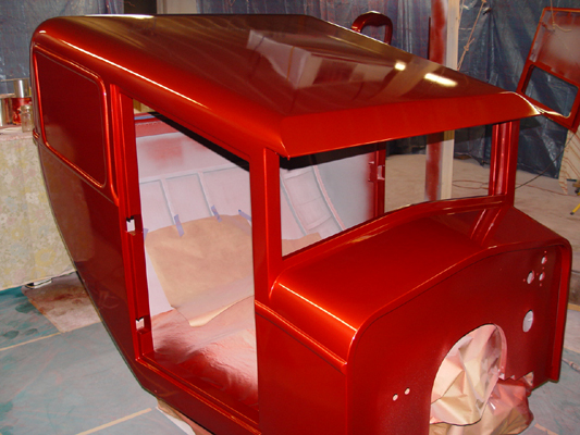

    I use Transtar Clearcoat and find it works and polishes well. Plus it's about 1/3 of the cost of PPG. Here's a 48 P/U I put it on.

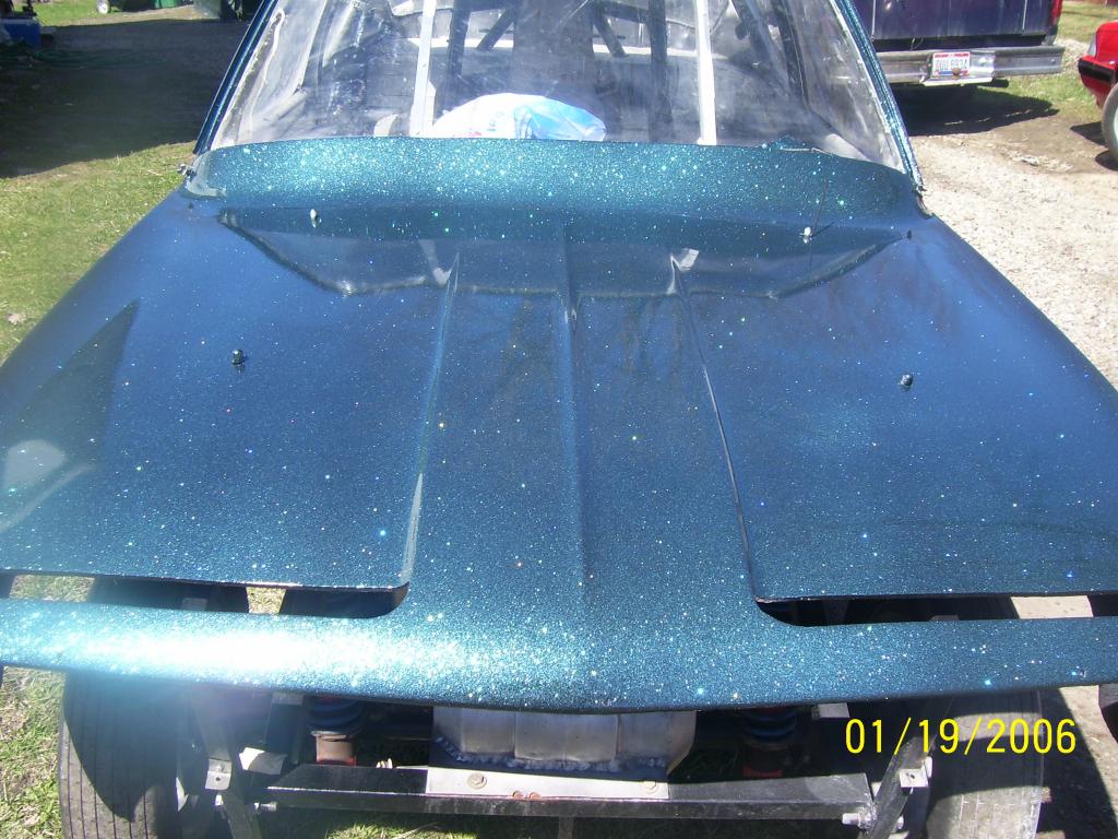

    i used paint with pearls blue with crossfire clear from napa.i do remember using transstar clear before and it turned out good but it did yellow alittle in a couple of years.to me i would use the best clear i could afford.these pics were taken about an hour after i finished clearing it in my tractor supply garage tent.hope this helps,and i also did flat black base.

    also plan on useing WAY more flake than they sugest.i put three heaping tables****s pere quart and did 4 coats{1 gallon of clear}and a tees**** of crushed gl*** in the last coat to give it that extra POP{.050}and the flake size was .004.

    Thanks for answering my Questions American Opel, Its hard to get anybody to answer a newbie Gernade inspectors question and also not haveing a tradional car. Luv the Opel :D
    Did you you use a black sealer for a base, or the real base color?
    Crossfire clear at Napa is that a Urathane? How much did it run? I am getting close to paint,1st block with 80 grit, now I have put some more slicksand on and working on 180 block :D

    i used black enamel flat with enamel hardener that my friend used on his truck and trailer.it is for automotive use.it was cheep like $50.00 gallon{his price and he does have a bodyshop}i only used a quart though.after i sprayed the black i took some scotch brite to it tack clothed it then sprayed some alcohal on it to destatic it.

    You sprayed on a budjet and looks great, how long has your paint been on?

    i have $75.00 in the paint job,including the gold leaf lettering.well plus another $100 in primer sandpaper and filler which i still have leftovers of everything.so i would really say $50.00.the clear was leftover from a pre.car.{one gallon}and the other was from a friend that wouldnt use besauce it was about a year old.i sprayed it last spring.the clear that i had i sprayed my hornet with about 8 years ago and it still looks great{i sold it 4 years ago but last week the guy emailed me some pics.of it.

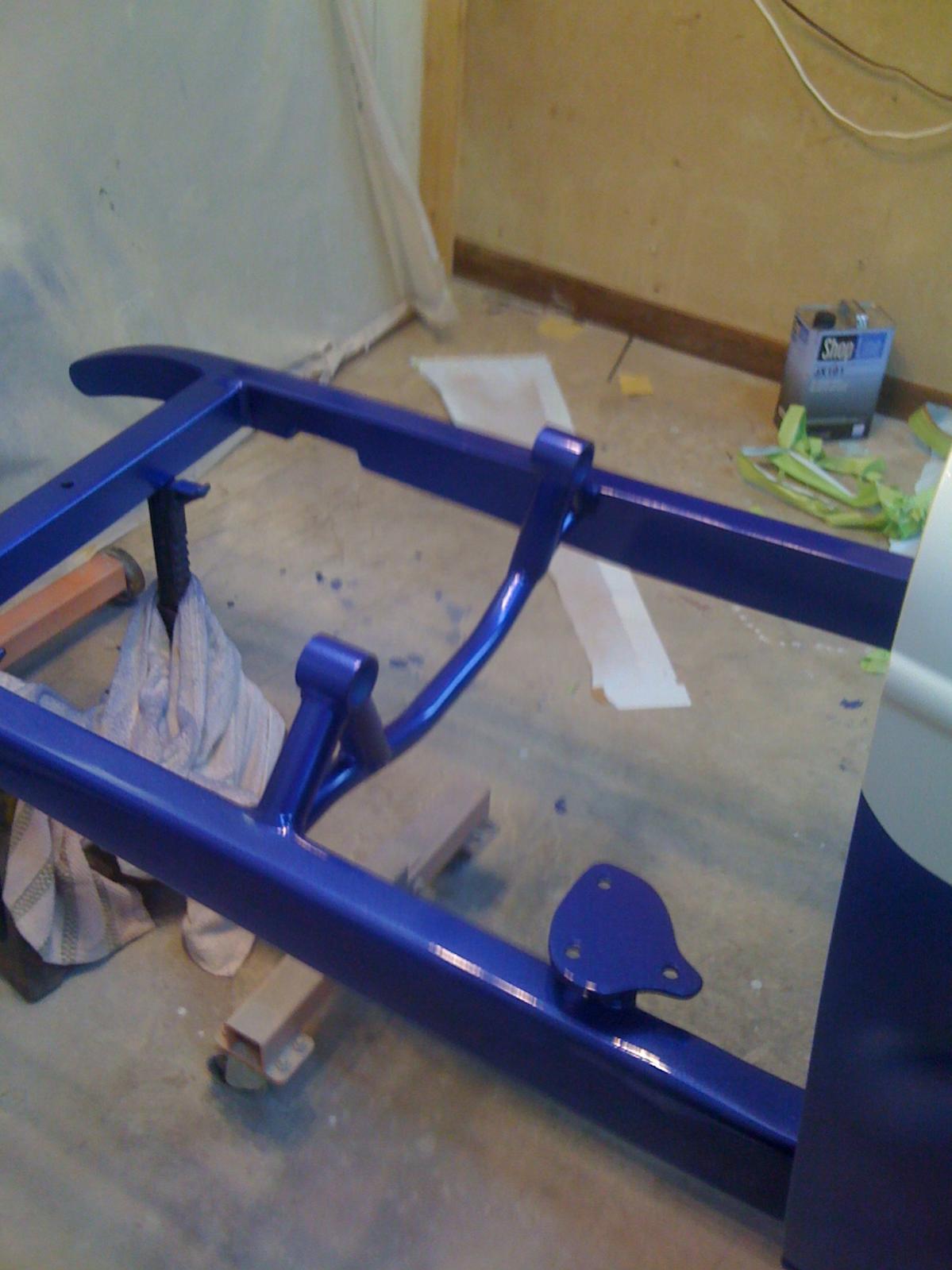

    Well painted my cage this weekend, will start on rest of the car now.
    Kustom shop products
    3 coats of blue metallic base,
    3 coats inter coat clear, with .004 cobalt blue flake,
    4 coats clear, and a pain in the but to shoot :D
