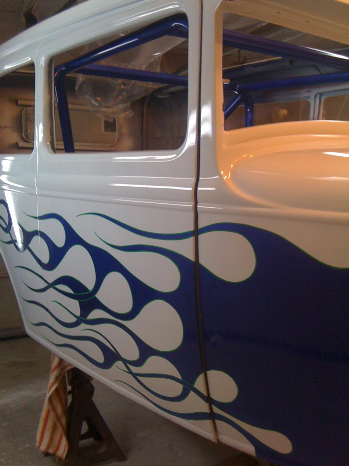

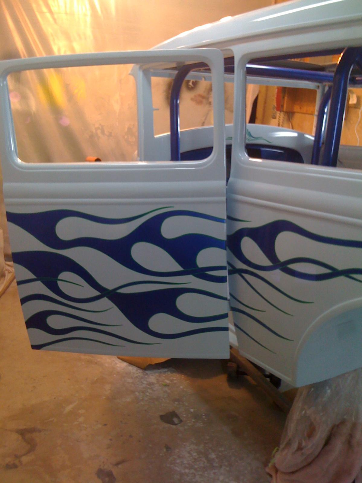

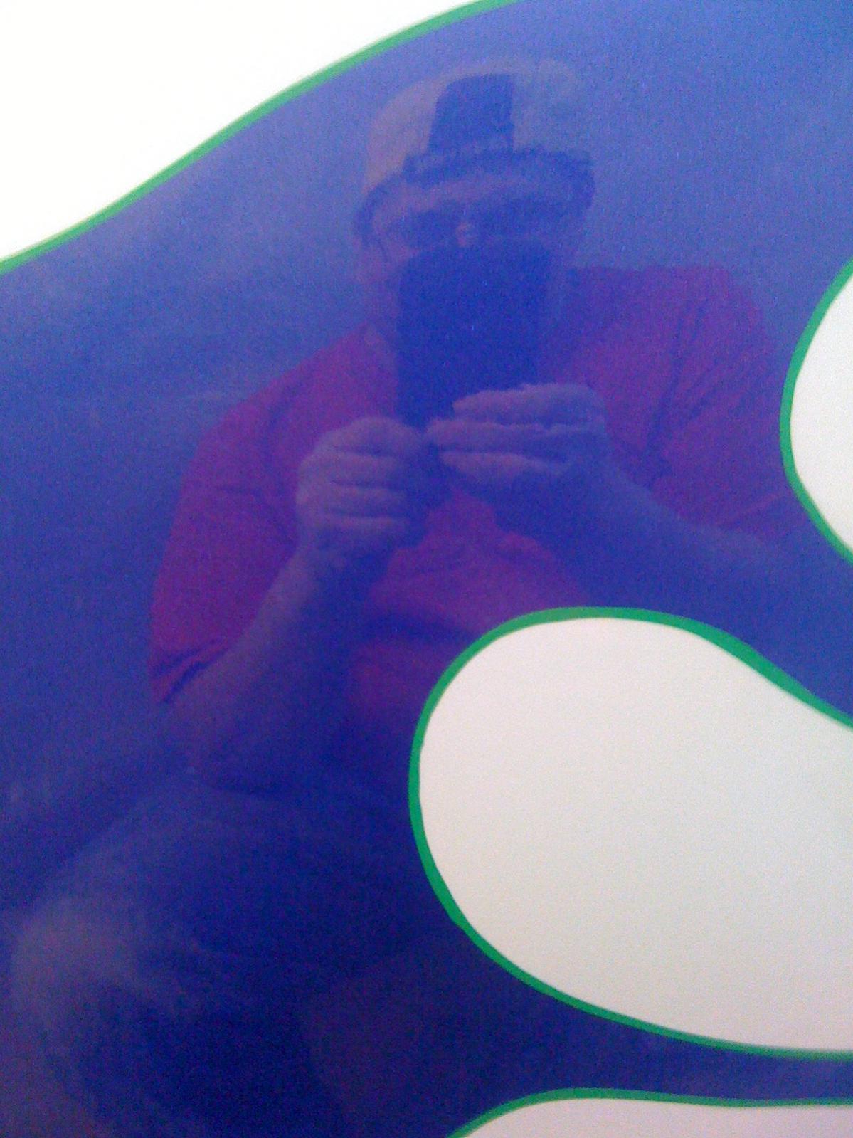

    cleared it, 600 grit sanded, striper striped, recleared, 1 tack coat, 2 wet coats, now time to cut and buff.

    Kustom Shop is what i used on the wifes car, I was happy with it. Clearly your not new to painting it looks great!

    I havent painted a car in 19yrs, have had alot of primer rides, I guess it like rideing a bike. :D Never have painted for a living, just own rides.Lot of internet reading :D Make sure you BLOCK, and block, and block, I hate that stuff :D

    I'd be way more than happy with an outcome like yours, be proud of that one !!!!!!
