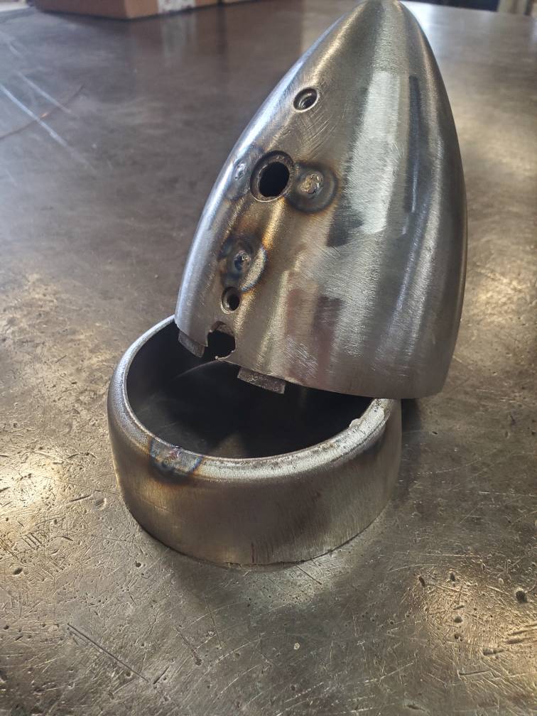

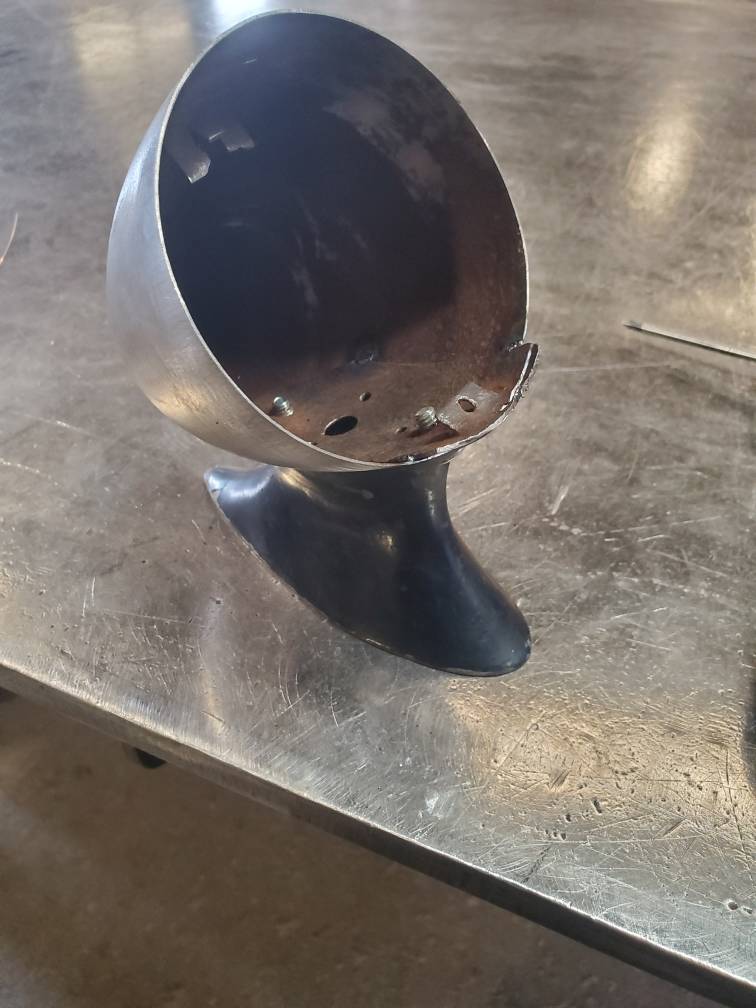

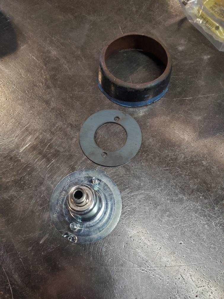

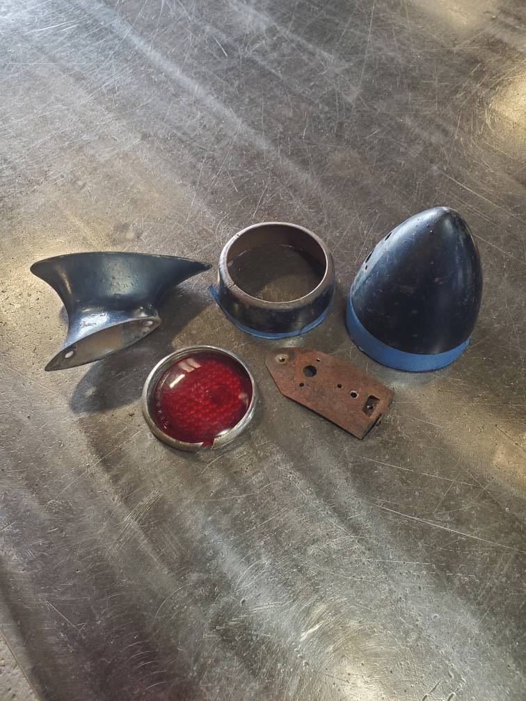

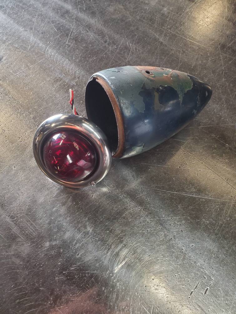

    Had a customer want to change over to LED bulbs but still maintain gl*** lenses. For the size of the bucket and ease of install went with '50 Pontiac bullets from speedway. Unfortunately he had to cut the bucket into a couple of pieces to get it apart, so I had to glue it back together. 20200103_092311.jpeg 20200103_090042.jpeg

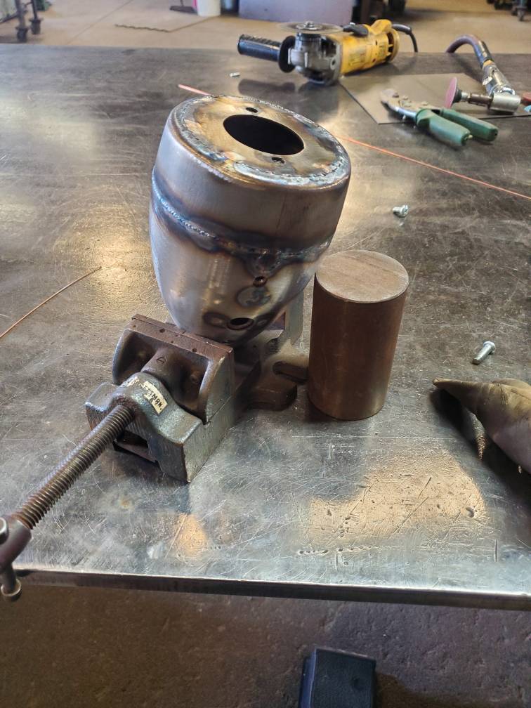

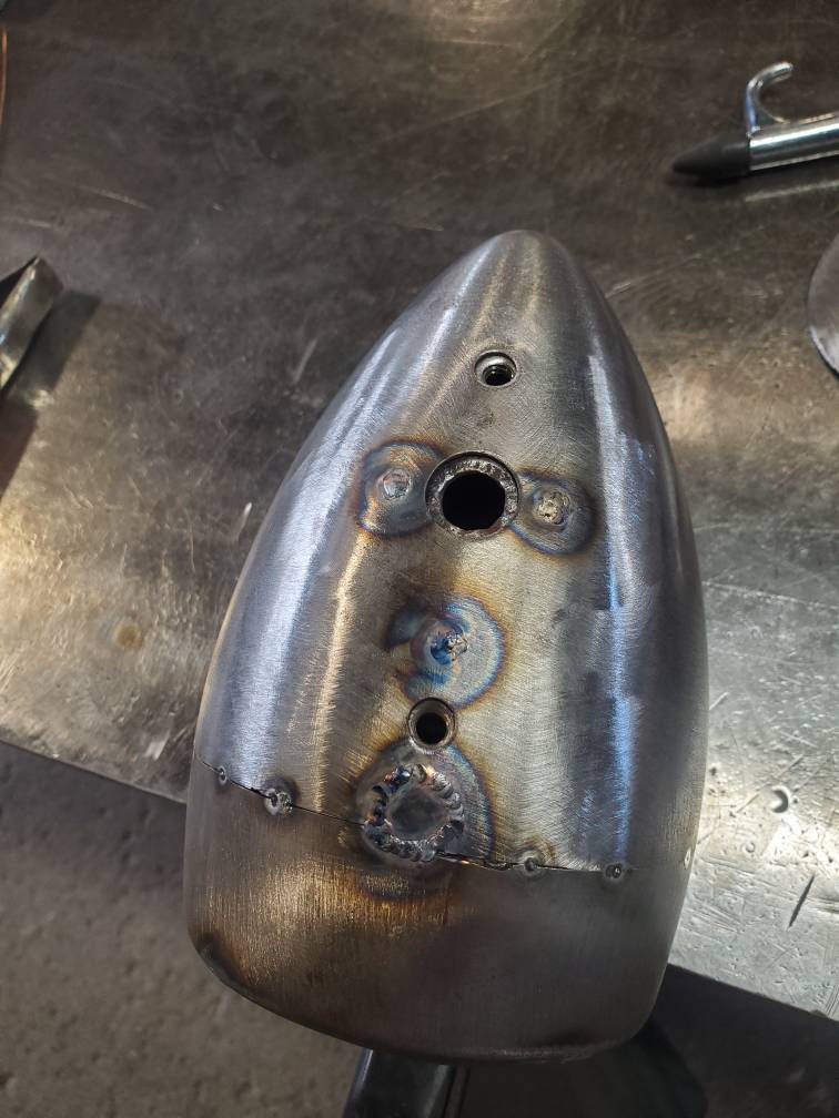

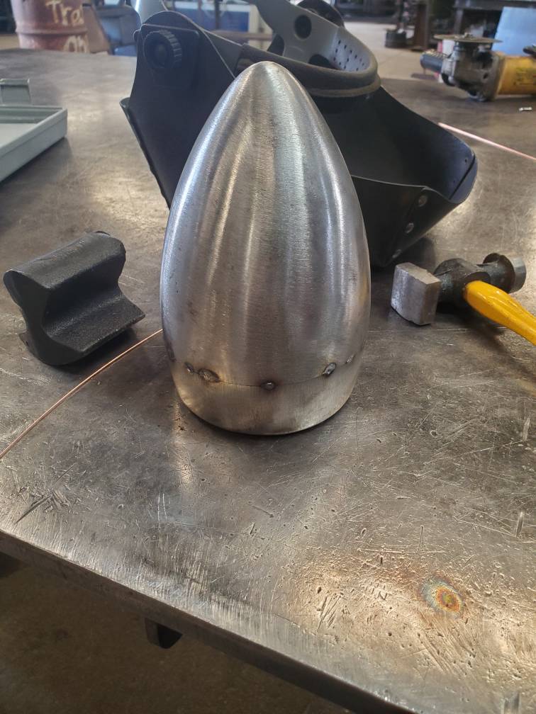

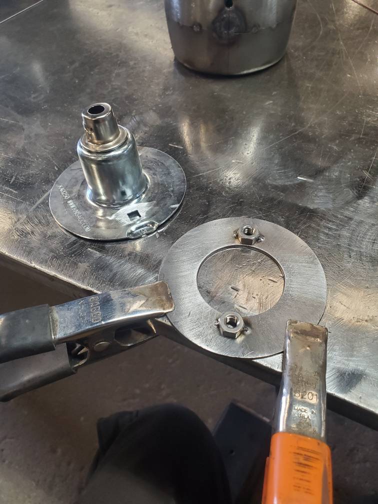

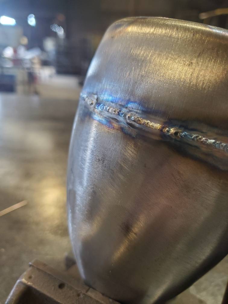

    Since the Pontiac ***embly has studs I had take the out and cut a ring to fit it to the bucket. 20200109_114541.jpeg 20200109_140625.jpeg

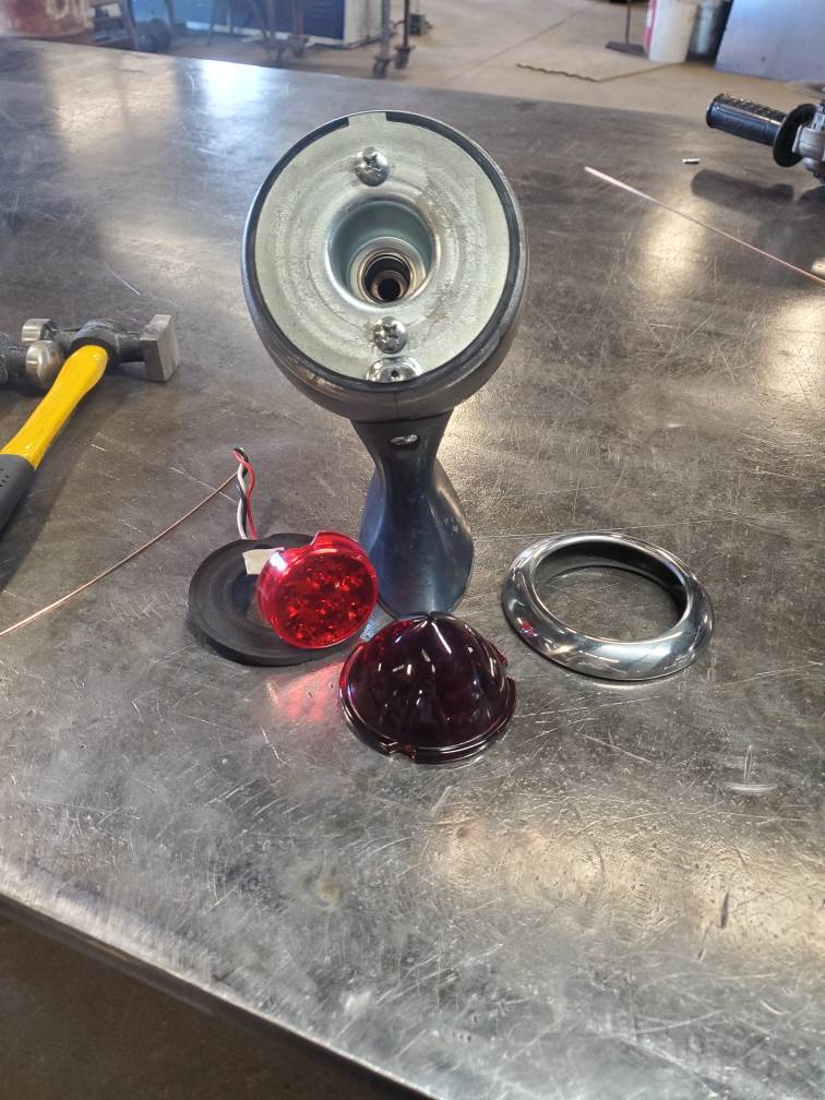

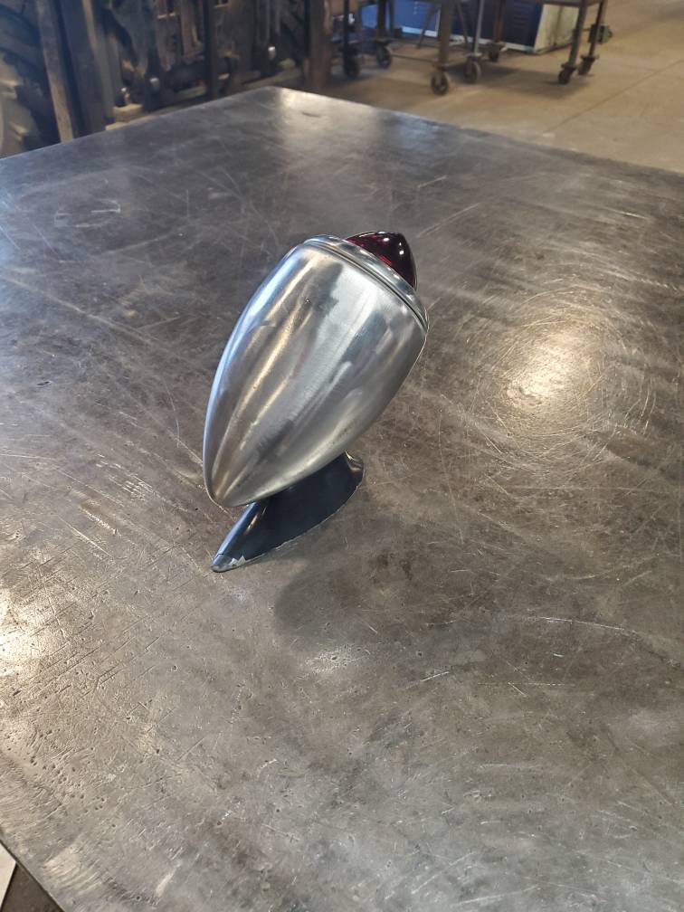

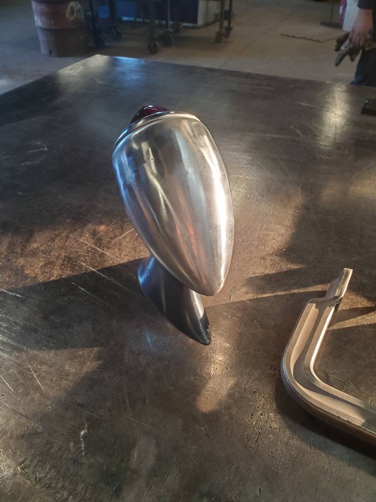

    Quick test fit to check the look and make sure all the hardware is in line so the set screw is on the bottom of the trim ring when installed on the car. 20200109_143521.jpeg 20200109_143059.jpeg

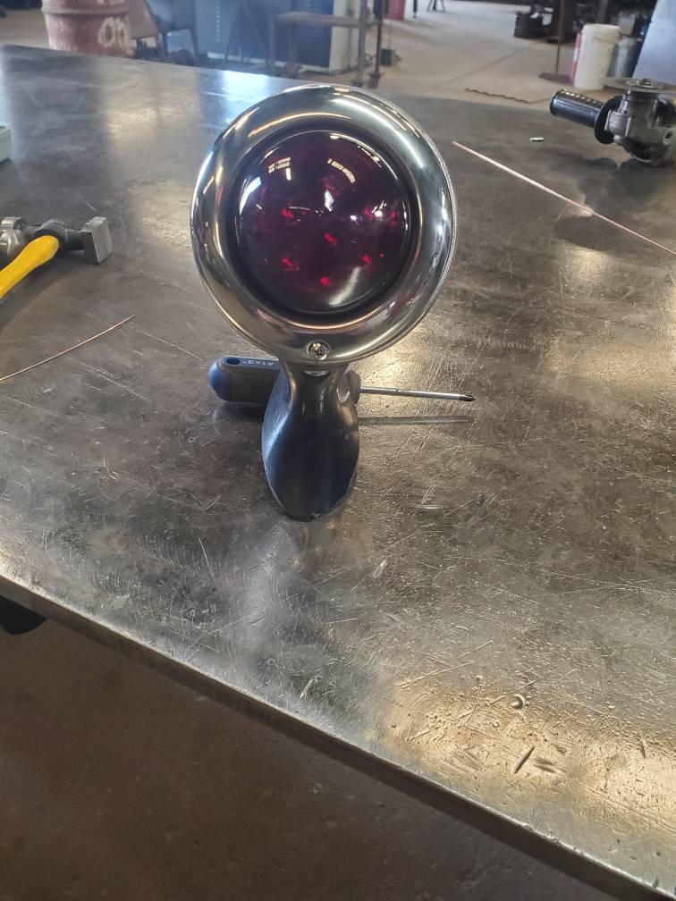

    Fancy instagram photo. Looks like a rocket ship. Very happy with how it turned out and that it looks as cool as it did in my head. IMG_20200109_190127_026.jpeg

    Amazing looking work! But why not just use an LED bulb and save all those hours of labor?
    LPRS likes this.

    The bulb post and connectors were pretty rotten and the screws and threads holding the bucket to the stanchions were all rusted solid causing the customer to cut the bucket into pieces so a bunch of the work would have had to be done anyways and this looks cooler than just flat gl***.
