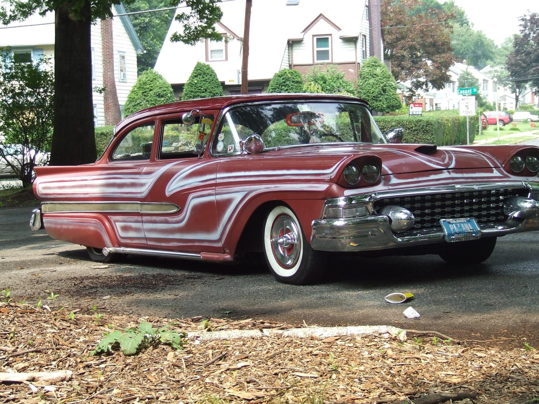

    Here is the car they are going on......[​IMG]

    i will say the look of the bias-ply tires are great! some cars they work better on than radials. my 63' nova front end would come out of alignment with radials because the tracking was to positive.

    I'd lower the front end first THEN decide on what tires and sizes.

    That is a BEAUTIFUL looking car. I LOVE the color combo. :cool:

    Easy call... G78-15.

    Ah yes...bias ply tires ride like ****, don't handle, unsafe, blah, blah, blah. I'd bet a doughnut that those comments are coming from you youthful types that have fully asymillated (sp?) to the current thoughts, AIR PRESSURE. You pump your bias plys up to 32-34 psi like a radial or because "that's what the tire says..." you'll get just what all the *****ing is about. 28-30 psi is normal for bias, even as low as 26 on lighter cars with no ill effects. Bias tires don't last as long and maybe sacrifice a tad of mileage but if the need is for the look you just go for it. But suppose you want to try to p*** Denise in the ac***ulated mileage game and feel a radial is the way to go, well kids there's a way to do it without it lookin too bad. Pick the tire 1st as in size, diameter, whitewall and series (60-70-78). Then pick a wheel that's the maximum width the tire will allow. The specs are available in the book and all over the 'net. Suddenly the bulge in the sidewall that seems so disturbing is reduced to a point where it's almost as if it was gone. It's still a radial and still handles great but looks far less outta place. Think about it for a min and it'll make sense to ya.

    Or 6.70 Goodyear Supercusions. I don't necessarily think the front should come down as Denise said as long as the selected tire can fill the void. 7.10's would do it but I am not sure if that car is big enough to use them.
