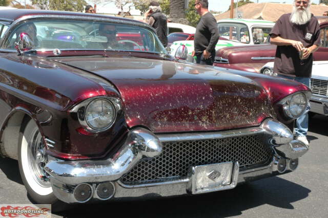

    Nobody puts more miles on Bias Plies than this man right here.

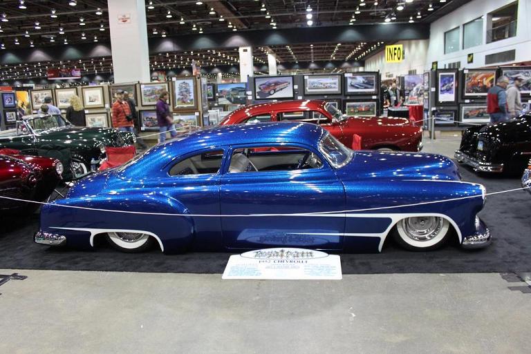

    It's all in the eyes of the beholder, if you like bias tires run them and if you like radials run them. I don't think either one looks any better then the other one. As long, as it a cool white wall on the right car that's all that counts.
    Here's a custom that runs radials and it's one of the coolest Chevy's around, the radial tires don't take away from it what so ever.

    Hey Cruiser, how ya doing man. Thats actually one of my favorite Chevy's right there. I dig the suicide doors and body mods. Kool car and you're right about the tires.

    I'm a bias kinda guy, and I put alot of miles on them, my galaxie is the only car I own with radials, and what I like about bias plies are when and if they blow out they don't shred your fenders and wheel wells and tear the hell outta everything . heres some pics of the cad, on its third trip to cali on bias plies, after we went to austin3 times, detroit in the winter,and all where ever else I drove this thing....

    and more bias plies.... I have drove them thru the desert to bonneville on my hot rod, dialy all over in my 59 el camino, and my stude to cali 3 times, they have served me well, And I am one who agrees they are a must to look right. but this life aint for everyone........
