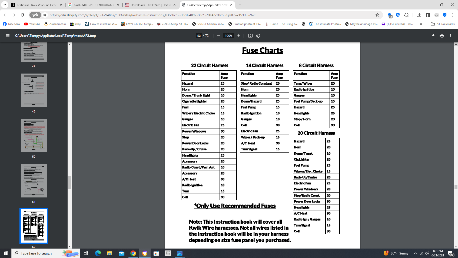

  5. Mr48chev
    Posts: 36,020
    Link that might actually work for the instructions https://kwikwire.com/pages/downloads
    That link works to get you to here as this for the pfd might not https://cdn.shopify.com/s/files/1/0...-08cd-4097-83c1-7de42cc0cb5d.pdf?v=1590552626
    They lump everything together and don't have an eight circuit specific instruction sheet. No free lunch here you have to think it out one circuit at a time.
    It does tell you what color wire is for what circuit though. Screenshot (443).png Screenshot (444).png
    ^ that's one of a couple of pages.
    The real challenge with that one is that you have to know what pieces you have on the car electrical wise = Delco, Autolite or mopar alternator, what ignition and other pieces and find the right instructions for each item a**** the list of possibilities. It's similar to the Painless instructions but a bit harder to follow. The main thing is down load the pfd on a real computer that you can sit and sort out what info you need That is going to take some time even with just 8 fused circuits.

    You need to get past the little white book.
    Download and print out the big instruction book linked above.
    Pull out the pages for the eight circuits your build will have. Put everything else on the side for future reference.
    Work one circuit at a time. Test as you go. You'll be finished with eight circuits before too long.
