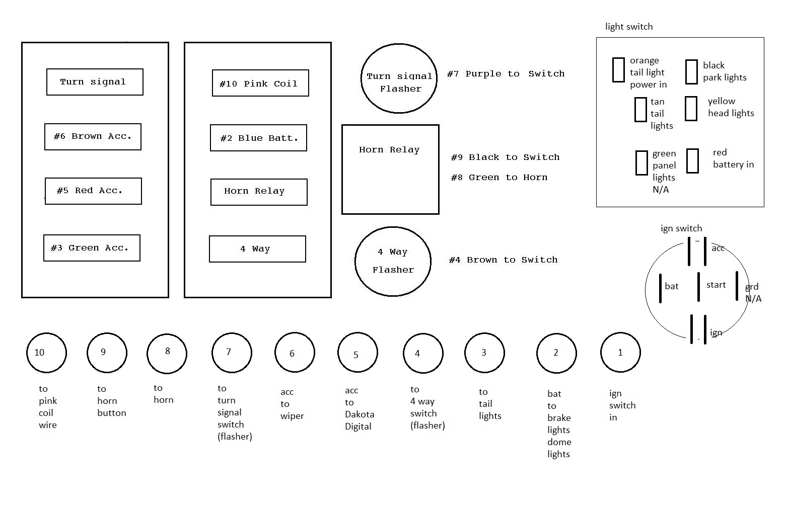

    Hey, asking for help on a Kwik Wire 8 circuit fuse block & terminal strip set up being installed in our '54 Bel Air post. This is the standard issue not the budget offering. bought it in 2019ish, for what ever reason I don't have the invoice nor the important instructions. Hoping someone has and would be willing to share the terminal strip schematic information, wanting to verify to see if the our numbered connections between the block & strip are correct.

    Is this the old style one with 8 fuses, 2 flashers, and a horn relay wired to an unmounted 10 place terminal strip?

    Rich, yes it is... part # SKU 2002. John deleted the hazard flasher and did a headlight relay instead. Wanting the schematic to verify that that the numbered wires are in correct position in terminal strip... He has returned home, so trying to get the basics done before bringing in a pro to finish up. Thank you, Dyno Dave

    Here's a drawing of one of those we put in a '54 Bel Air with notations of what fuse, flasher, or relay they were linked to along with their usage. I think there was a battery and accessory feed wires into the fuse panel that are not listed. I don't remember their diagram being useful and had to make a plan on my own.

    Rich, thank you for your posting, it and with this morning me crawling under the dash seeing those rings of wiring hanging there. I realized this is for the pro to finish, I'm concerned about doing wiring damage because of I didn't know any better. Have a shift light and air/fuel ratio system still to be installed, I'll work on the projects that I can do.
    Again Thank You !!! Dyno Dave
