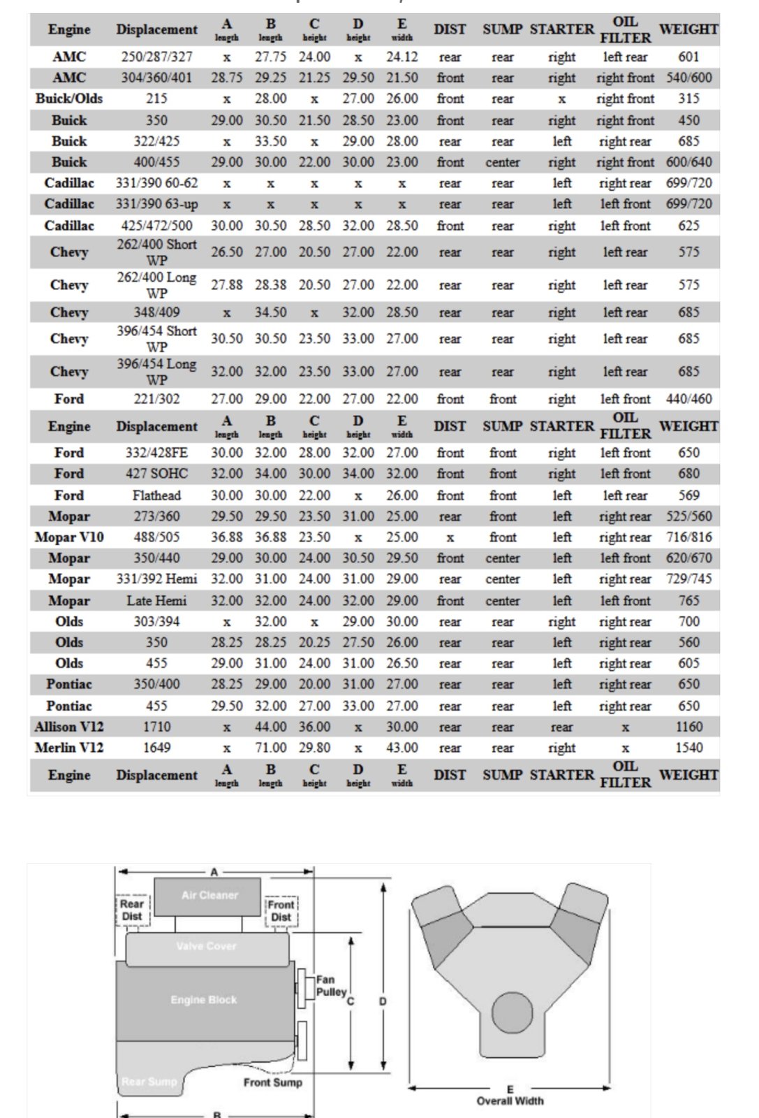

    L-78 Chevrolet 396/425 hp.

    Denny, when I read the ***le of this thread, I thought the same as you! What measurement of a 396 do they need!

    now that would be 1965 and newer. no-no

    Or 375 hp.....
