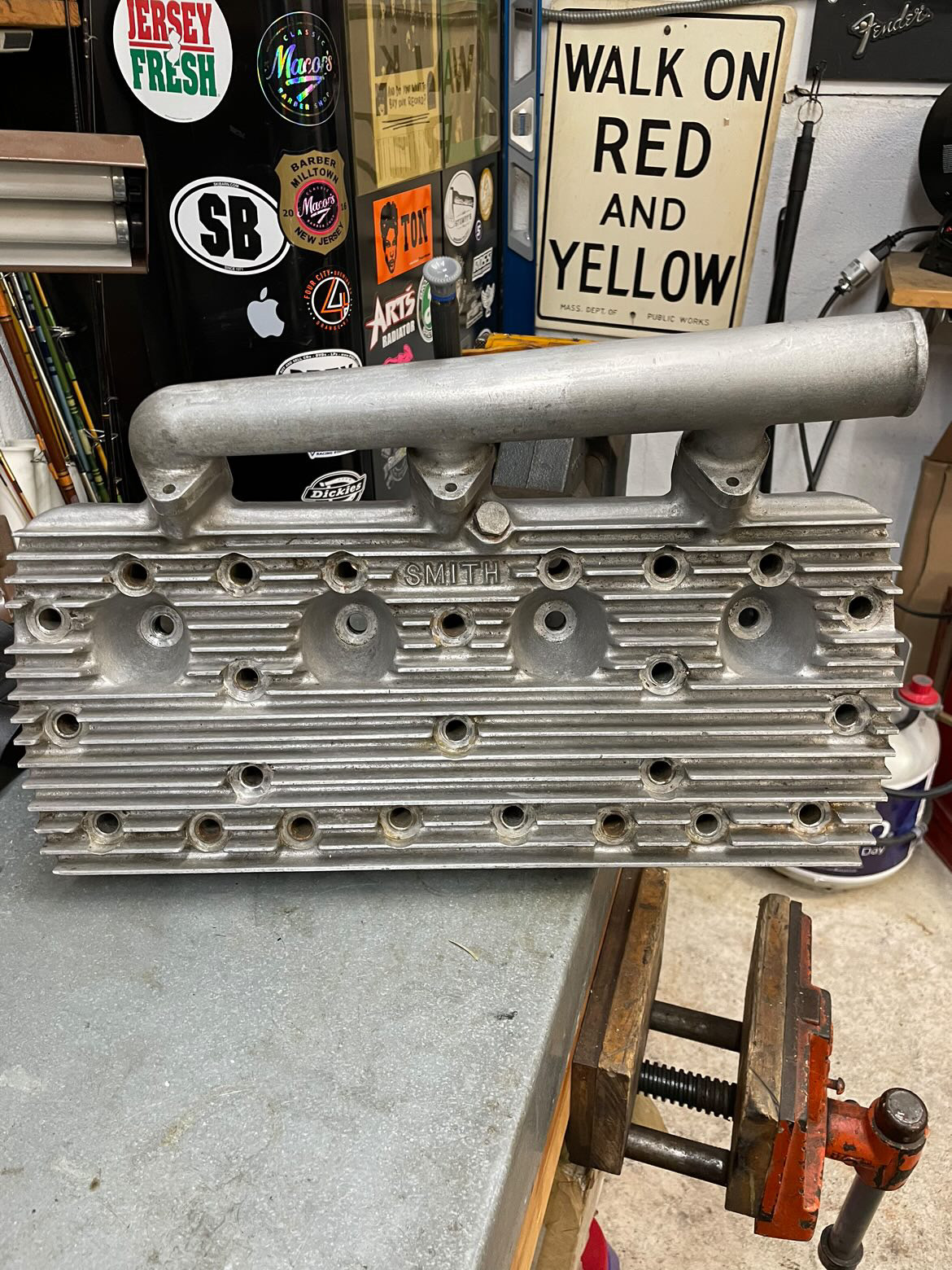

    Here is a pict of the Smith heads. Similar to the L&S Racing heads you have. They are really thick and I believe hold a gallon more of coolant in each head. Smith heads .JPG
  6. 3w Hank
    Joined: Jan 29, 2022
    Posts: 1,099
    3w Hank
    Very nice repros !
    But the kit I bought really speaks to me of a early hot-rod poor guys might had afford to get and its the real deal, but who cares of it was cast 1948 or 2008.
