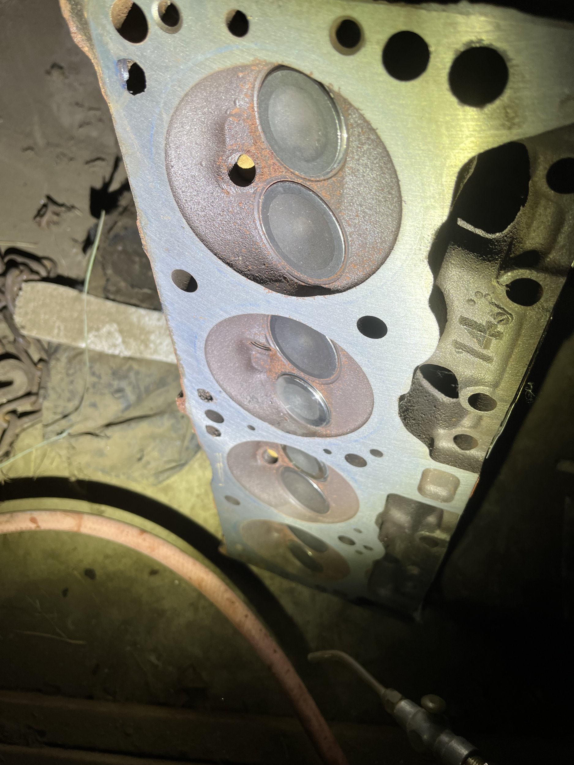

    lol. Here’s the CC pic.
    Will need some cleaning, had the intake sealed off, but never did the exhaust manifolds, , left them like the pipes were going on tomorrow. “Thule Fog surface rust”
    At first glance what appeared to be a surface, was the difference from chamber to plug hole. Easily seen now.

  12. Unkl Ian
    Joined: Mar 29, 2001
    Posts: 13,509
    Unkl Ian
    Can they be milled enough to fix this problem ?
    Budget36 likes this.

  16. Unkl Ian
    Posts: 13,509
    Unkl Ian
    Those chambers are horrible.
    Sharpone and Budget36 like this.
  17. Budget36
    Joined: Nov 29, 2014
    Posts: 15,334
    Budget36
    They will look a bit nicer, but won’t hold a candle to AFRs :)

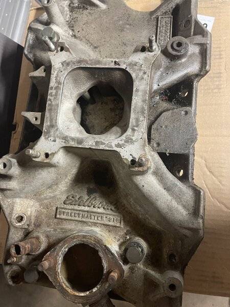

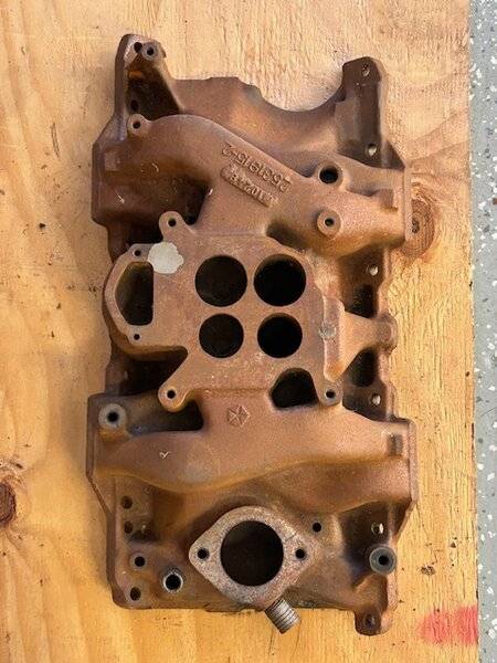

  25. Sharpone
    Joined: Jul 25, 2022
    Posts: 2,979
    Sharpone
    IMG_2832.jpeg IMG_2831.jpeg @Budget36 i believe you are looking for a 4 bbl manifold for your 318. I found a couple on For A bodies only for fair prices
    https://www.forabodiesonly.com/mopa...nes-casting-2531915-2-date-code-10248.573591/
    A factory 340 manifold
    And an aluminum Elderbrock
    https://www.forabodiesonly.com/mopar/threads/edlebrock-streetmaster-318-intake-manifold.573963/
    I have the Holley street dominator similar to the street master. These are good mild build manifolds that produce power from lower RPM up. I think the prices on either manifold is very fair.
    Dan

  27. 57 Fargo
    Joined: Jan 22, 2012
    Posts: 6,195
    57 Fargo
    I have a factory 340 intake on the 360 in my Fargo and a street master 318 on the 318 in my barracuda, both work well for my application. I wouldn’t run the street master on a serious 318 build
    I should add the street master is a single plane small runner intake, will not flow bunch at high rpm.

  30. Budget36
    Posts: 15,334
    Budget36
    I’m send the $$ for the StreetMaster today. Thanks @Sharpone !
