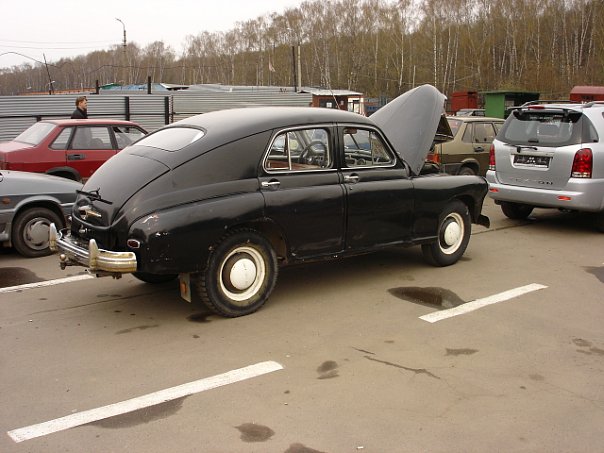

    little bit of history-GAZ20 is the first car that started to build in USSR after WW2 (builds from 1946 to 1956) and named "Pobeda" (Victory)
    that how it looks in original condition

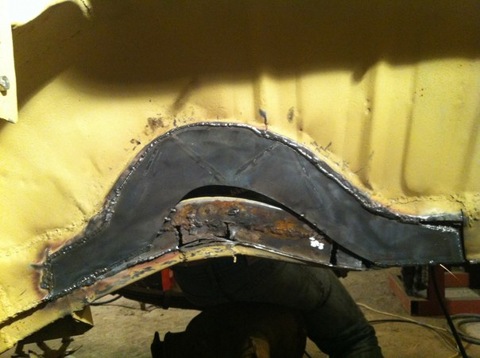

    so what we've done
    we check all sizes, to find an optimal lowering and save the proportions, because we must save an interiour & exteriour looks like original
    at first we build a 20cm dropped front spars
    but when we install it, we understand, that 20cm is too much
    and we build a new, 10cm dropped, front spars
  18. Looks like really capable metal forming, but, those ground down welds in the picture above would have me a little concerned. Most of them look OK, but, that stuff in the center looks concerning. Hope it's just an illusion in the picture.

    the "box" is welded from 4 parts

  22. Wow! That's impressive. Support from the inside. Very smart, my friend. :D
